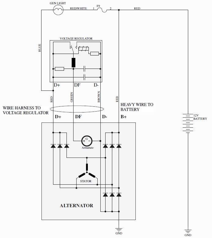

Re-reviving an old post. I would have liked to know that that part doesn't quite fit. It was nice that O'reilys can get the part within a day for just over 50$. But the tab offset is too short. So, I cut of it off. Now there's 14V at the battery. So maybe that's ok. The generator light is still on though.

QUOTE(stoneman30hotmail @ Sep 22 2023, 06:02 PM) *
@stoneman30hotmail
Good that you have 14V at the battery. What is the voltage at D+ to chassis? The voltage across the GEN light is the difference between D+ and battery (through fuse F9). If D+ is also 14V, then with engine off, pop out the guage with GEN light, start the car and measure both sides of the GEN light. They should be the same.

QUOTE(Spoke @ Sep 22 2023, 07:40 PM) *
@stoneman30hotmail
17V at D+! What's that mean?

QUOTE(stoneman30hotmail @ Sep 23 2023, 10:57 AM) *
@stoneman30hotmail
@stoneman30hotmail
Is this a new VR? D+ should be the same as the battery voltage. The VR uses DF to control the current in the armature of the alternator which in turn controls the voltage to the battery.
See the diagram below that the voltage generated at D+ by the stator should be identical to the voltage generated at B+ and thus the battery.
Check all 3 voltages at the VR connector WRT chassis, not the engine case.
D+ should equal battery voltage
DF should hover between 5V and 9V
D- should be zero volts.
If you have 17V at D+ and 14V at B+, then something is still amiss.

Now I'm thinking that maybe one or two of the diodes is bad. That would cause an imbalance between the D+ and B+. The light is probably trying to say that the last diodes will go at any time. Maybe wasn't the regulator after all?
