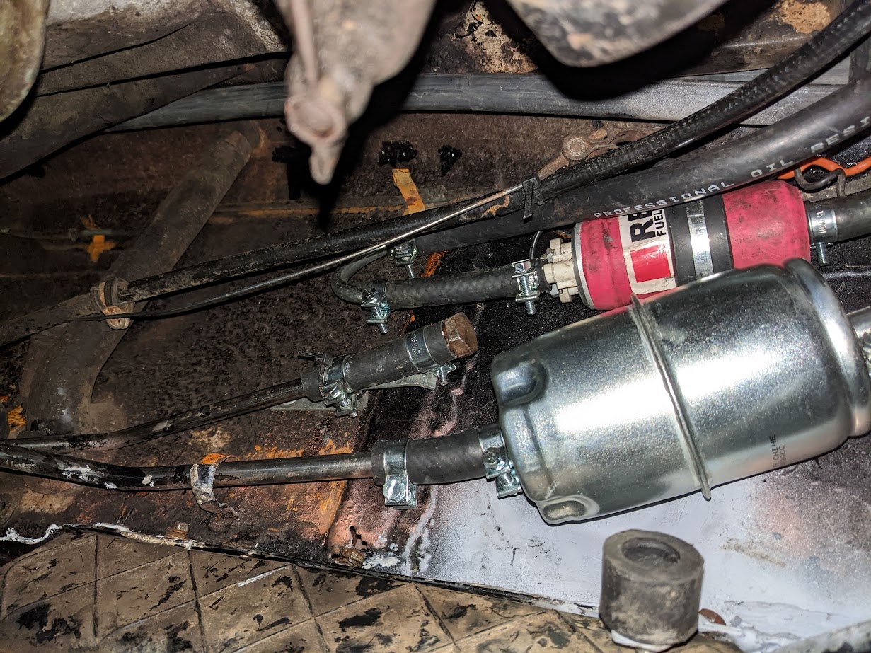

Does this pump have a prefered direction? https://www.carburetion.com/products/ProductDetails.aspx...
I can't find directions or indications on it. I'm not getting fuel, but don't know if it's this or the filter or the pressure regulator. It did get stuck when I had it before the filter but then I freed it by reversing polarity. Now I have the filter first. If I reverse polarity now I can hear bubbles in the fuel tank.

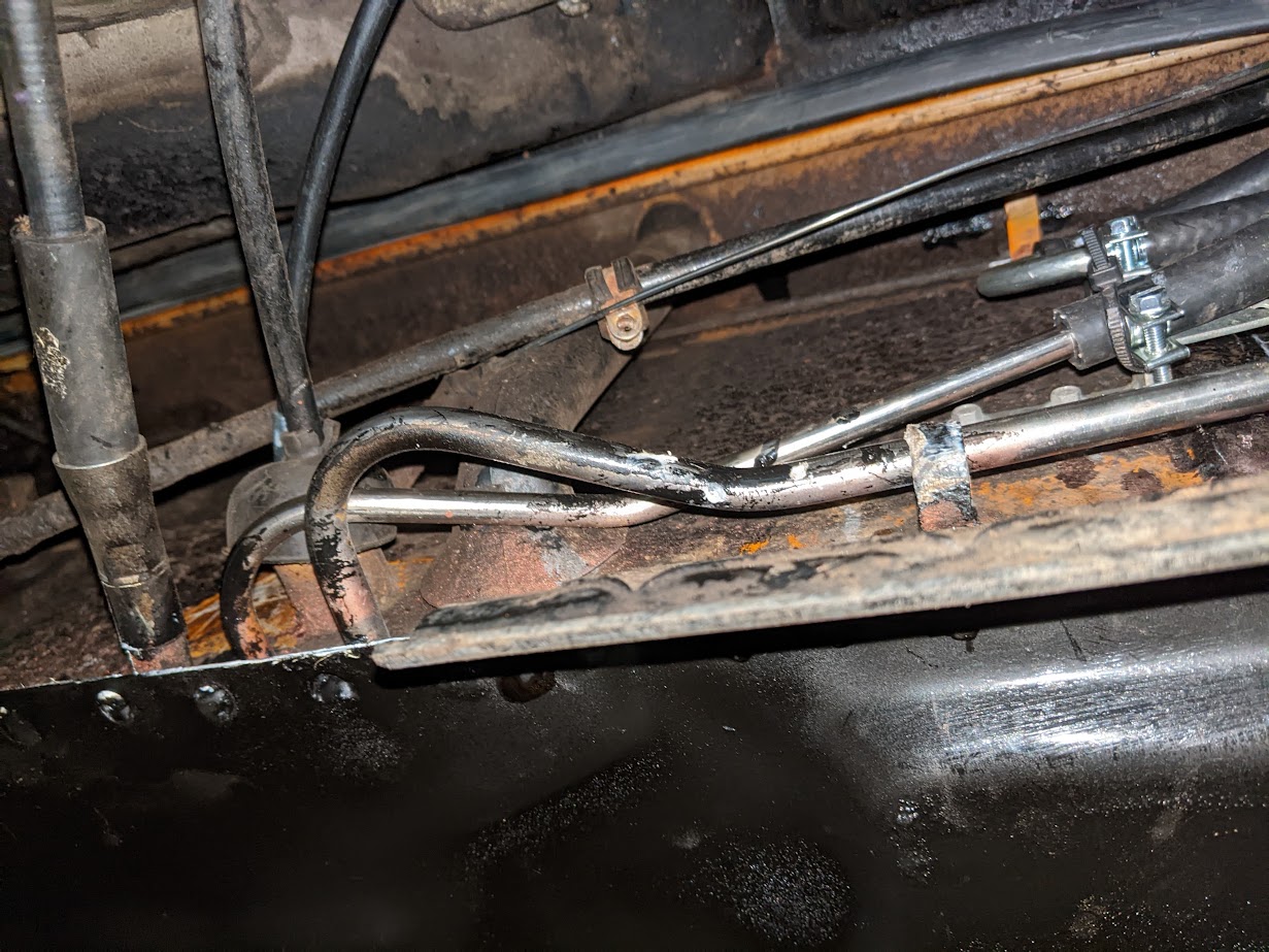

Heres a better picture of the bends. They're as they came.
Now with the right line as supply.
But it still doesn't work. A few tests run:
1. Disconnect large pipe - lots of fuel drop out. I probably let out 1/2 gallon in 15 seconds. So not the sock.
2. Disconnect line at carburator, run pump (key on) - pumps continuous (1/2 gallon fast) . So not a clog.
3. Idle engine - starts at 2 psi at gauge, stalls after 5-10 min, no pressure at fuel gauge, pump still buzzing
(after draining some fuel through system)
4. Leave pump to run, engine off, no flow - fuel pressure gauge shows 2 psi after regulator but pressure drop to 0 eventually (5-10min) pump still buzzing

rhodyguy   Post a picture of the pump mounted. Is hot air blo...   Oct 3 2023, 10:51 AM
stoneman30hotmail   It happened again after like a five mile drive. I...   Oct 3 2023, 11:16 AM
rhodyguy   Is it a dies while driving thing or no restart aft...   Oct 3 2023, 11:32 AM

rhodyguy   But the line runs from the fold to the filter inle...   Oct 3 2023, 12:43 PM
stoneman30hotmail   But the line runs from the fold to the filter inl...   Oct 3 2023, 01:03 PM
mate914   But the line runs from the fold to the filter in...   Oct 3 2023, 01:06 PM
rhodyguy   The in tank filter sock would be on the factory su...   Oct 3 2023, 12:52 PM
rhodyguy   The hardline link is for a set. Only one is on you...   Oct 3 2023, 01:16 PM
stoneman30hotmail   Ok, good tip, larger line is feed. :wacko: The...   Oct 3 2023, 02:01 PM
