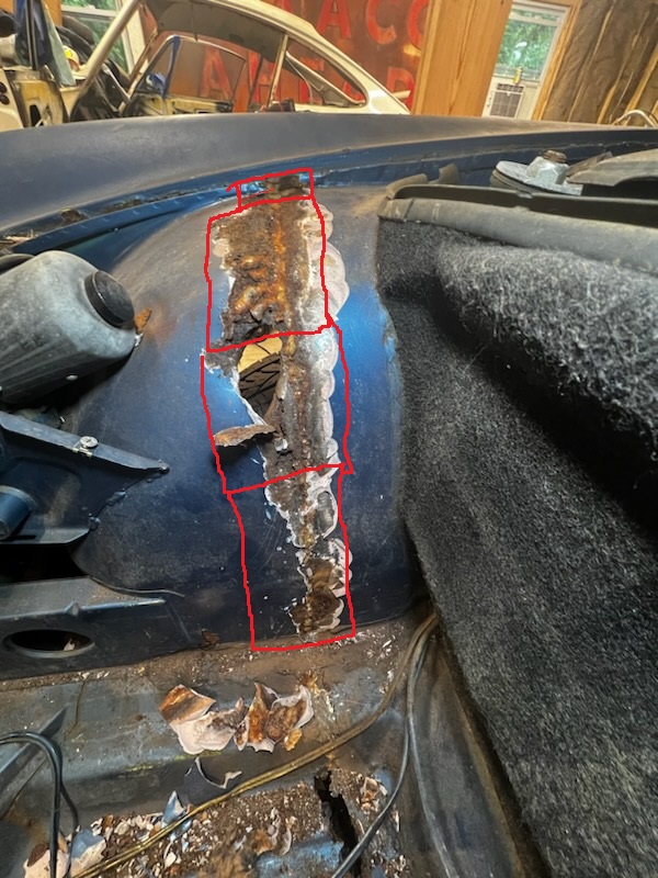

Yes, @sirandy . The car was clipped with a Ravenna green front in the 80's/90s. It's over-lapped and stick welded. Moisture has gotten a few inches into the over-lap.
It's been a topic of discussion between us how to sort this.
Since changing chassis isn't an option. I gotta fix it. Was planning to come to the hive mind here to figure out some ideas. Right now, it's fixturing it, cutting out the overlap until clean metal, 8" or 9"s at a time and welding in patches. Like this:
(IMG:http://www.914world.com/bbs2/uploads_offsite/i.imgur.com-23209-1698166081.1.jpg)
Thoughts?
Other option would be a Patch or a NEW clip. I could just as easily form whatever the patch shape would be and to to be frank, I don't want to mess with a new clip.

SirAndy   Looks like your car was clipped, those images are ...   Oct 24 2023, 10:24 AM

jaredmcginness   Yes, @[url=http://www.914world.com/bbs2/index.php...   Oct 24 2023, 10:48 AM
