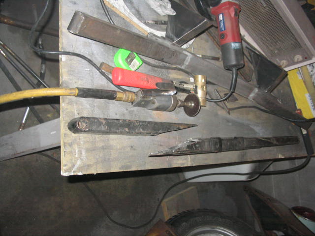

rick 918-S   I've been building a jig to make larry a cross...   Jan 29 2005, 12:59 AM
rick 918-S   number 2   Jan 29 2005, 01:00 AM
rick 918-S   number 3   Jan 29 2005, 01:00 AM
rick 918-S   number 4   Jan 29 2005, 01:01 AM
rick 918-S   I need to finish the mount in the morning. Me and ...   Jan 29 2005, 01:04 AM
rick 918-S   Finished up the cross bar   Jan 30 2005, 07:27 AM
rick 918-S   completed sitting next to mine. I test fit larry...   Jan 30 2005, 07:29 AM
