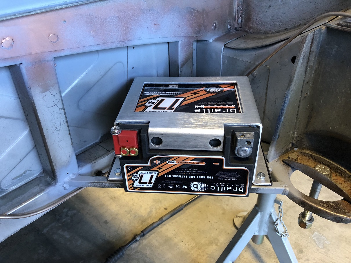

I'm running a Braille in my LS car. 17 lbs and 475 CCA. Very happy with its performance:
- It sat for over a year before I installed it. Put it on a Battery Tender to top it up and BOOM! Fired up the LS just fine.
- I accidentally left my ignition in the "on" position on when trailering home from WCR, plus a day or two before I unloaded. Totally drained it to ZERO. Put it on the Battery Tender and BOOM! Back to full function.
- Length (in.): 6.8 in., Width (in.): 4.0 in., Height (in.): 6.1 in.
- I'll likey go with the same thing in the 914 Ferrari build
- Buy on Summit Racing, $199 and free shipping to your door:
https://www.summitracing.com/parts/brl-b2317
- You can get a super cool, aluminum mounting frame, too. See pic.
They also offer an 11 lb/360 CCA, if that'd work for you.
In any case, Braille batteries: At The Red Barn approved! (IMG:style_emoticons/default/aktion035.gif)
