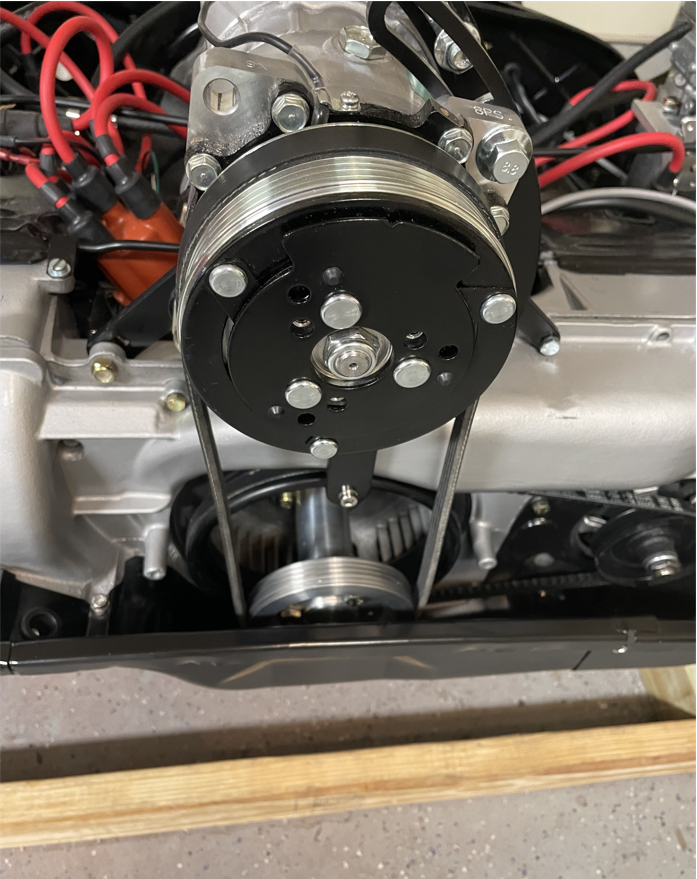

Here's a pic of my compressor set-up prior to install. This is a Sanden 508. The compressor mount is from Doug (dlee6204). I had a buddy with a lathe produce the stand-off pulley.
