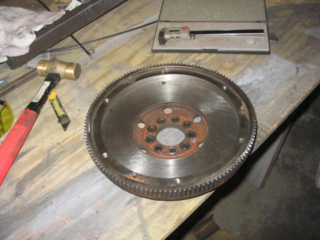

rick 918-S
post Jan 26 2005, 12:03 AM
Hey nice rack! -Celette
Posts: 21,065
From: Now in Superior WI
Member No.: 43
Here's your flywheel..

rick 918-S   Here's your flywheel..   Jan 26 2005, 12:03 AM
rick 918-S   I ground all the bolts to length and checked them ...   Jan 26 2005, 12:09 AM
