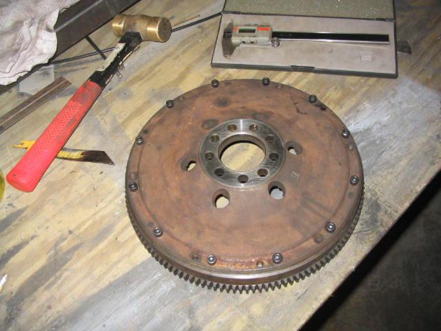

rick 918-S   Here's your flywheel..   Jan 26 2005, 12:03 AM
rick 918-S   I ground all the bolts to length and checked them ...   Jan 26 2005, 12:09 AM
