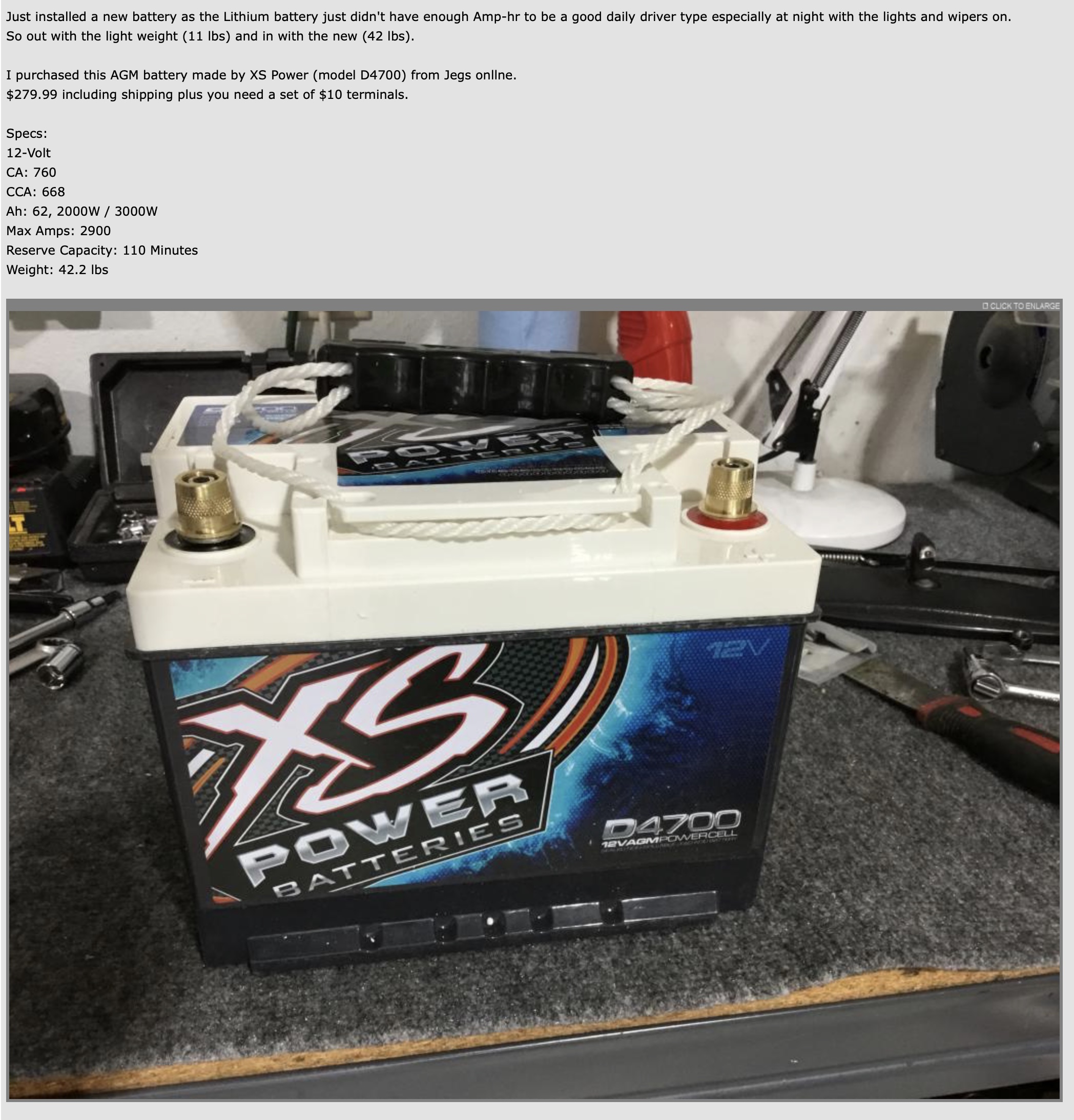

I went with this battery for my six conversion build.
It fits in the stock factory tray perfectly and has tons of power.
