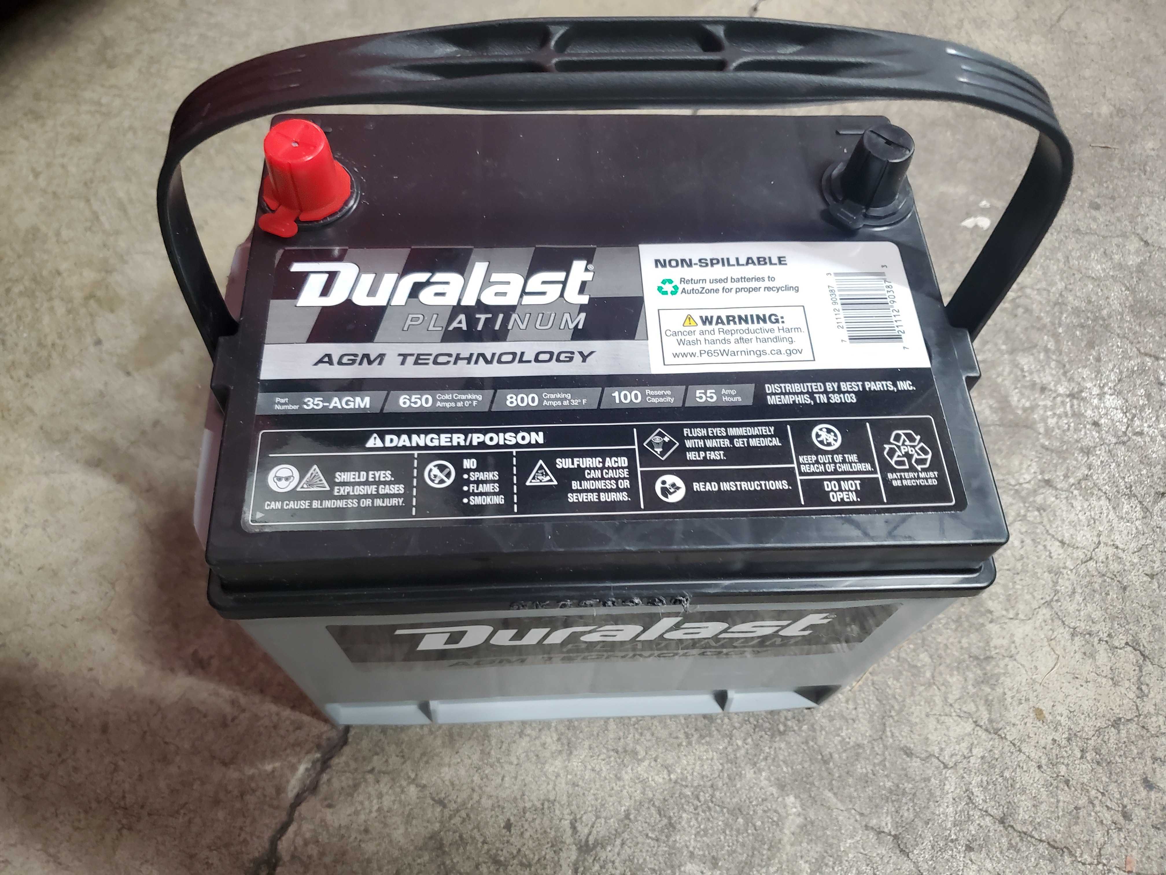

Thanks. Stopped at Autozone and picked up an AGM battery.
