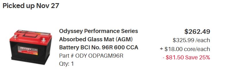

Napa Did not exclude batteries from Cyber Monday 25% off so picked this up.
plus earned another $10 off in rewards.
