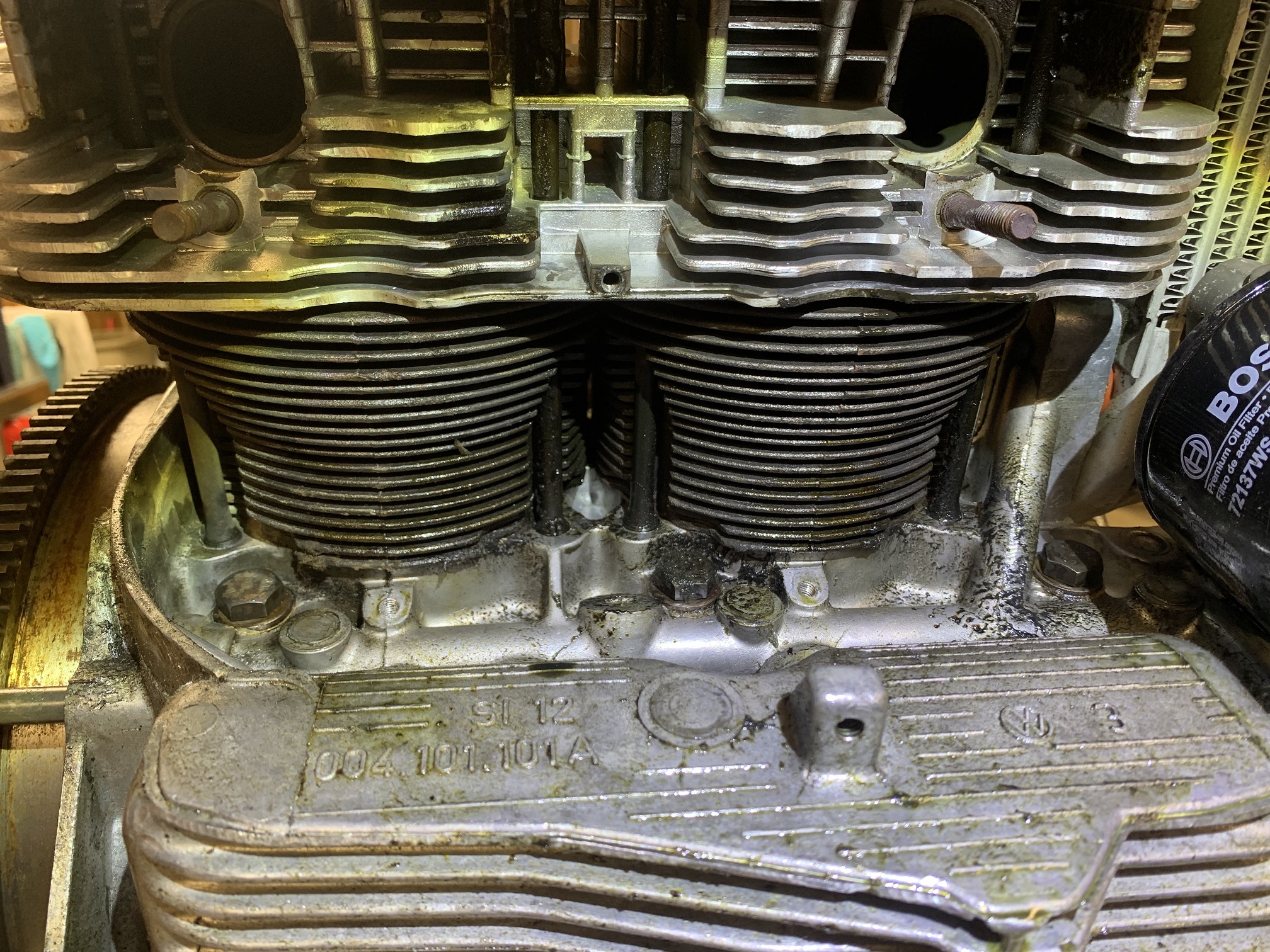

Still working on teardown, finding pretty much what I thought I would. I was expecting evidence of pushrod tube seal leakage, RMS leakage, and even oil pump gasket leakage, all fixable. In the pic below, I'm curious about the amount of oil on the base of the jugs where they get very friendly with the case. Also the amount of oil on the studs. This is above the inner pushrod tube seals, but it seems (to me) like I may be leaking at the base of the jugs? Which I would hate? Interestingly, and just to jinx myself, the oil cooler seals are nice and dry. There about 6K miles on this engine since complete rebuild.

Shivers   That is the rumor. My last T-4 build didn’t leak...   Nov 19 2023, 02:26 PM
914sgofast2   Jake Raby did a video about his frustration in fin...   Nov 19 2023, 02:43 PM
930cabman   My 2056 build has a couple smallish pushrod tubes ...   Nov 19 2023, 05:12 PM
Geezer914   I have a 26mm type 1 CB performance oil pump that ...   Nov 19 2023, 05:27 PM
JeffBowlsby   Jake also used to recommend plumbers pipe dope wit...   Nov 19 2023, 05:59 PM
Literati914   what about the spring loaded tubes, effective or n...   Nov 19 2023, 06:10 PM
Shivers   what about the spring loaded tubes, effective or ...   Nov 19 2023, 08:14 PM
AZBanks   what about the spring loaded tubes, effective or...   Nov 19 2023, 10:34 PM

barefoot   For push rod tube seals, I didn't use the gree...   Nov 20 2023, 07:57 AM
Geezer914   McMaster-Carr chemical resistant viton fluoroelast...   Nov 20 2023, 08:04 AM
sdoolin   McMaster-Carr chemical resistant viton fluoroelas...   Nov 20 2023, 09:10 AM
VaccaRabite   I always fight with pushrod tube seals. You have ...   Nov 20 2023, 08:59 AM
sdoolin   Thanks for all replies... I have tried to find th...   Nov 20 2023, 09:48 AM
Geezer914   Thanks for all replies... I have tried to find t...   Nov 20 2023, 10:44 AM
FlacaProductions   Nice: Here's the direct links - 212: https://...   Nov 20 2023, 10:57 AM
Geezer914   I had a pair of cast aluminium valve covers and it...   Nov 20 2023, 11:36 AM
technicalninja   Took a bit to find the x shaped viton rings. this...   Nov 20 2023, 12:11 PM

technicalninja   Jake Raby did a video about his frustration in fi...   Nov 20 2023, 12:48 PM
Jack Standz   The silicone valve cover gaskets Aircooled.Net use...   Nov 20 2023, 12:59 PM
sdoolin   The silicone valve cover gaskets Aircooled.Net us...   Nov 20 2023, 01:07 PM

VaccaRabite   Regular valve covers work fine. You don't nee...   Nov 20 2023, 01:43 PM
ctc911ctc   '74 2.0, 28k miles I tried to tighten the lea...   Nov 20 2023, 02:39 PM
Geezer914   Second that, Permatex Hi Tac gasket cement on the ...   Nov 20 2023, 03:02 PM
FlacaProductions   The VW logo on the cover goes UPSIDE DOWN when the...   Nov 20 2023, 03:37 PM
bkrantz   The truly leak-free type 4 engine might be a fanta...   Nov 20 2023, 08:53 PM
