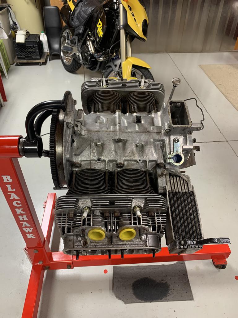

Rebuilt my 2.0 back in 2016. Full "Raby Spec" 2056. Runs very well. It is out of the car right now as I am dealing with a rusty battery tray (separate thread on that). It appears that I have leaks at most/all of the pushrod tube seals, the valve cover seals, and the rear main seal. This is not a surprise to me, I clean the bottom of the engine regularly, and knew this day was coming
Pretty sure I used the Victor Reinz gasket set that came with my engine "kit" from the Type IV Store. I used the cork valve cover seals from the Victor Reinz set. I did not use any RTV anywhere. Hate the stuff. I know I used a rear main seal from GoWesty as someone back then had suggested it is a better part then what is included with the Victor Reinz set.
I installed new pushrod tubes and used the O-Rings from the Victor Reinz set.
Does anyone really have an oil tight VW Type IV engine? If yes, how does none do that?

Spent all day cleaning. Have a pretty good contact cleaner & bourbon buzz. Waiting for new pushrod tubes and various gaskets. I have questions about phenolic spacers and exhaust bolts...
