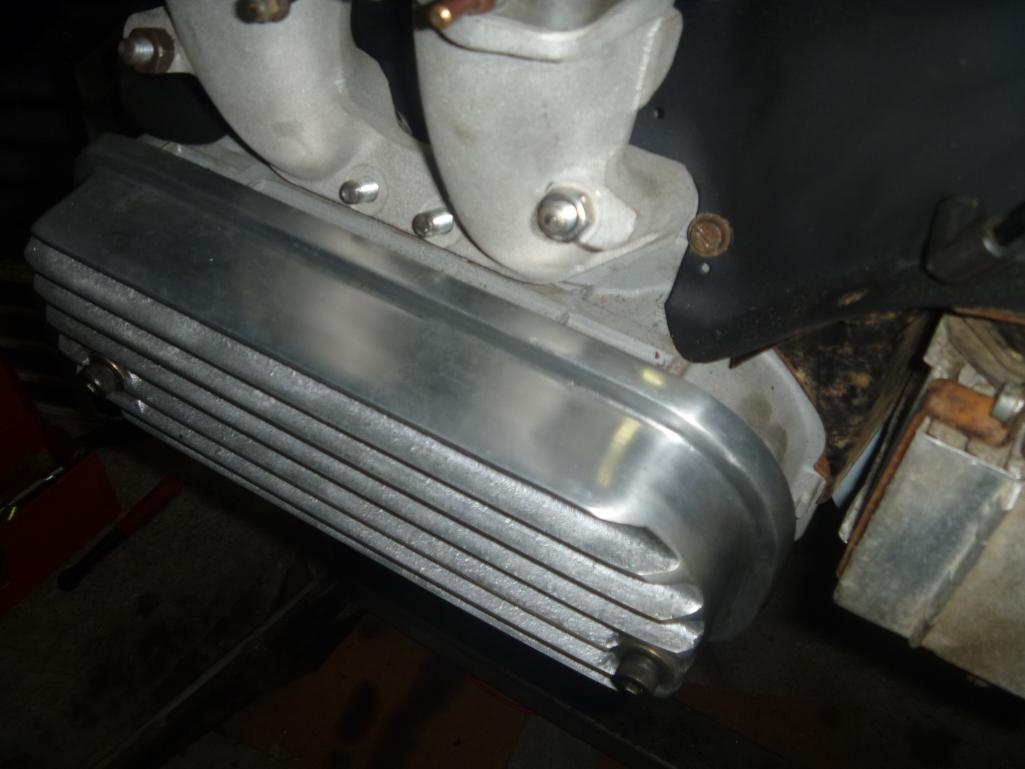

sdoolin   I finally received the CB Performance bolt on valv...   Jan 2 2024, 01:48 PM
Jack Standz   Available for approximately $20 to $25 f...   Jan 2 2024, 02:35 PM

sdoolin   Thanks for the compliments in the cleanliness. But...   Mar 30 2024, 07:52 AM
technicalninja   Post a pic of your leak point please. Really stra...   Mar 30 2024, 08:39 AM
technicalninja   You're going to need a mirror with all the stu...   Mar 30 2024, 08:52 AM
sdoolin   Pic below. Hard to get a good picture but you can ...   Mar 30 2024, 09:27 AM
technicalninja   I'd first clean all the oil with B12 carb spra...   Mar 30 2024, 10:05 AM
technicalninja   You're running carbs... My 75 came with a bra...   Mar 30 2024, 10:42 AM
