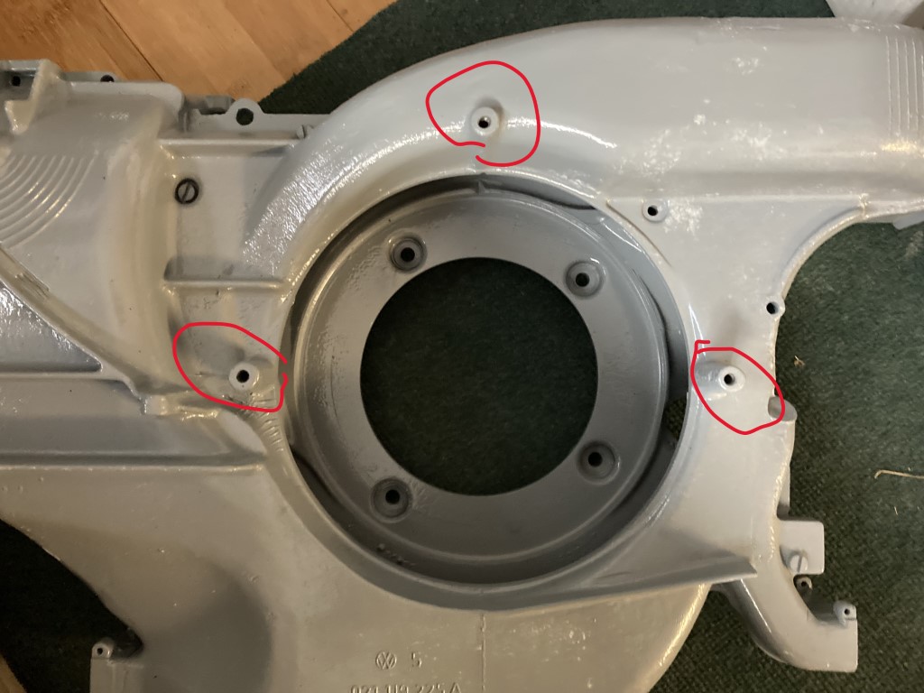

QUOTE(DC_neun_vierzehn @ Dec 6 2023, 07:36 AM) *
Thanks. I’ll feel around back there for the mounting bosses. I assume I will not have to drop the motor to install the screen?
Nope. You can reach right down there to install it easily. "Mom's Service Cover" makes it even easier. (IMG:style_emoticons/default/smile.gif)

DC_neun_vierzehn   How did you mount the screen to the shroud? Thre...   Dec 6 2023, 06:36 AM
