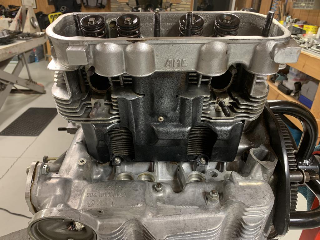

Rebuilt my 2.0 back in 2016. Full "Raby Spec" 2056. Runs very well. It is out of the car right now as I am dealing with a rusty battery tray (separate thread on that). It appears that I have leaks at most/all of the pushrod tube seals, the valve cover seals, and the rear main seal. This is not a surprise to me, I clean the bottom of the engine regularly, and knew this day was coming
Pretty sure I used the Victor Reinz gasket set that came with my engine "kit" from the Type IV Store. I used the cork valve cover seals from the Victor Reinz set. I did not use any RTV anywhere. Hate the stuff. I know I used a rear main seal from GoWesty as someone back then had suggested it is a better part then what is included with the Victor Reinz set.
I installed new pushrod tubes and used the O-Rings from the Victor Reinz set.
Does anyone really have an oil tight VW Type IV engine? If yes, how does none do that?

More cleaning, inspection, and beginning of re-assembly. Fascinating the amount of grime accumulated in 6 yrs and 6K miles with what I kept telling myself were "minor oil leaks"....

sdoolin   I have ordered new pushrod tubes from TIVStore, ha...   Dec 1 2023, 06:19 PM
Geezer914   DuPont Moly coat 55 O ring grease!   Dec 2 2023, 07:19 AM
sdoolin   DuPont Moly coat 55 O ring grease! I have a...   Dec 2 2023, 06:34 PM

sdoolin   Spent all day cleaning. Have a pretty good contact...   Dec 2 2023, 06:42 PM
Geezer914   Did you install the engine with these covers? I h...   Dec 3 2023, 08:54 AM
sdoolin   Thinking about phenolic spacers, the spacers betwe...   Dec 4 2023, 09:24 AM
