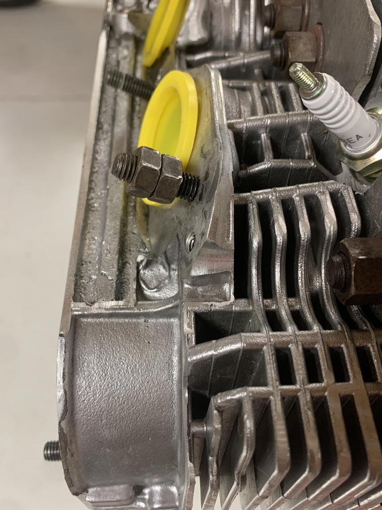

Attempts to remove existing intake studs have failed miserably. These are HAM heads, are 6 yrs old, and have about 6K miles on them. I have (of course) tried penetrating oil, and heat, all to no avail and I'm afraid I will pull the threads out of the heads. I am using the "double nut" method (pic below) and I get no movement on the stud.
Is there a special tool that I need to add to my collection of rarely used but significantly useful tools?

sdoolin   Attempts to remove existing intake studs have fail...   Dec 9 2023, 10:17 AM
Superhawk996   Collet style stud install and removal tools specif...   Dec 9 2023, 12:20 PM
sdoolin   Thank you Superhawk996 - which reminds of two diff...   Dec 9 2023, 01:43 PM
