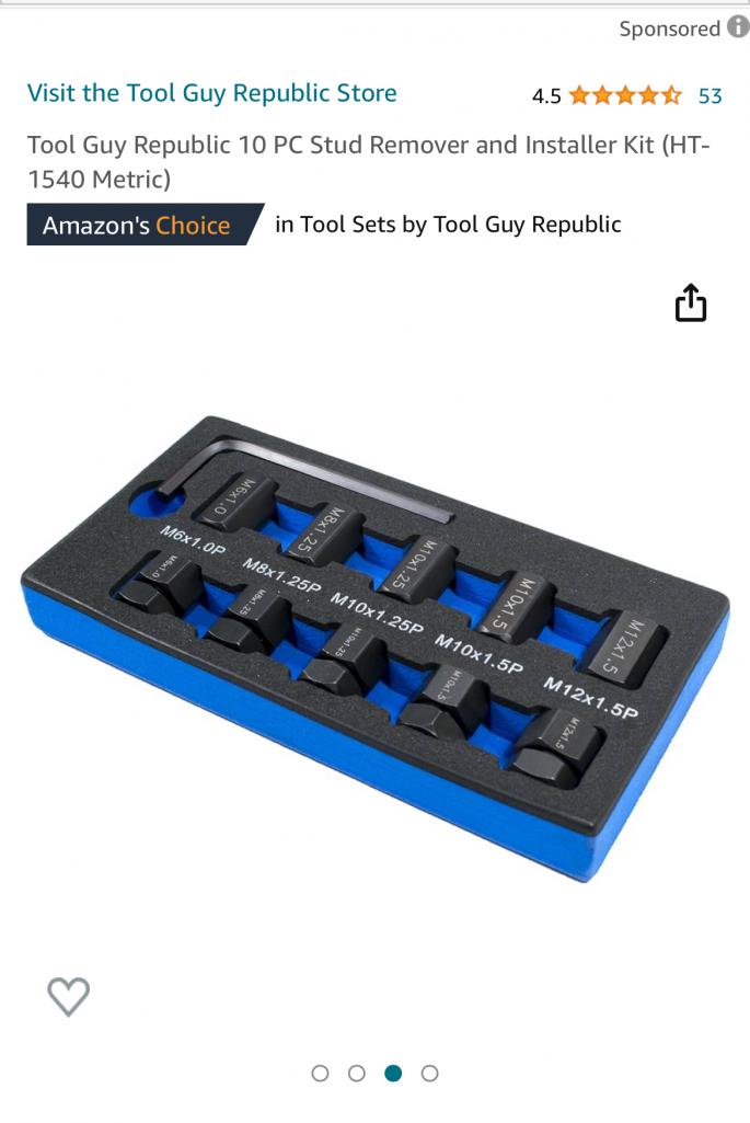

Collet style stud install and removal tools specific to size and thread pitch are the best tool that will not damage threads.
I’ve never had intake studs break when being removed. My guess is they used some Loctite - need more heat! Aluminum is a great
Thermal conductor and moves heat away quickly. Plus the head and fins are helping to radiate the heat away and out of the head. You’ll need a lot of heat - like Oxy-Acetylene or the propane / MAPP gas for a while.
Heat the head around the stud - avoiding the stud or wrap stud with wet cloth to keep it cool. You want the aluminum to expand - not the stud.
These appear to be knockoff of Snap-on / Matco set I’ve used for about 1/3 the price

sdoolin   Attempts to remove existing intake studs have fail...   Dec 9 2023, 10:17 AM
Superhawk996   Collet style stud install and removal tools specif...   Dec 9 2023, 12:20 PM
sdoolin   Thank you Superhawk996 - which reminds of two diff...   Dec 9 2023, 01:43 PM
