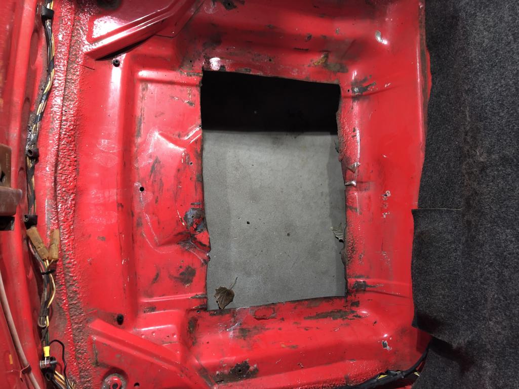

I have to weld in a new front trunk pan replacing the hole left from an AC unit. I have taken two MIG classes. Beside being a newbie, I have other limitations to consider.
I don’t have access to a 220 line.
I’m inexperienced.
It would cost me $1000 to have it professionally done. And I don’t want to buy a bunch of equipment for one job.
Can I use a flux welder? There a couple cheap units at Harbor Freight (under $150) on sale right now. What don’t I know that I should know?
Thanks (IMG:style_emoticons/default/welder.gif)

After much deliberation and searching, I found the best option for my situation—a friend with a welder AND a garage to work on it.
I have another question for this group since you were all so helpful. Should I butt weld or lap weld the new floor pan in? I'm thinking lap weld. I don't want to weld from the bottom. I don't have access to a lift, and I'm not going to be able to weld on my back. I'm too old for that.

I've butt welded a bunch of small panels on the floor of my 914 w/o going under the car. All done from the top.

With a TIG?
