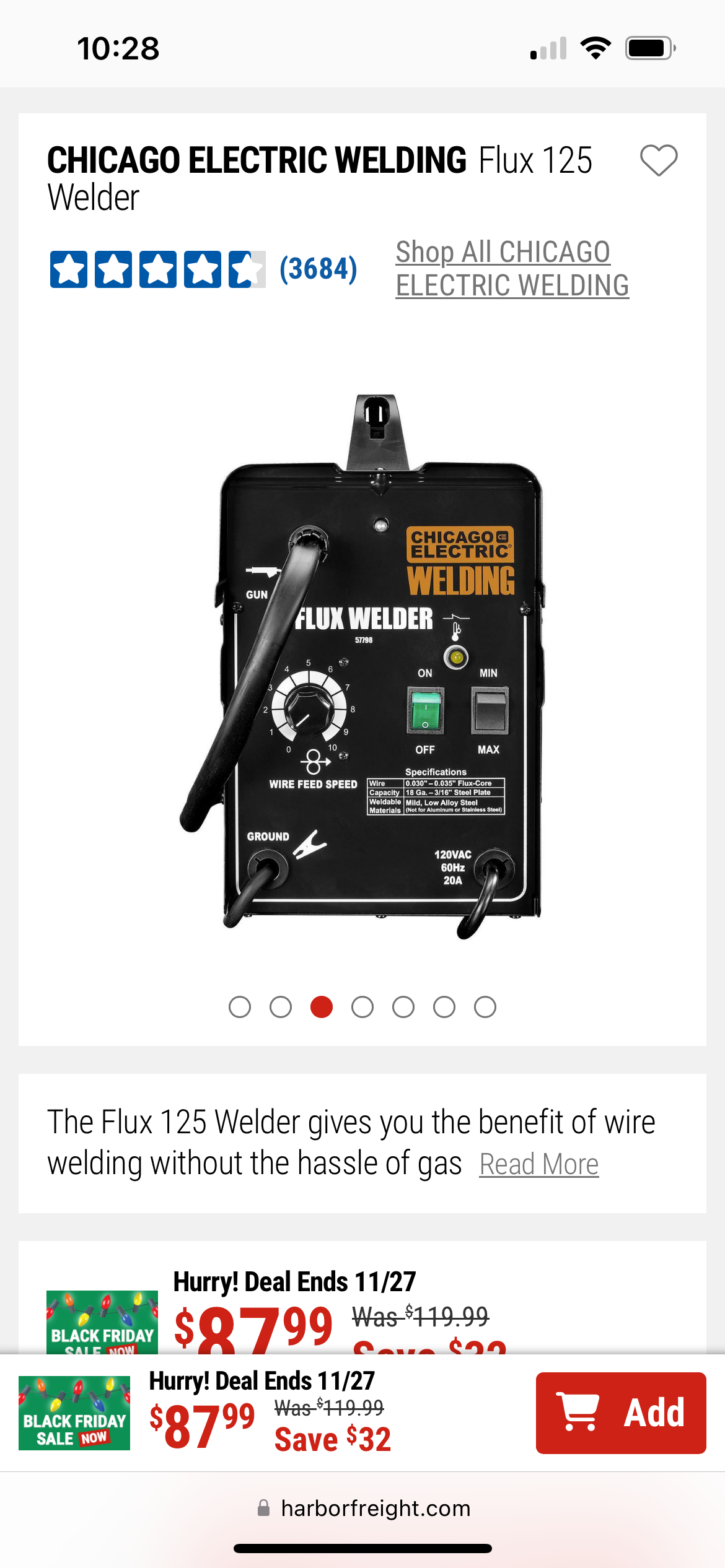

Can I use a flux welder? There a couple cheap units at Harbor Freight (under $150) on sale right now. What don’t I know that I should know?

Should you use a cheap sub $150 HF flux core unit? No.
Why or why not?
Flux core spatter is going to be a mess and will be a PITA to clean up all the splatter.
The cheaper the unit, the harder it is to get a decent weld. Cheap units tend to have limited control over welding current and wire speed. They also tend to have issues with the wire feed mechanism that results in wire slippage or worse yet, jamming and birds’ nesting. Can be very frustrating.
I’d bet with a little searching, you can find a nice used 120v Hobart Handler or Lincoln weld pack 140 in the $250-350 range. As stated by Ian, the ability to use shielding gas is a huge upgrade and even if you choose not to use gas right now, it’s huge as your skills progress.
Bottom line: the cheaper the welder may impair your learning and is more likely to frustrate you.

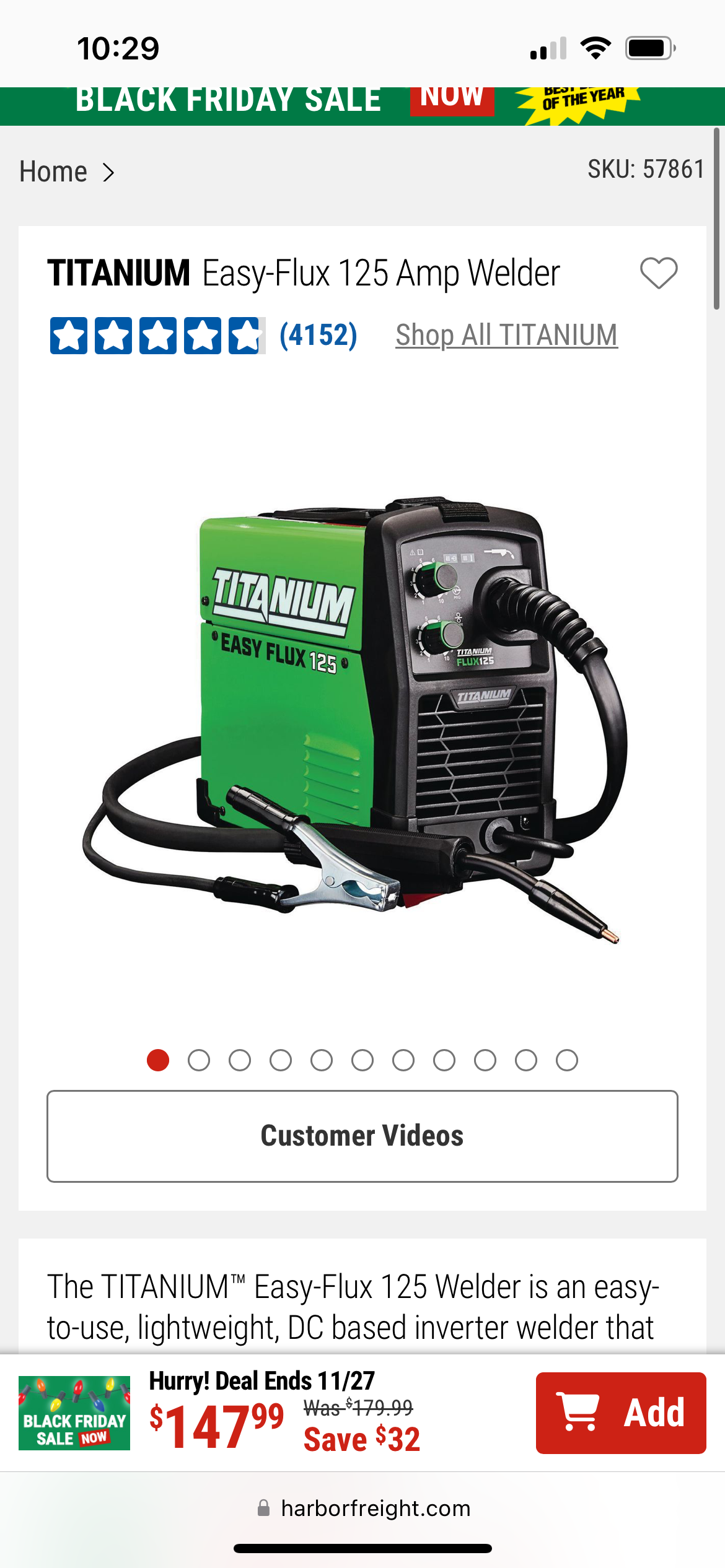

Looked up what is on sale
Definately don’t get this one. Only current control is a single min/max switch.
This one at least has variable wire speed and variable current controls. Duty cycle is pretty low at 30% @ 90A but would work in a pinch.
Looks like a smaller inverter type unit - meaning no big heavy transformer but slightly more fragile. This has complicated power electronics, and if anything fails, it is a throwaway unit.
Still would recommend a better used unit that can support shielding gas but wanted to see what was being offered by HF.

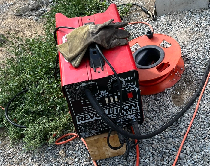

Bought this one used almost 30 years ago for about $100.
I don’t use it much (moved on to TIG) but it still works. This one is pretty low end with two switches that only allow 4 current levels. Very basic but came with hoses and regulator and it can use shielding gas which was a decent enough machine to get me started way back when.

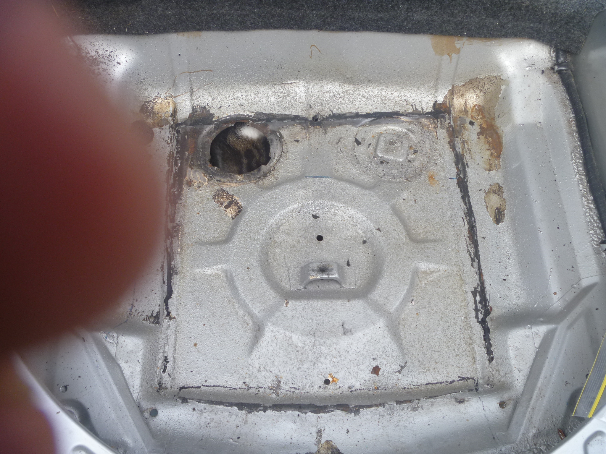

I know it can be challenging, but can you post a picture of the project? Maybe it's something that a panel can be made and patched over with rivets?
If it does require complete replacement, you could remove it, prep and fit the new panel with sheet metal screw or clecos, then rent a machine or hire welder to compete the job. I would think a half day rental would be pretty affordable and enough time if it was prepared properly.

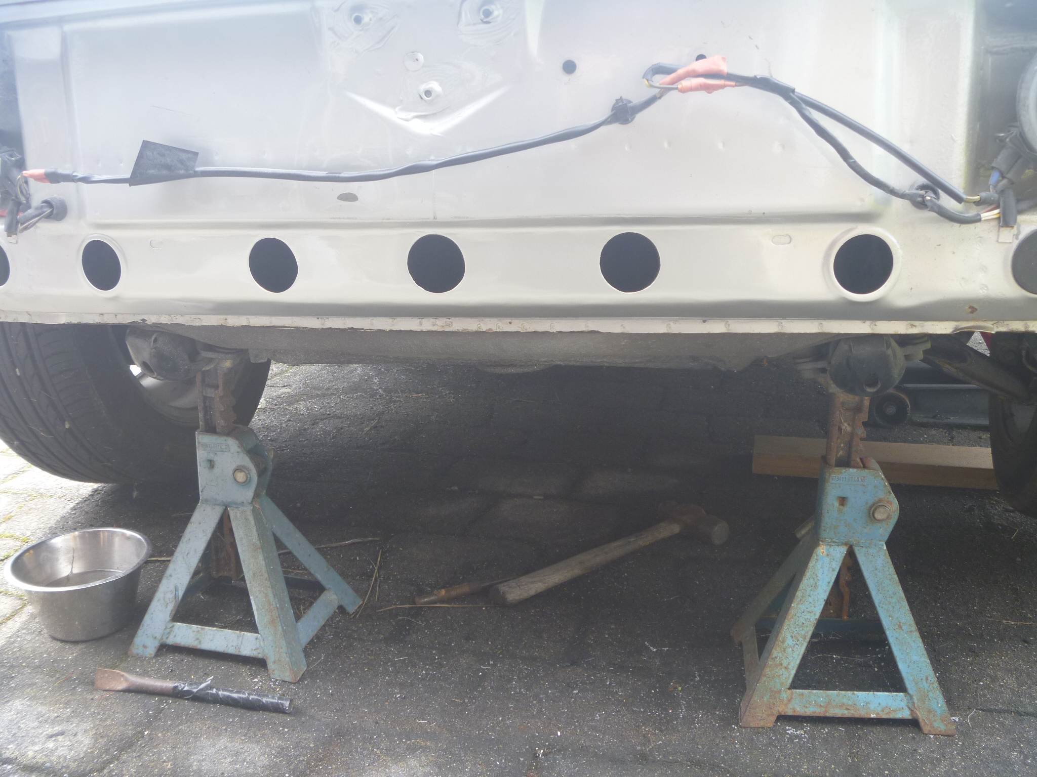

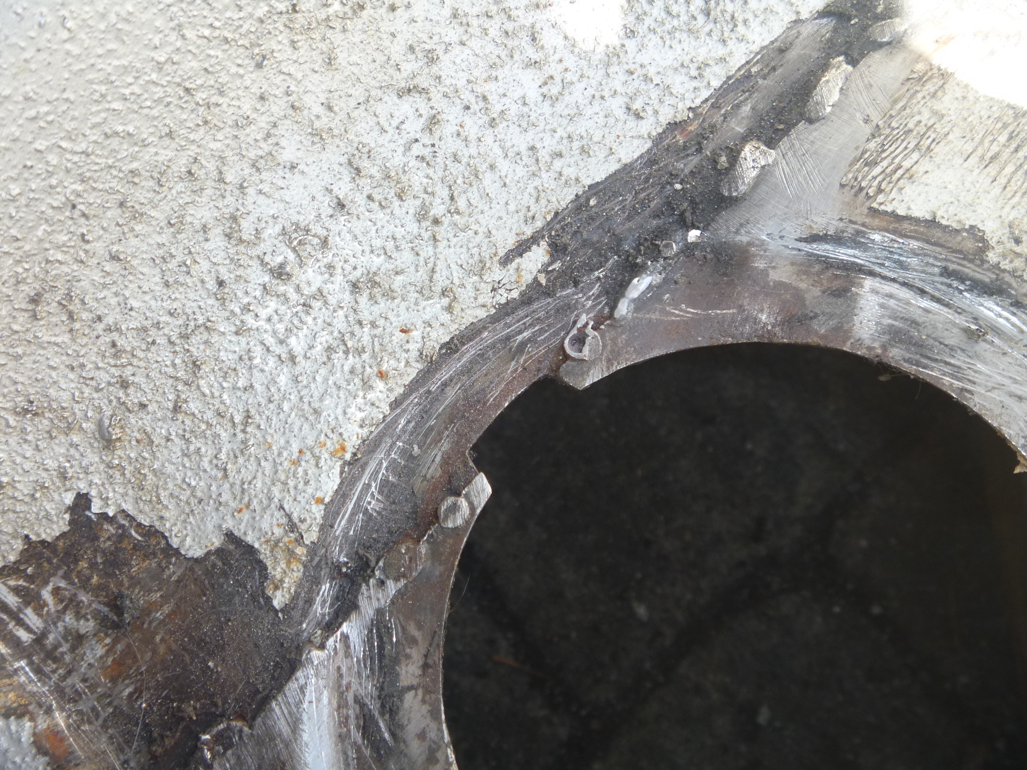

agree.gif ,also the shape of area is a problem already , if repair panel isn't butt welded it's never going to fit properly if lapped the overlay will cause gaps ,its not you can just dolly them down due to all the curves.
Rust is a certainty and just a matter of time and it will look ugly ....ask me how I know all this ?? ,PO did this after welding up a patch to cover the hole for a cooler ,too much heat and not enough tacks ,the patch has also buckled upwards as no gap as there would be with butt weld .
I'am faced with trying to fix this as I can't bring myself to cut it out but may have to ,have scrapped all the sealer out there is rust.
It looks much worse that the photos trust me on that headbang.gif .
@porschetub
Try a shrinking wheel on it to remove the buckling / oil-can effect.

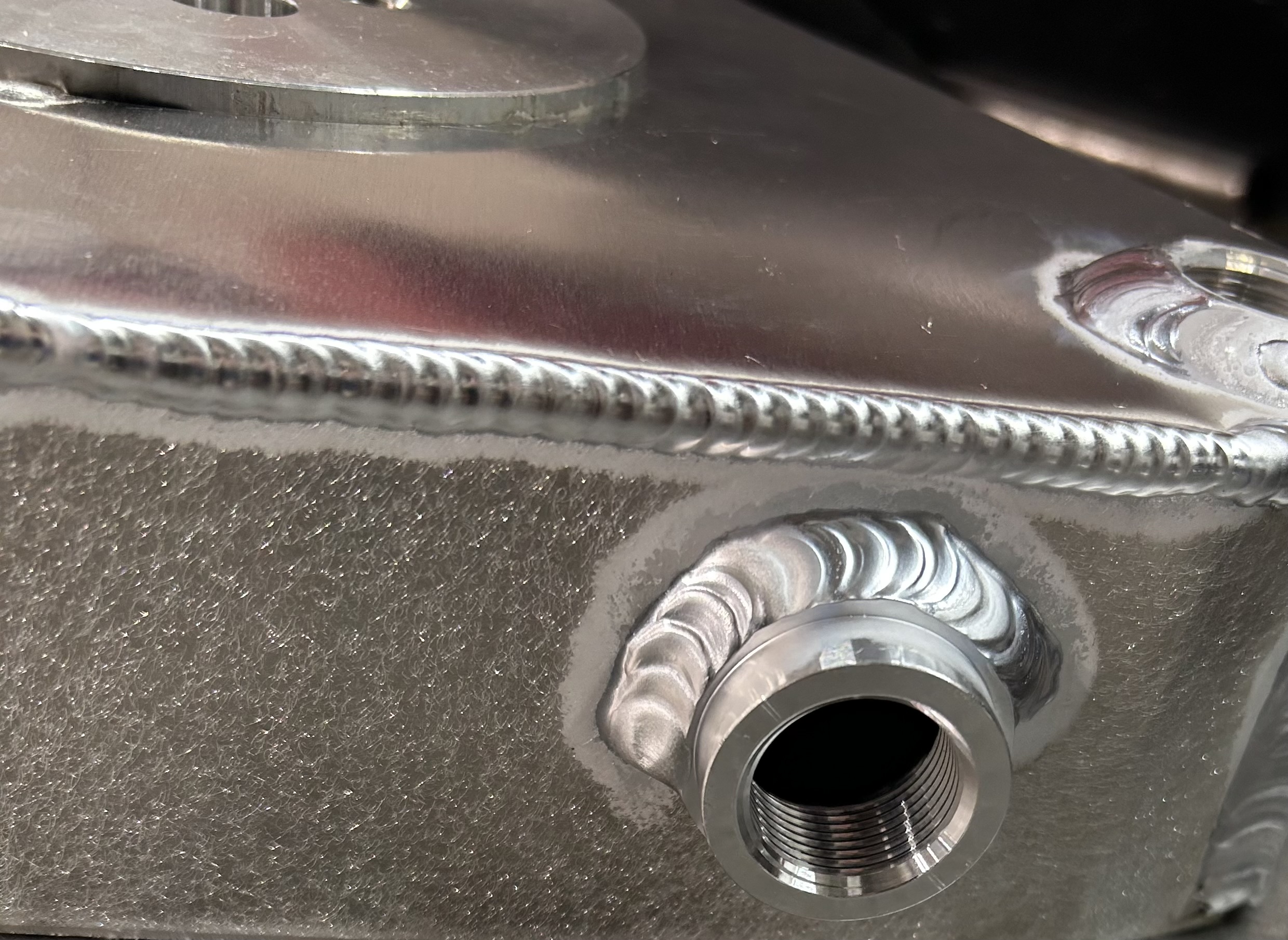

Ok I have to pipe up a little bit here as I do this for a living.
A: no lap joint is acceptable on a 1/4, floor pan or any where where moisture can get trapped. The floor pan is a lap joint onto the longs and look what happened from the factory
B: flux core is a good solution for many welding applications. NR211 is used as a normal construction filler within the Iron workers on the west coast for structural. That said they are using high end power sources to achieve high quality earthquake code welds.
C: patch panels in a floor are completely acceptable for CSOBs and I have done that before myself but ultimately it takes more time
D: MIG or proper term in the US would be GMAW or MAG in Europe requires the least skill for the average car person. GTAW is way harder to do correctly but requires much less grinding and blending
E: to control warping and oil canning just use small tacks and skip all around. Also use your hand with a glove on to absorb some of the heat from the weld area (HAZ) using a wiping motion. You can also use a damp rag or air nozzle for sheet metal repairs. This should never be done on a structural weld(only let air cool )

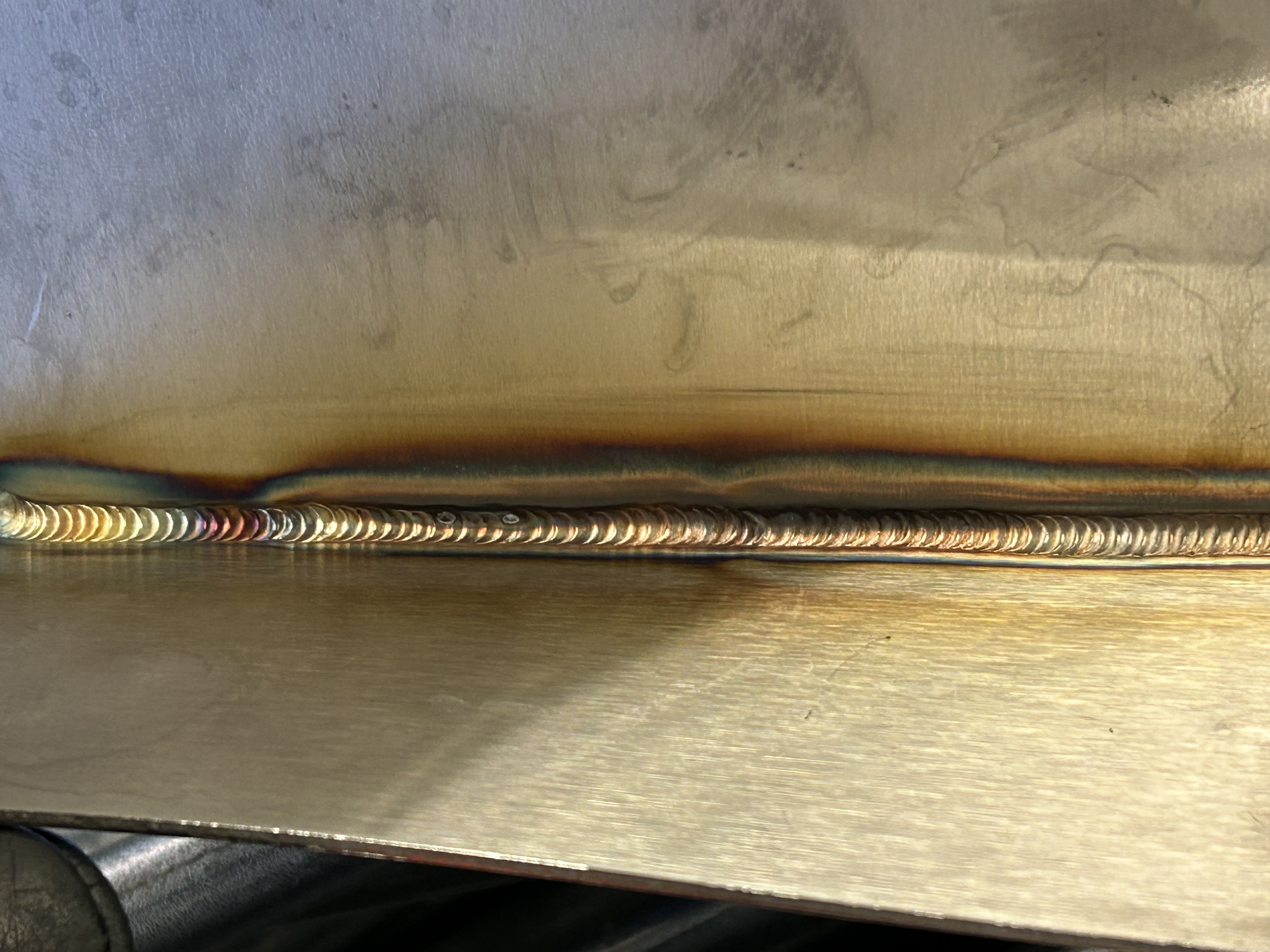

Here is a demo weld I did the other day for a reference weld for you TIG weldersClick to view attachment
mb911
Nothing short of artwork, thanks for posting.
How many years have you been at it? Many I am sure
Another vote for butt welding, and you can doing it from the top (inside).
You might get away with a lap weld, but only if you weld on the side most exposed to weather/water. That means from below.

Use magnets to hold the but joint tight until it’s tacked in.
QUOTE(mb911 @ Dec 13 2023, 03:56 PM) *
QUOTE(Deusexmachina77 @ Dec 13 2023, 02:49 PM) *
@mb911 That TIG weld is a thing of beauty. I only have access to a MIG welder and am not skilled enough to lay down beads like that.
Re-reading my follow-up post, the litany of not wanting to weld from the bottom was about the lap weld. I thought I would have to do the top and the bottom.
I have a pretty good mess to clean up first, so I'll see how I do with all that work first. And then I'll decide how comfortable I am with the butt weld. I usually have to do things twice. Something tells me I'll be paying a professional–eventually.
Thank you everyone for your thoughts. It is a constructive discussion. I've learned a lot. smilie_pokal.gif
And make sure metal on both sides of the butt is solid and clean. Thin, dirty, and/or rusty metal edges will instantly burn through.

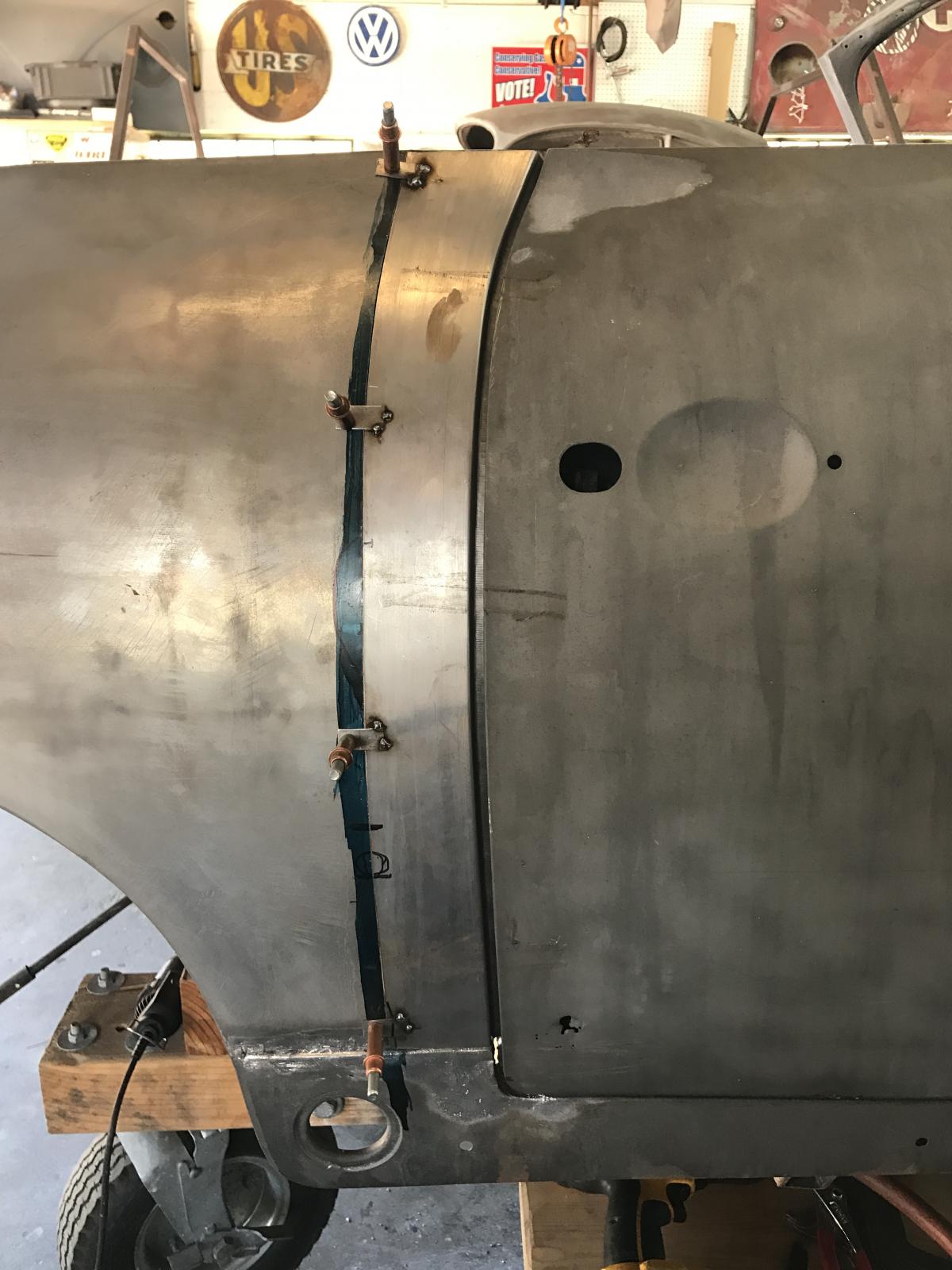

Here's an alternative method for fitting and holding panels. I cut a bunch of these little tabs, punch an 1/8" hole for a cleco, tack to either side of the panels your joining.
IPB Image
Regarding butt vs. lap welding; My suggestion to lap was based solely on the OP's lack of experience. The most skilled part of this job is the welding, the rest of the job is patience and the grunt work of putting the panel in and out to obtain a good fit. With enough fitting, the panel could be made to fit like a glove, then rosette welded with proper surface preparation. Is it the best way? Let's just say it isn't how I would do it, but fitting a panel with little to no gaps is a skill that needs to be developed as well.
Considering that EVERY joined panel on your Porsche is a lap weld, I think it's a viable option. In fact, the only butt welded panels I can think of on a Porsche would be 356 outer panels, and you would never want to weld those with a MIG because you wouldn't be able to metal finish it.IPB Image
Good luck!
