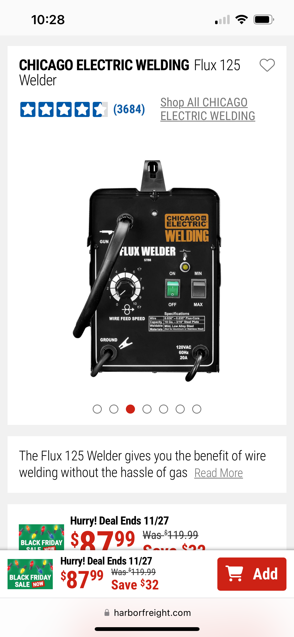

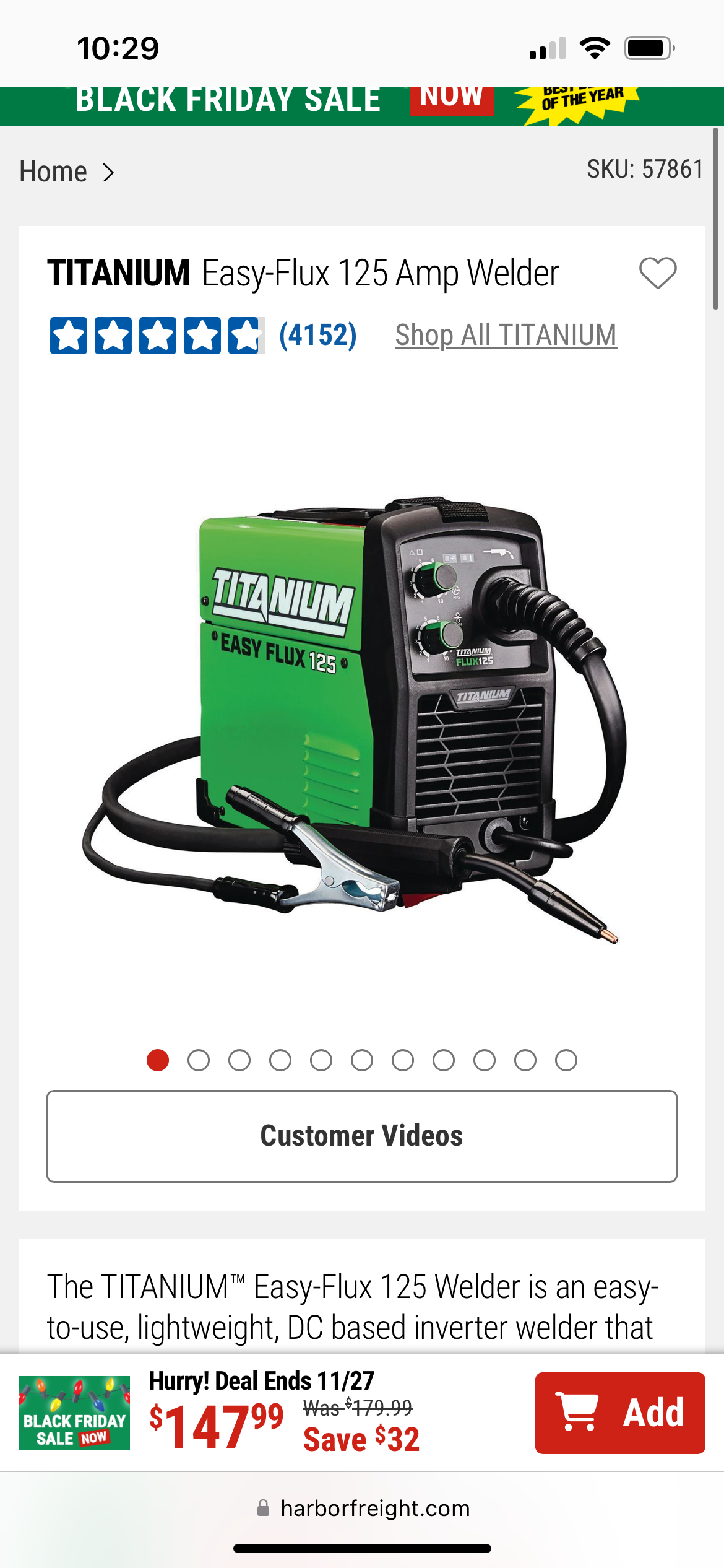

Looked up what is on sale
Definately don’t get this one. Only current control is a single min/max switch.
This one at least has variable wire speed and variable current controls. Duty cycle is pretty low at 30% @ 90A but would work in a pinch.
Looks like a smaller inverter type unit - meaning no big heavy transformer but slightly more fragile. This has complicated power electronics, and if anything fails, it is a throwaway unit.
Still would recommend a better used unit that can support shielding gas but wanted to see what was being offered by HF.

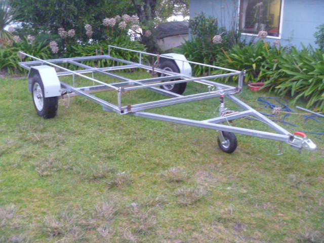

Seems to be all about wire and feed control which my 2 yr old BOC Smootharc 180 240V has in spades ,I went from new machine and built a farm hay trailer that was framed in 6mm wall thickness box section galv-coated , I was on co2 gas the welding was so easy it was fun, vertical welds were so simple .

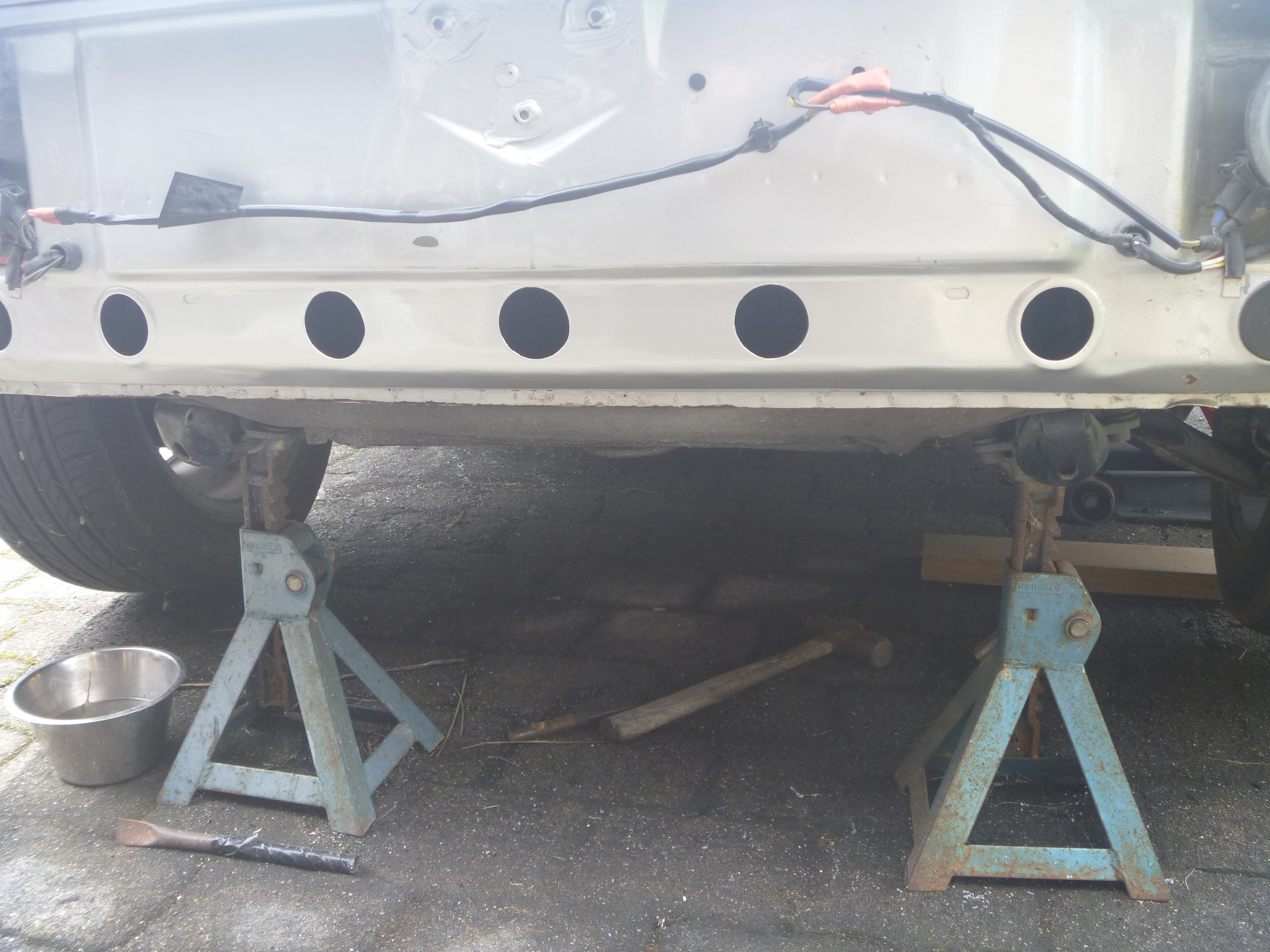

Fairly recently closed up the front panel OP had been cut for a cooler ,had no gas left so changed to flux wire and did some test welds after changing settings for 1mm thickness panel steel , my welding experience is pretty extensive but don't have a lot of time with panel steel , this machine made me look like a real "star" TBH.
To me welding is like painting ...its all in the prep , correct gaps,clean surfaces ,correct feed and current ,good helmet and gloves and you get a decent result IMO.
If you are a bit short of cash buy a half decent one then on sell when you are done .
