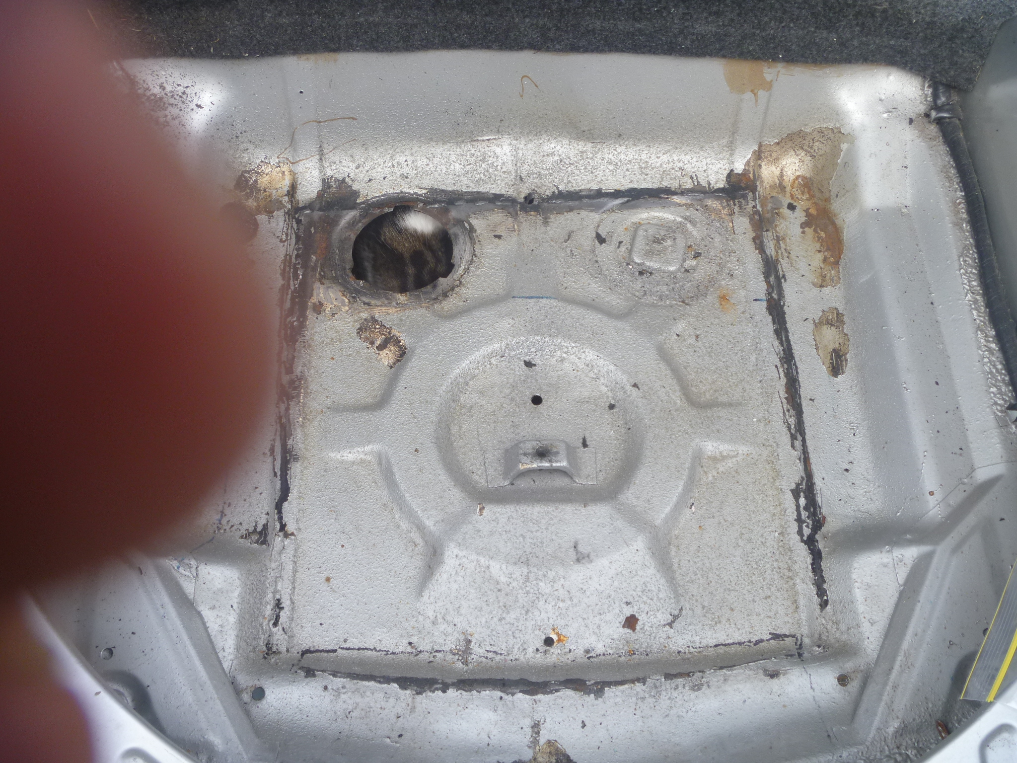

I have to weld in a new front trunk pan replacing the hole left from an AC unit. I have taken two MIG classes. Beside being a newbie, I have other limitations to consider.
I don’t have access to a 220 line.
I’m inexperienced.
It would cost me $1000 to have it professionally done. And I don’t want to buy a bunch of equipment for one job.
Can I use a flux welder? There a couple cheap units at Harbor Freight (under $150) on sale right now. What don’t I know that I should know?

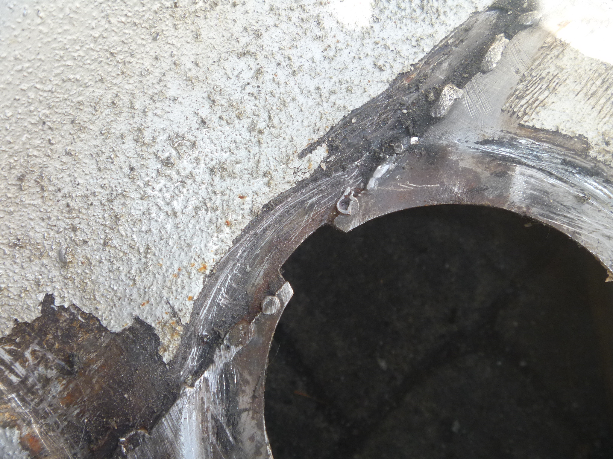

(IMG:style_emoticons/default/agree.gif) ,also the shape of area is a problem already , if repair panel isn't butt welded it's never going to fit properly if lapped the overlay will cause gaps ,its not you can just dolly them down due to all the curves.
Rust is a certainty and just a matter of time and it will look ugly ....ask me how I know all this ?? ,PO did this after welding up a patch to cover the hole for a cooler ,too much heat and not enough tacks ,the patch has also buckled upwards as no gap as there would be with butt weld .
I'am faced with trying to fix this as I can't bring myself to cut it out but may have to ,have scrapped all the sealer out there is rust.
It looks much worse that the photos trust me on that (IMG:style_emoticons/default/headbang.gif) .
