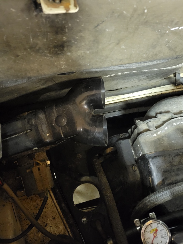

I have this seeming factory Y pipe.
(IMG:http://www.914world.com/bbs2/uploads_offsite/i.imgur.com-14731-1702300378.1.jpg)
it's a 52mm OD as are the J tubes that run through the tins the the HEs. Almost every source for theses lists 55mm or 60mm hose diameters? Do folks cinch them way down?

the original plastic hoses had moulded ends on them where they clamped.
the moulded ends matched the blower outlets and the j tubes.
early was 61 and 73 on were 55. this referred i think to the diam of the corrugated hose section itself.
there was a long thread on all this about a year ago in terms of trying to get the right diam hose - any hose you get now does not of course have the moulded smooth clamp sections on the end as the originals had.
i think i remember in that thread it was all about how you could not quite buy an off the shelf hose that would fit snuggly over the j tubes and blower outlets.
