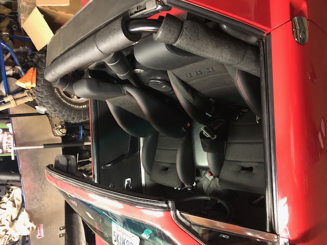

VegasRacer   Maybe these pictures will help. Photos are not my ...   Apr 8 2021, 08:58 AM
Luke M   Maybe these pictures will help. Photos are not my...   Apr 8 2021, 09:42 AM

mlindner   Also 6' and seat gos back all the way. I did j...   Dec 11 2023, 10:13 AM
