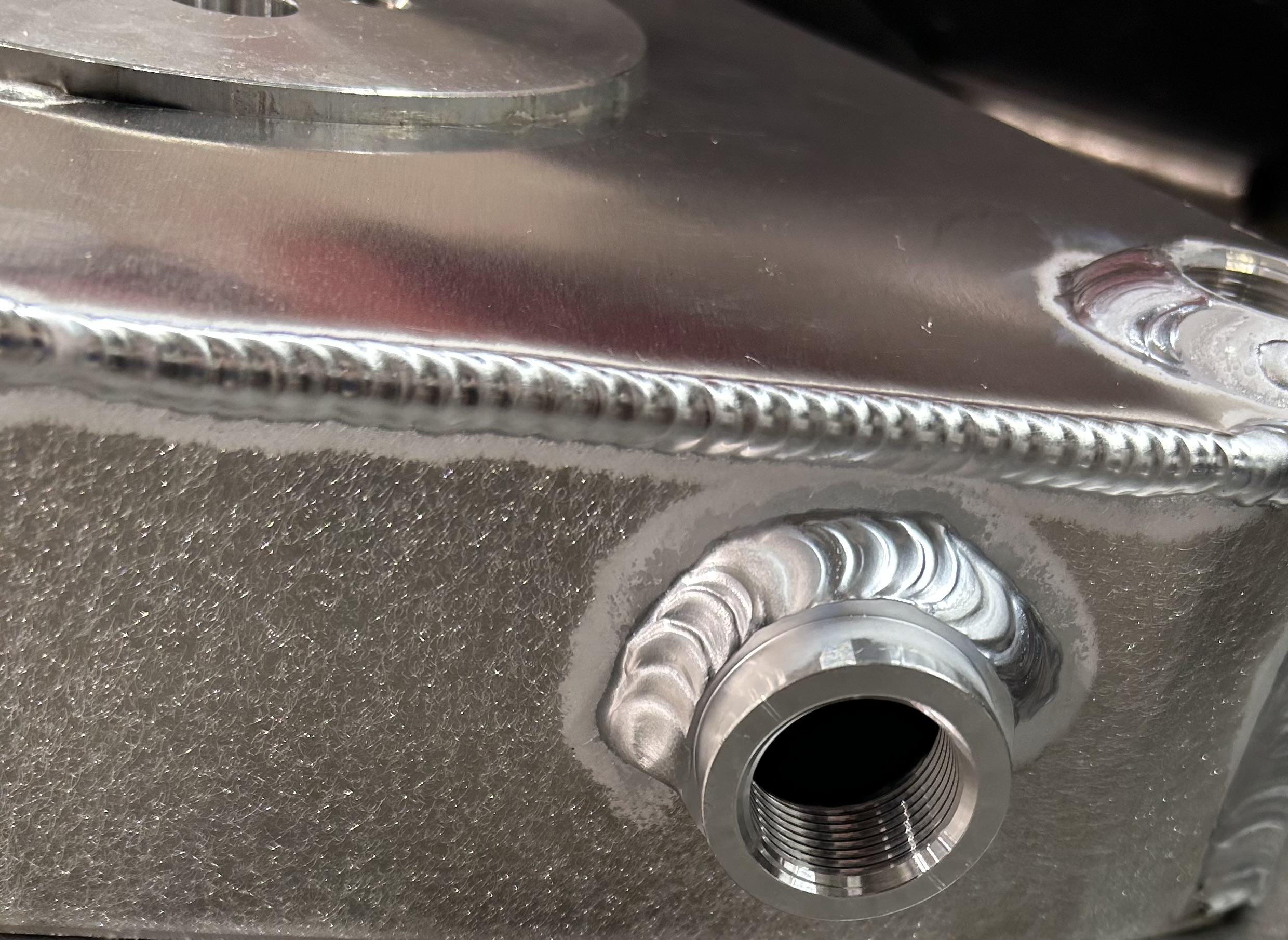

mb911   Ok I have to pipe up a little bit here as I do thi...   Dec 12 2023, 05:15 PM
mb911   RE: Welding advice   Dec 12 2023, 05:16 PM
930cabman   Nothing short of artwork, thanks for posting. Ho...   Dec 12 2023, 07:14 PM

Deusexmachina77   @mb911 That TIG weld is a thing of beauty. I only...   Dec 13 2023, 04:49 PM
mb911   [b]@[url=http://www.914world.com/bbs2/index.php?s...   Dec 13 2023, 04:56 PM
