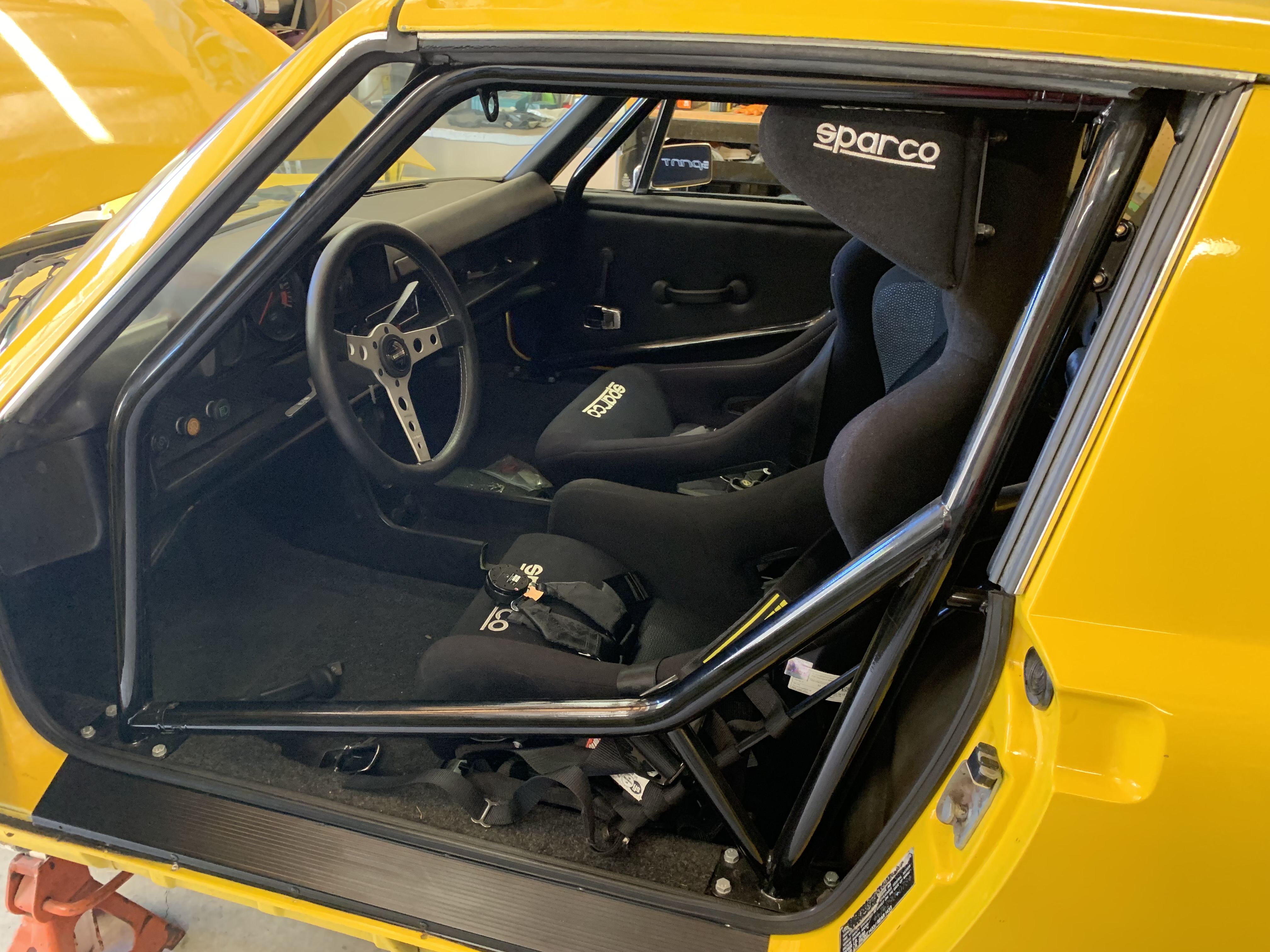

tygaboy   I vote weld in. I helped a buddy with his bolt-in ...   Apr 8 2021, 08:40 AM
VegasRacer   Maybe these pictures will help. Photos are not my ...   Apr 8 2021, 08:58 AM
Luke M   Maybe these pictures will help. Photos are not my...   Apr 8 2021, 09:42 AM

infraredcalvin   I have a safety devices bolt in cage that was weld...   Apr 8 2021, 01:23 PM
tazz9924   Weld in cages are always preferable to bolt in fro...   Apr 8 2021, 01:34 PM
mlindner   Mine is a user friendly cage extended to suspensio...   Apr 8 2021, 01:44 PM
