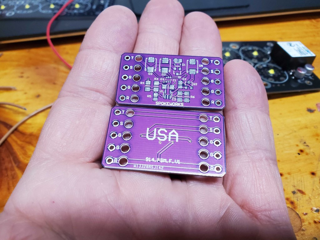

There has been some interest in a module that would flash the front sidemarker with the turnsignal. The rear running/brake/turnsignal board I did for the 356 using the front turnsignal bucket from a 914 uses the same function to flash the running or brake light when the turnsignal comes on.
The flashing circuit was lifted from the 356 board and placed on this board with some modification. The board will be about 1.6in x 1in and will be enclosed in a small plastic box. The module will replace the wires which go from the front trunk into the rubber wire channel to the sidemarker and turnsignal.
Basically the wires to the turnsignal and sidemarker will be pulled out of the rubber channel and connected to the module. The module will have wires that will be fished into the rubber channel and connected to the sidemarker and turnsignal just like the OEM wiring. The OEM wiring will remain intact keeping with my goal of no cutting/screwing/gluing plug-and-play installation.

A little Christmas present a bit early. Gotta do some mods on the board and assemble this weekend.
A while back I was chastised by the fab house that if I put 'Made in USA' on the board I might have issues with customs. So I started putting only 'USA' on the board. Every board I do the USA get larger and larger. (IMG:style_emoticons/default/beer.gif)

Spoke   Assembled the first set of boards. They seem to wo...   Dec 22 2023, 07:27 PM
