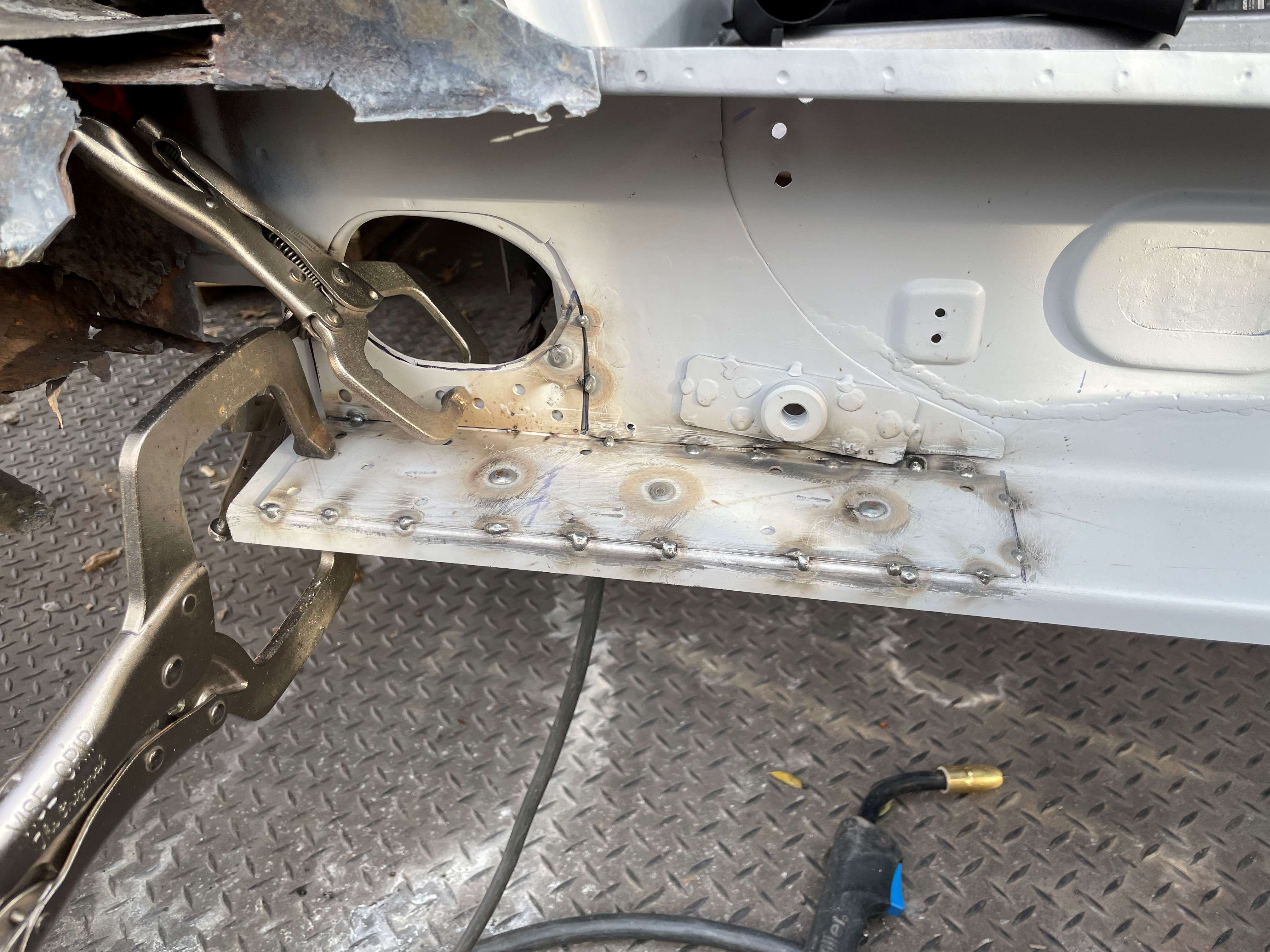

Passenger Side Longitudinal - Part 2 (1/2023): Ok, here are the photos of my repair of the passenger longitudinal. I used the repair piece made by Restoration Design and their replacement seat belt mount (bolt). Like with my last 914, I'm using just the bottom half of the new longitudinal and I prefer to cut this in 1/2, as well. Last time, I used the top half of the passenger side longitudinal repair piece for the driver side and it worked out well. I saved some money in the process, too.
IMO, the key here on doing this repair is using the new rocker panel (also an RD replacement) to set the correct distance. Once this is set, I draw a line and cut the piece. The new crossbar kind of got in the way but it wasn't too bad. You may noticed that I mis-cut the back piece a little and then added additional metal at the interface with the crossbar. It all worked out in the end.
