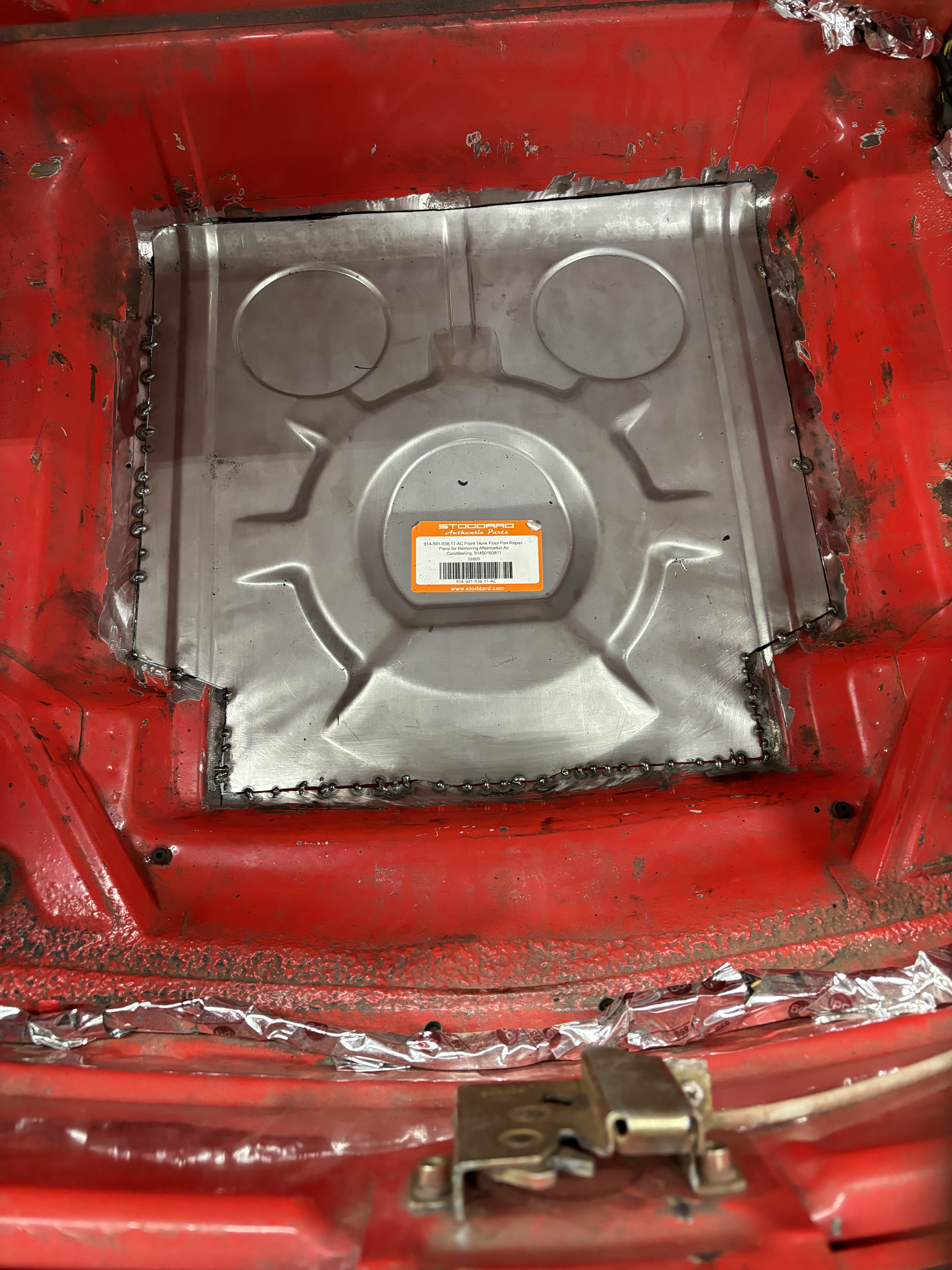

I cut the panel to where I thought it would lay best and found the best metal to adhere to. I tacked the panel in place, then cut around the panel with the thinnest cutting wheel I could find. Sometimes I used a Dremel. Cut and tack. Cut and tack. The backside closest to the vertical is not as bad as it looks. The old floor sagged away after it was cut. With just a little help it meets the new panel perfectly. I had a couple of mistakes cutting making bigger gaps than I wanted. Rookie mistakes. But all in all I think I'm going to be okay.

I cut the panel to where I thought it would lay best and found the best metal to adhere to. I tacked the panel in place, then cut around the panel with the thinnest cutting wheel I could find. Sometimes I used a Dremel. Cut and tack. Cut and tack. The backside closest to the vertical is not as bad as it looks. The old floor sagged away after it was cut. With just a little help it meets the new panel perfectly. I had a couple of mistakes cutting making bigger gaps than I wanted. Rookie mistakes. But all in all I think I'm going to be okay. +1 looks great. Welding is like anything else, practice and more practice. Sure, the basics need to be correct, but the technique is all experience. |
