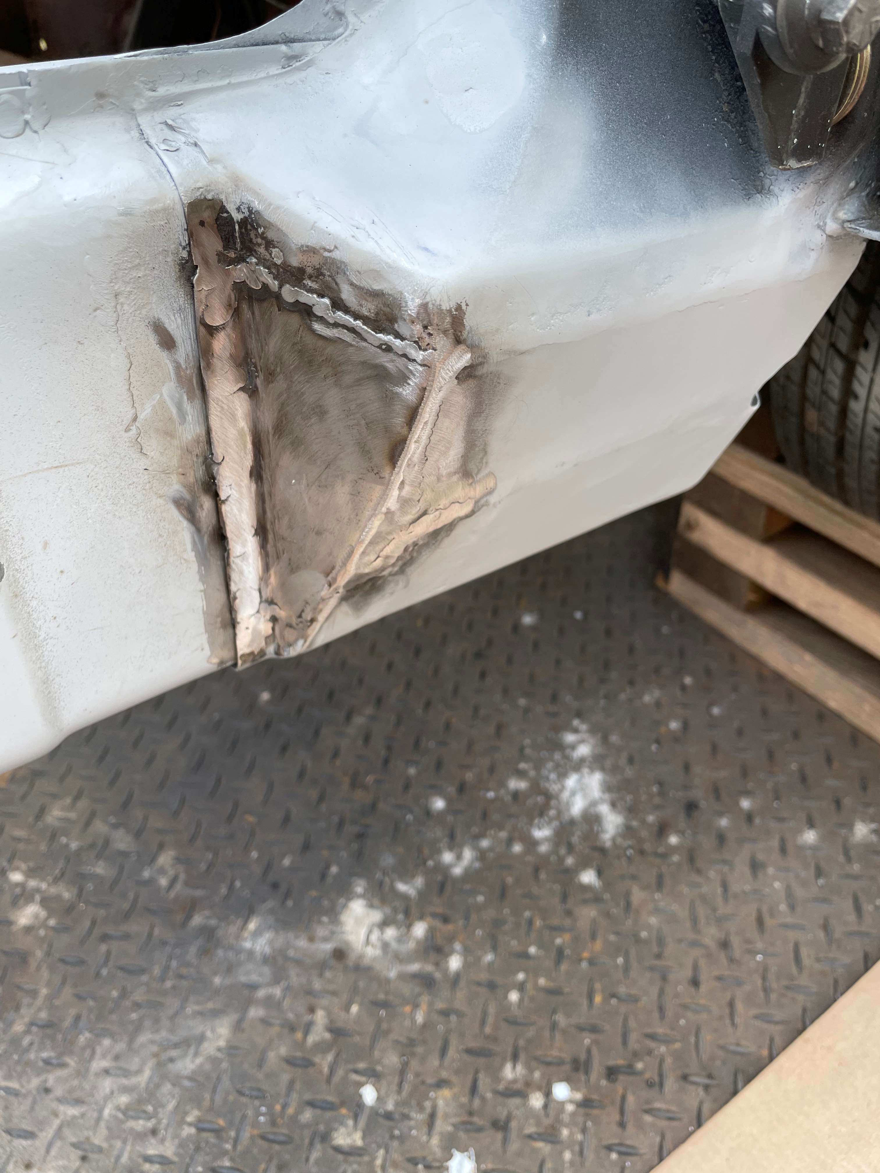

Fender Support Repair (4/2023): The final step in the longitudinal fix is to reconstruct the lower section of the hinge support bracket. I also had to fix the "unauthorized" hole [probably for speaker wires] and a few minor rust holes. With this car being an A/C car, I had to contend with the holes made through the support of the hoses. At the front, I tried to replace the rusted metal as best I could. I did leave a little of the repair for later when the car is mounted on the rotisserie. I just couldn't get a lot of access with everything else that was in the way. On the back side of the repair, I just replaced the metal, added some reinforcing metal and called it a day. I'll drill the A/C holes later before I weld in the door sill.

friethmiller   Fender Support Repair (4/2023): The final step in ...   Dec 19 2023, 08:29 AM
