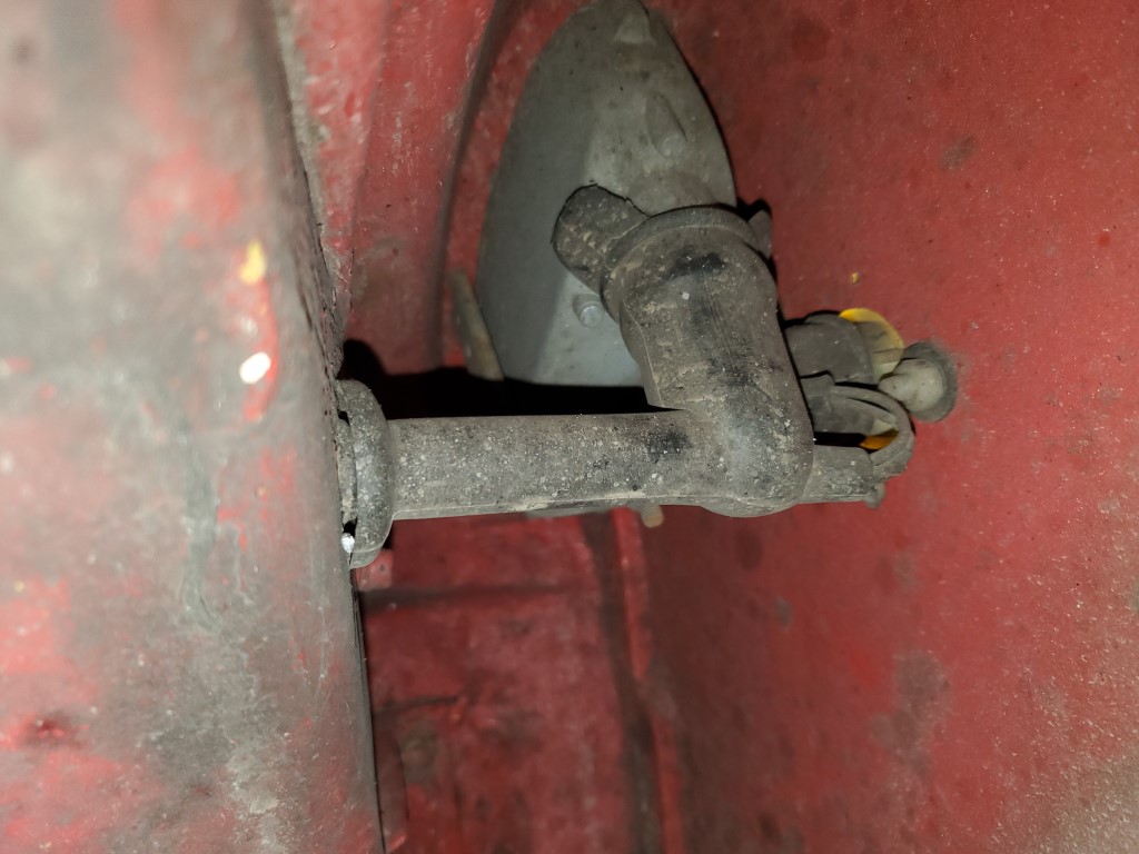

OK time to install the flasher module on my 914. My general rule is no cutting/gluing/drilling to install LEDs. So the task at hand is to un-fish the wires to the sidemarker and turnsignal out of the rubber conduits.
This is turning out to be more of chore than I thought would.
First thing is to get to the ends of the wires to disconnect from the light fixtures.

Spoke   Pulled the sidemarker wires off the socket ok. But...   Dec 24 2023, 03:06 PM
Spoke   All the wires have been pulled out of the conduit....   Dec 24 2023, 03:11 PM
Spoke   This is the power spade pulled off of the sidemark...   Dec 24 2023, 03:14 PM
