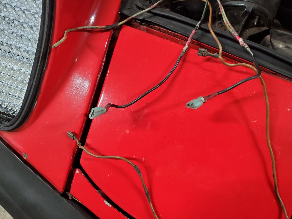

All the wires have been pulled out of the conduit. The power spade on the sidemarker pulled off the wire. I had added some wire to the original wires to allow for more movement when I did a refurbish a while back.
The ground wire (brown) has 2 spades on it for the sidemarker and turnsignals. I'll likely just run 2 separate ground wires to keep it simple.
