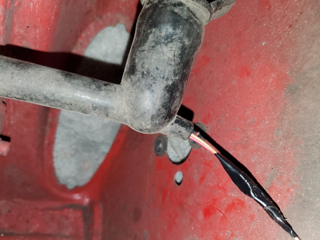

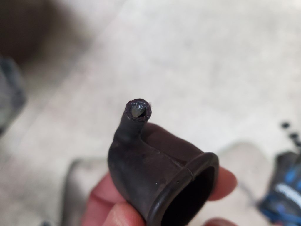

Sidemarker wires pulled through the main conduit.
Put petroleum jelly on the wires and tube of the sidemarker gasket. This still didn't help much. Probably would have helped to heat up the gasket in hot water.
The turnsignal wires are pulled easily through the conduit. Ready for final wire attachment.

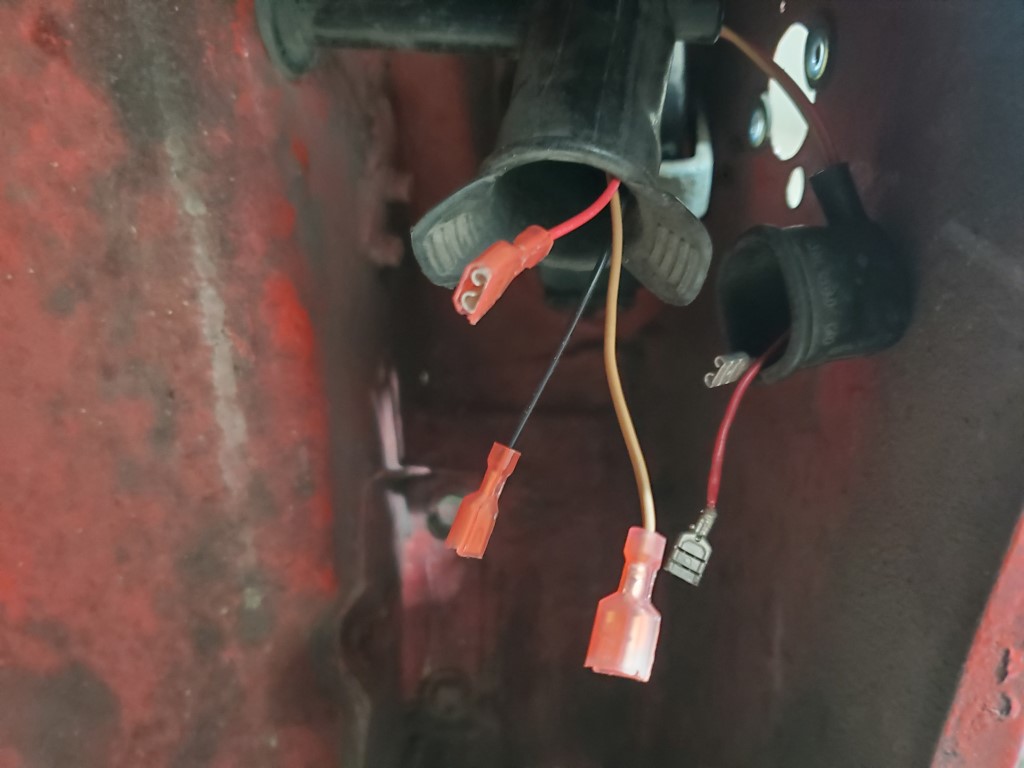

Spoke   OK time to install the flasher module on my 914. M...   Dec 24 2023, 03:02 PM
Spoke   Pulled the sidemarker wires off the socket ok. But...   Dec 24 2023, 03:06 PM
Spoke   All the wires have been pulled out of the conduit....   Dec 24 2023, 03:11 PM
Spoke   This is the power spade pulled off of the sidemark...   Dec 24 2023, 03:14 PM
Spoke   This is the assembly for one side. The module has ...   Dec 24 2023, 07:48 PM
Spoke   To pull the wires and spades for the sidemarker th...   Dec 24 2023, 07:55 PM
Spoke   Sidemarker wires pulled through the main conduit. ...   Dec 24 2023, 07:59 PM
Spoke   Wires all connected and tie wrapped. The pigtail w...   Dec 24 2023, 08:03 PM
