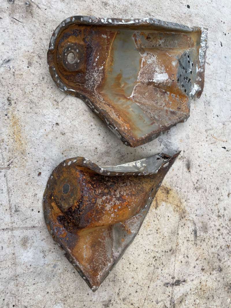

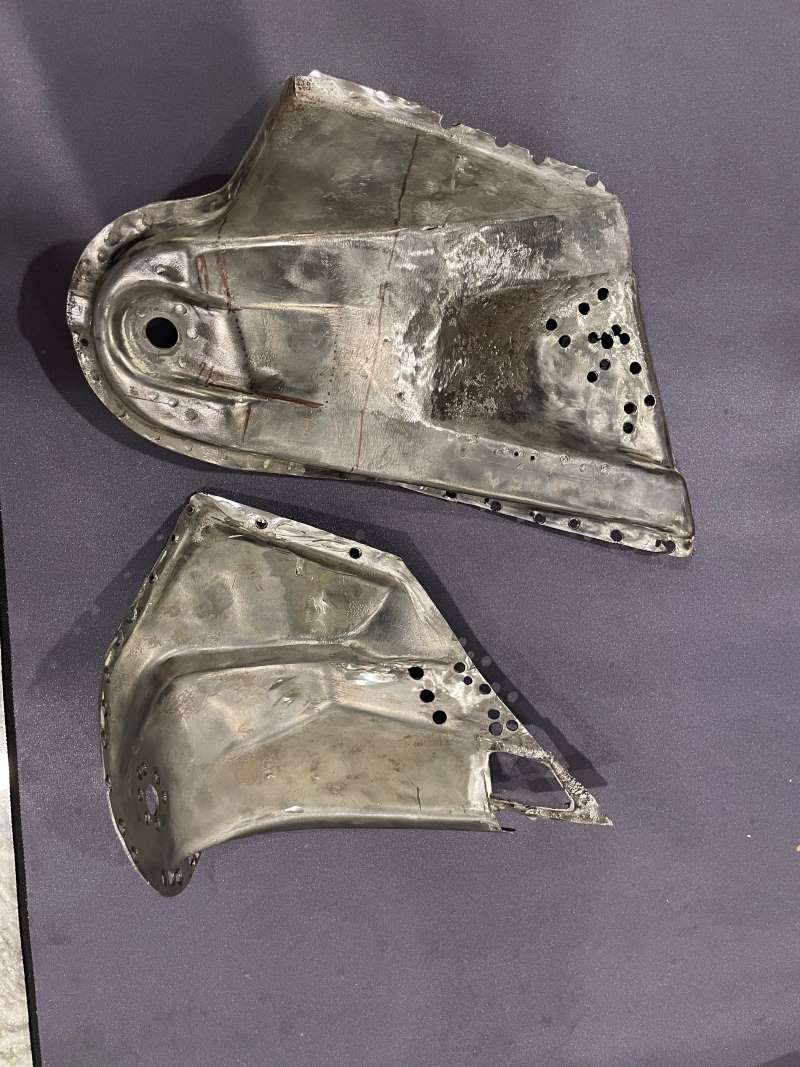

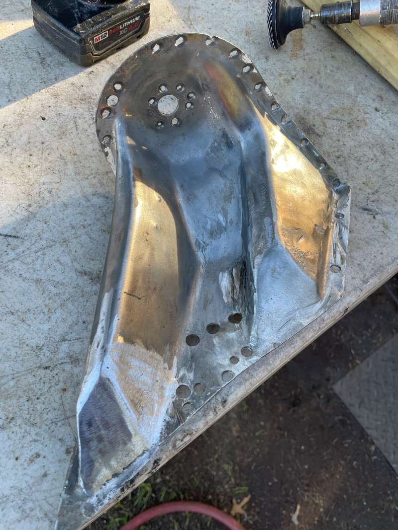

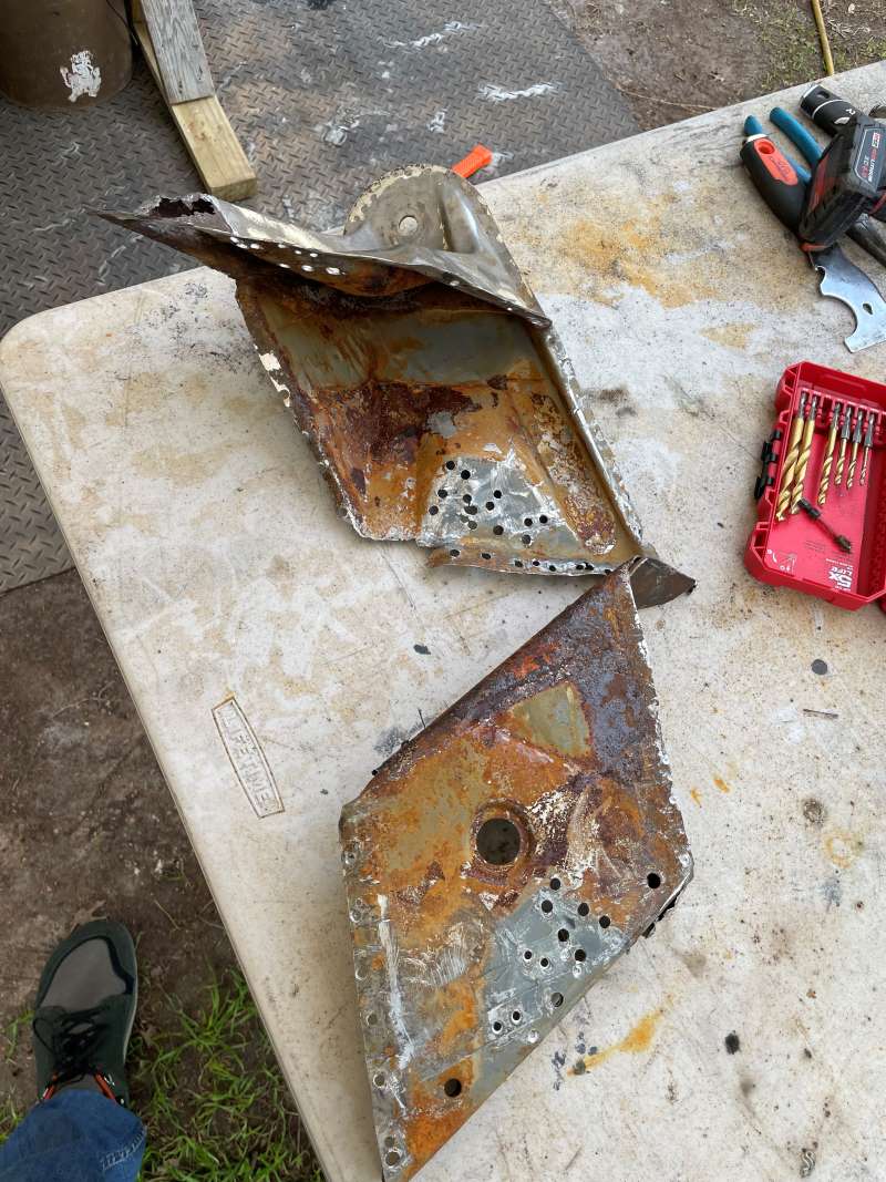

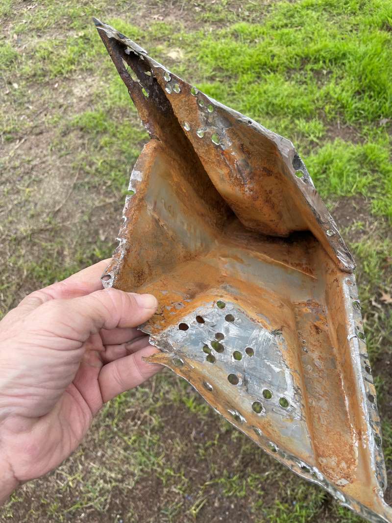

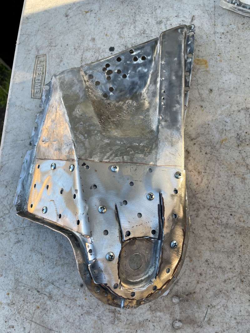

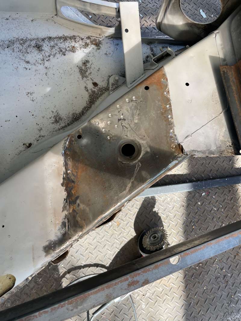

Passenger Inner Suspension Console Replacement - Part 2 (11/2023): The first thing to do is remove the remainder of the original inner console and then prep the new/used donor part for install. Once I removed the donor part from its parent frame rail section I was able to get a good look at its condition. While its not great, it is in better shape than my existing console.
After a quick inspection, I decided to separate the console into its pieces in order to properly rust treat prior to install. These photos show the "before" and the "after" It took several days of rust treatment and a bit of wire-wheeling. While not perfect, it will do for now. My plan is to spray in rust treatment at the end once the part is secured on the car.

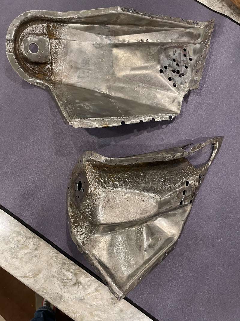

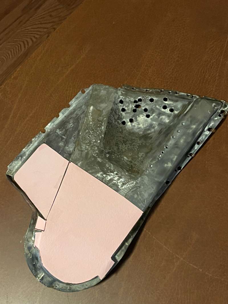

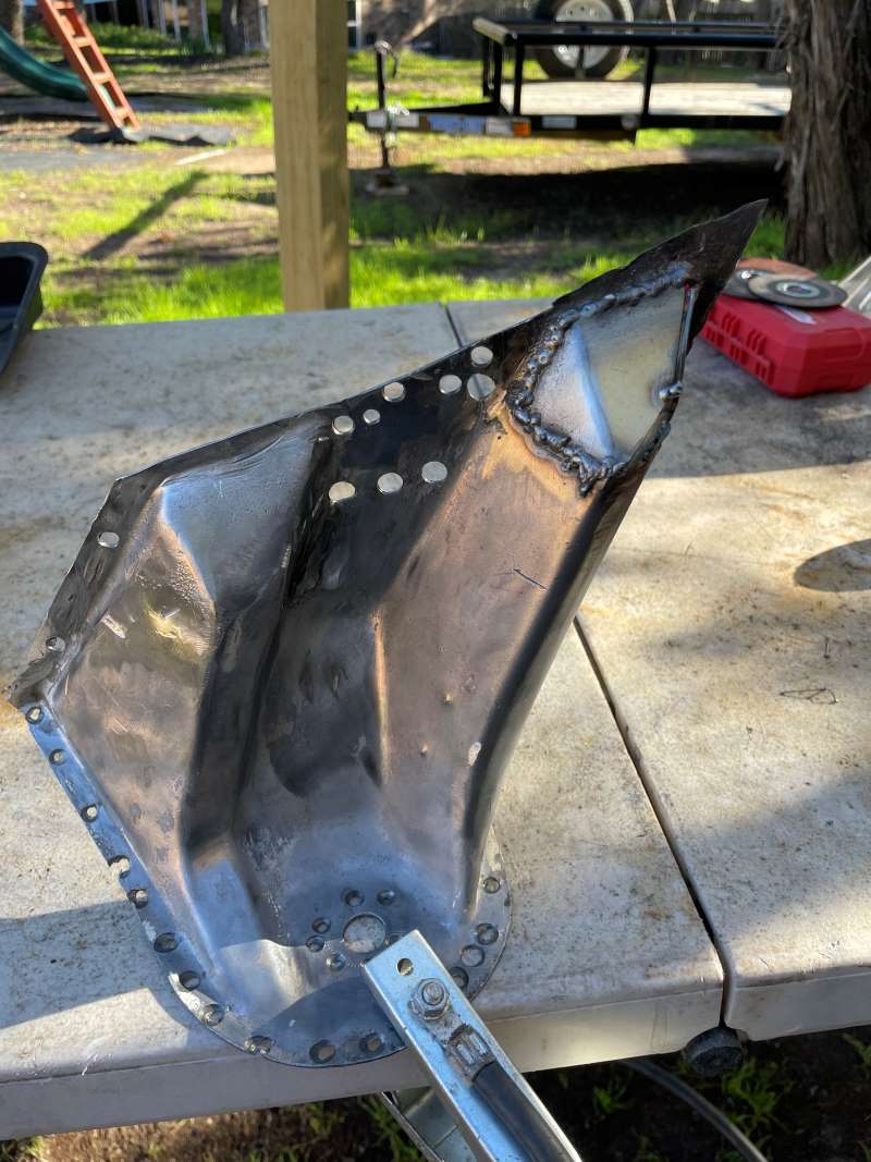

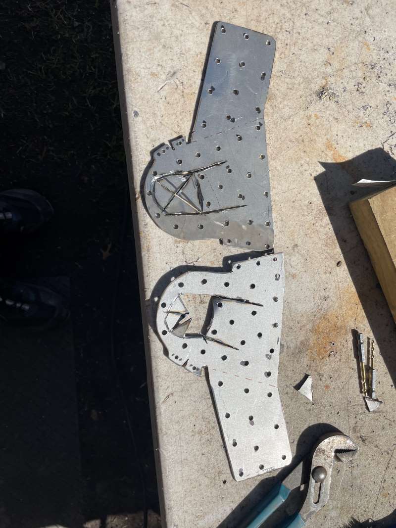

Knowing the condition of the metal, I decided to go ahead and reinforce the part. Based on what Tangerine racing offers for this, I was tempted to just order the kit. However, I happen to have 16 gauge sheet metal laying around and thought I'd give it a go. Here's a few photos of the process. I created one piece for either console. This was a pretty straight forward. It would have been easier with some nibs (as suggest in this thread earlier). My next posts will show how all of this is fitted and welded to the console.

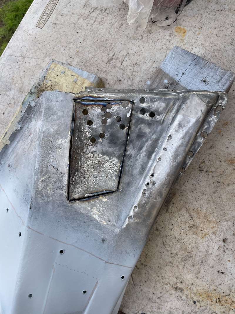

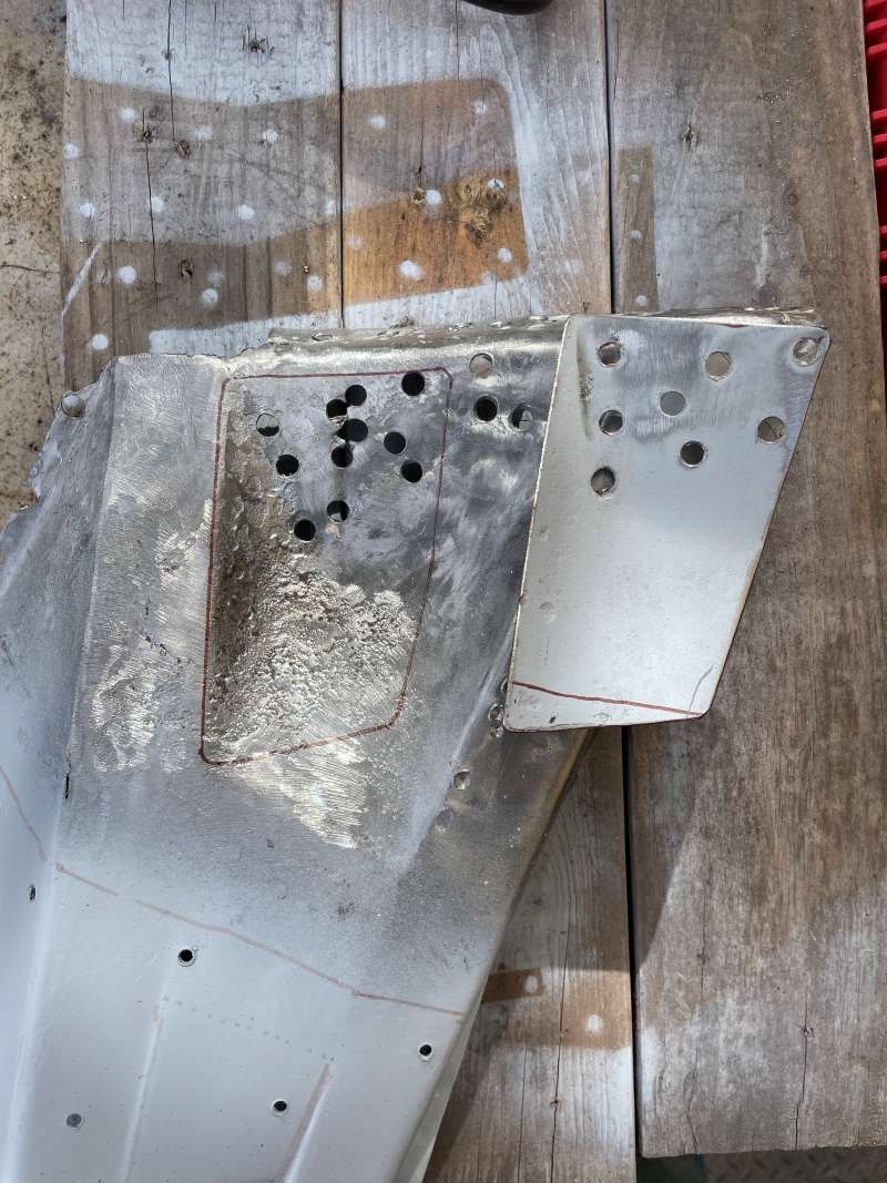

Before the part would be ready I had to fix the rust damage at the one end and then weld the two half together. I also fitted the reinforcement piece. I found it much easier to do the bending with the console half with me at the metal break. The following photo show this process.

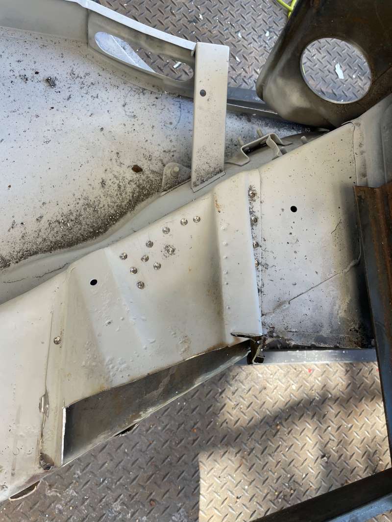

I didn't like the looks of the metal in the recess on the replacement console so I used a piece from my original console to make a quick repair. Finally, I had to deal with the missing ear at the top of the replacement console. Unfortunately, my original console was rusted out here, as well. I decided to use the ear from the other side of my original piece. I figured I could fashion it to look the same. I only need the portion at the top to match. I can grind the edge here to straighten everything out.

friethmiller   Passenger Inner Suspension Console Replacement - P...   Dec 28 2023, 08:27 AM
friethmiller   Passenger Inner Suspension Console Replacement - P...   Dec 28 2023, 10:32 AM
friethmiller   Passenger Inner Suspension Console Replacement - P...   Dec 28 2023, 10:50 AM
