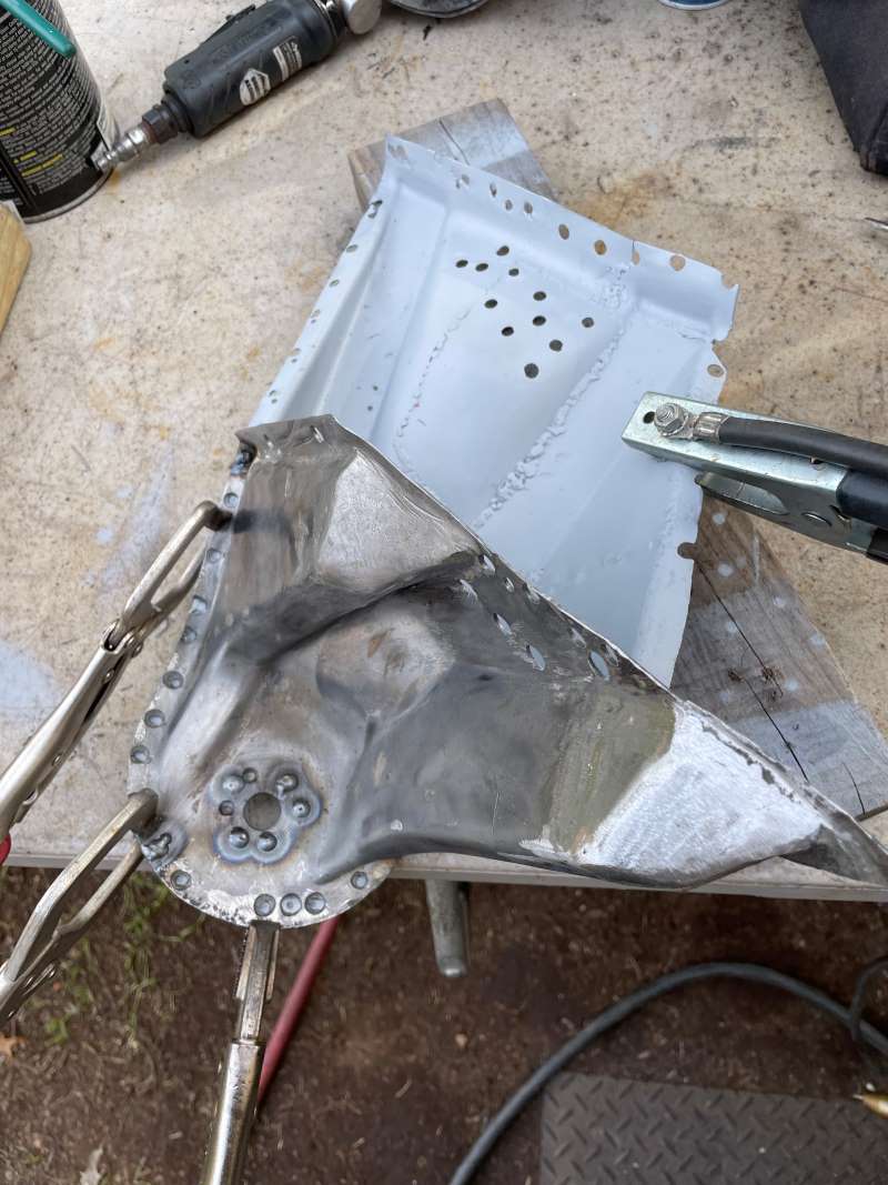

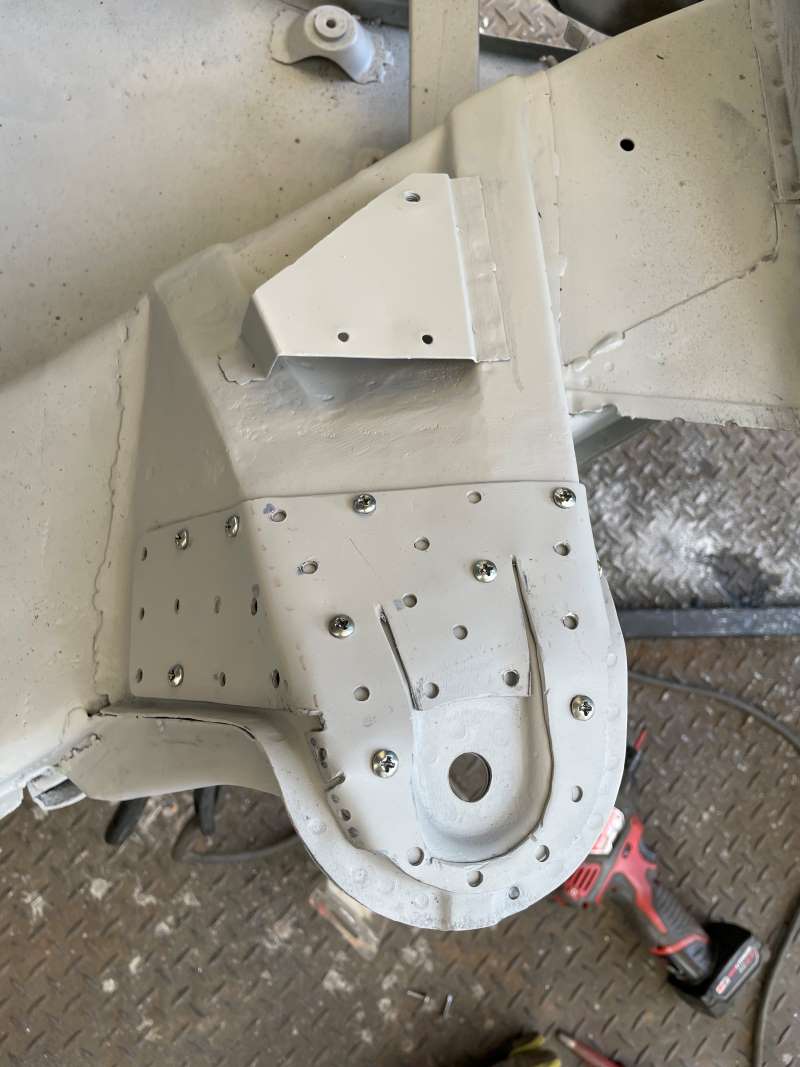

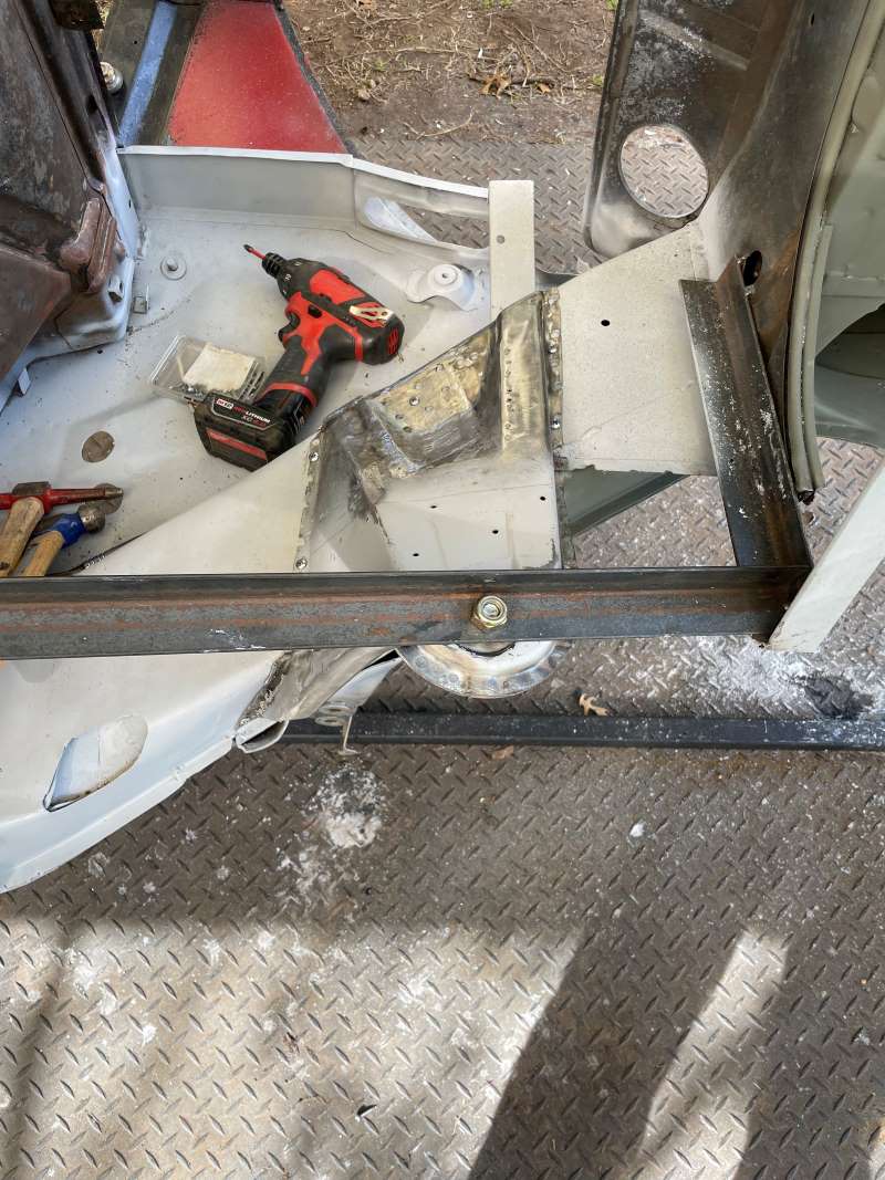

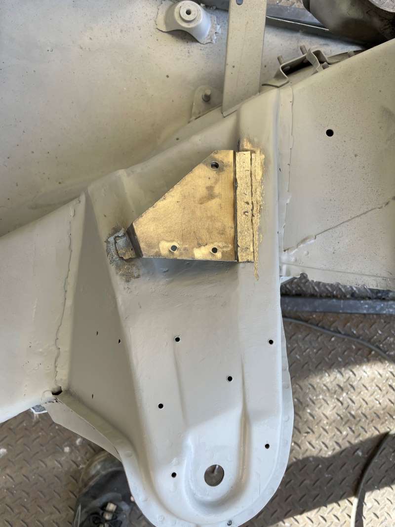

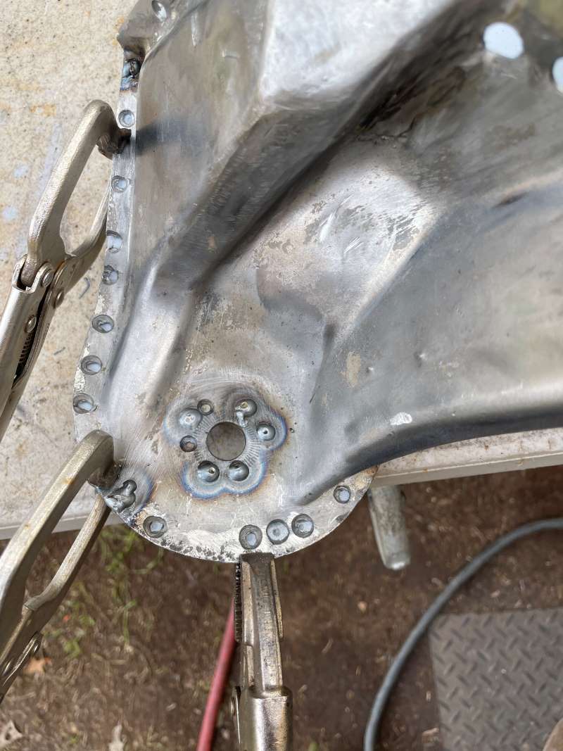

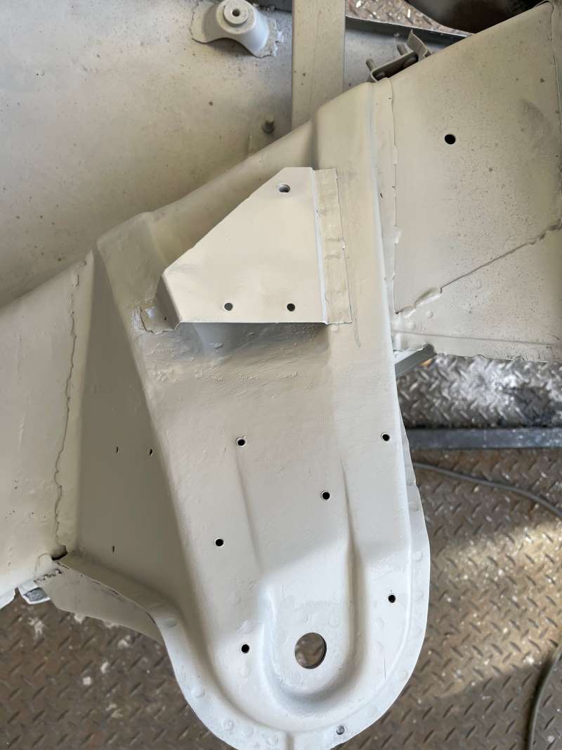

Passenger Inner Suspension Console Replacement - Part 3 (11/2023): With the metal repairs completed, it's time to assemble the replacement console and get it installed on the car. The following photos show this process. Note: see how I forgot to properly drill out my spot weld holes. While not the end of the world, and I have a pretty good hole for each weld, it still bothers me that I didn't even notice it. Too much focus, I guess. I will show the use of my spot weld tool that I employed to help strengthen this seam later in a separate post.

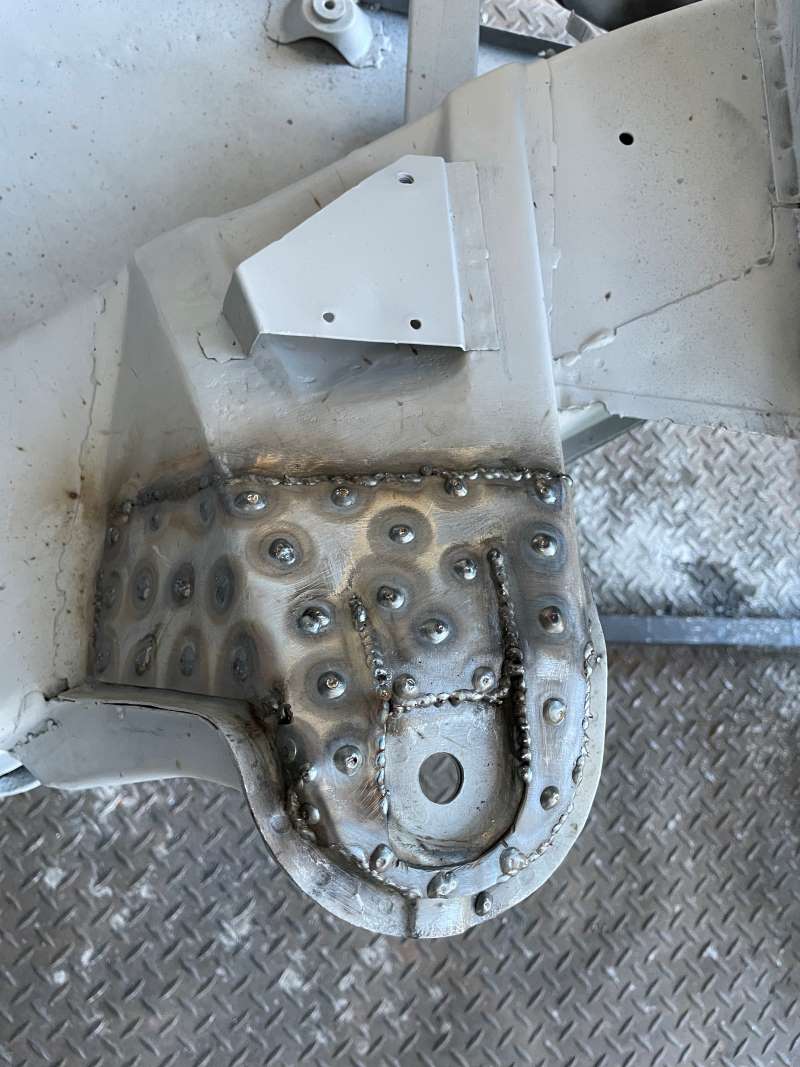

Next, I added the bracket for the MPS sensor (I think that's correct) and welded in my reinforcement piece. Note: the bottom of the reinforcement piece isn't completely welded in but I'll show that in my next post.
