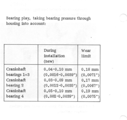

I don't know where you are getting your numbers. I attached the table from the factory manual.

Factory bearing clearance
