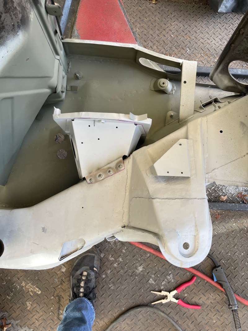

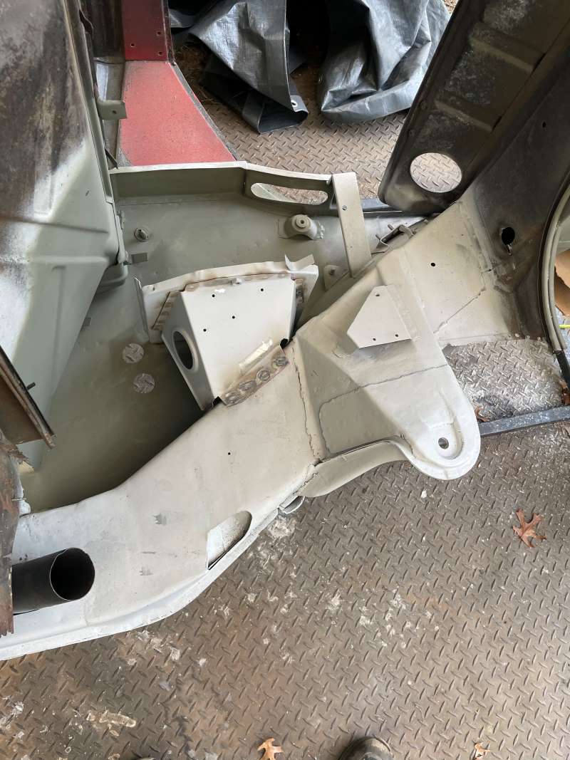

friethmiller   New Battery Tray Install (12/2023): While I had th...   Dec 28 2023, 09:45 PM
friethmiller   Gusset Reinstall and Engine Mount (12/2023): Wit...   Dec 29 2023, 09:08 AM
