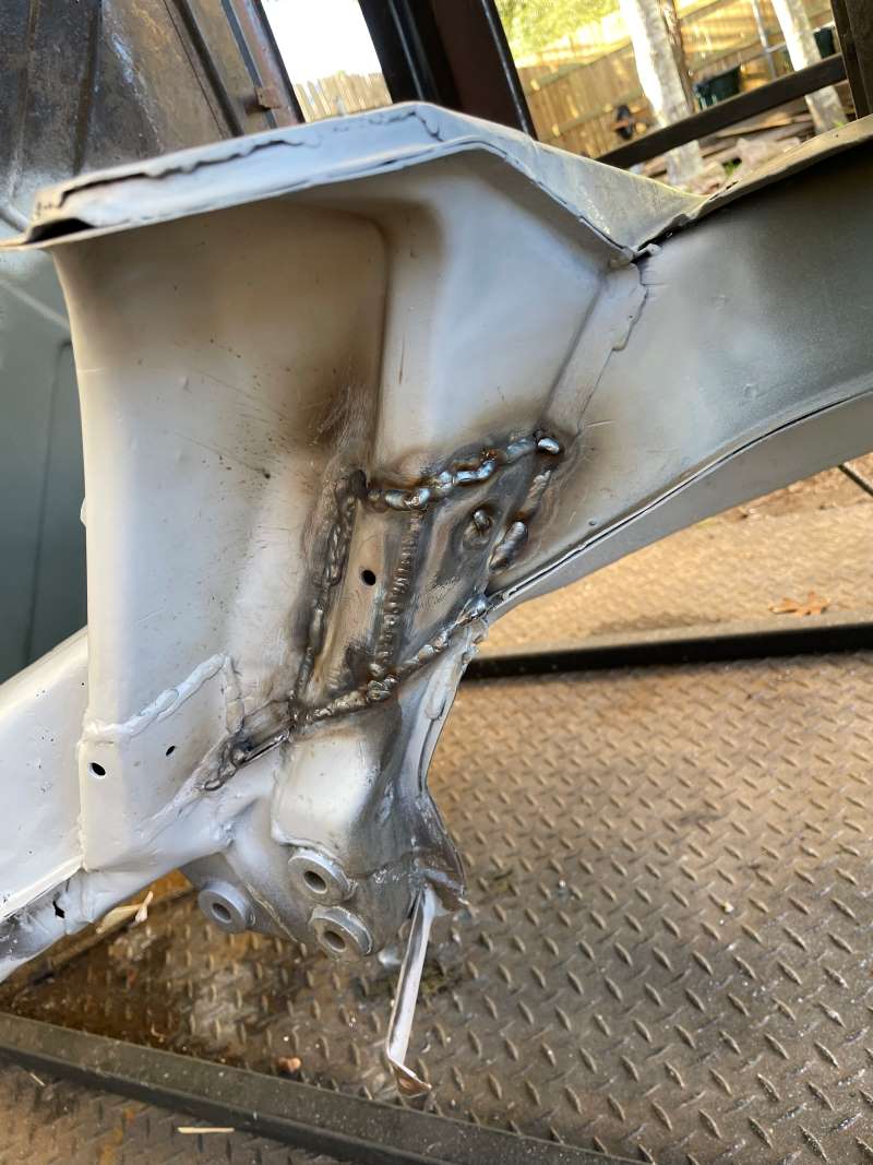

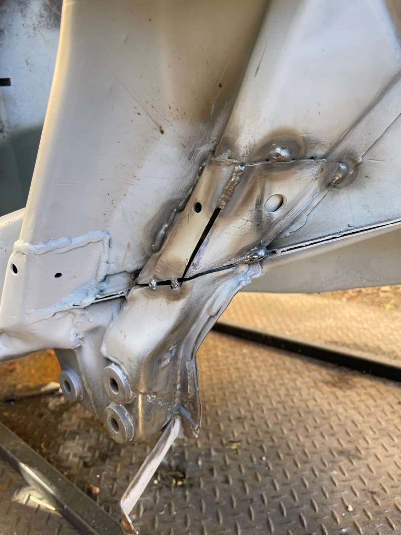

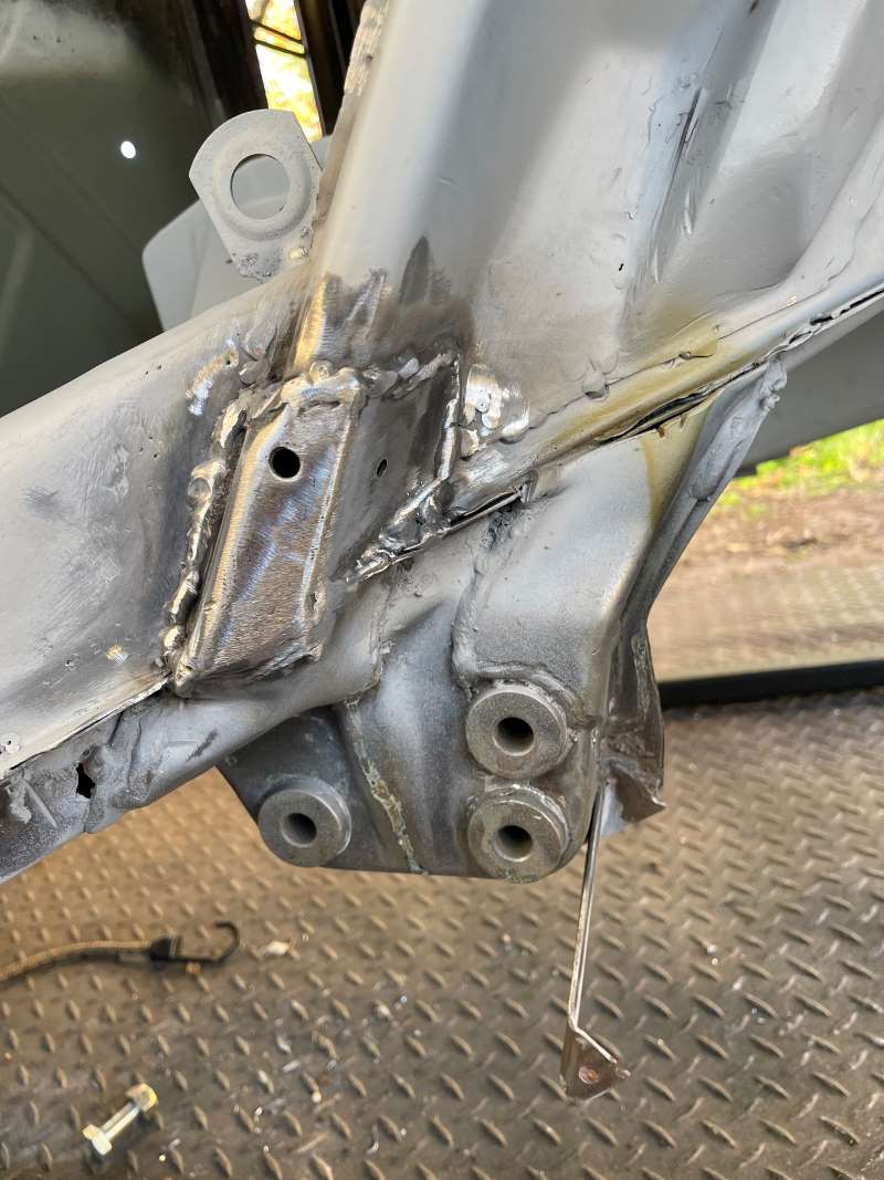

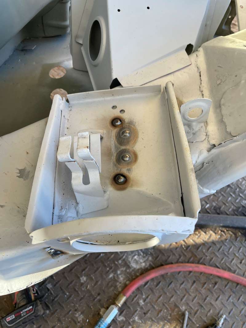

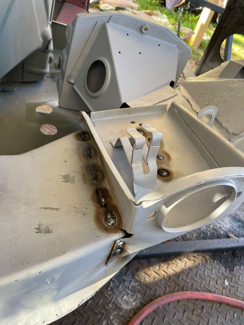

Gusset Reinstall and Engine Mount (12/2023): With the replacement of the inner console, it's time to weld the gussets back in place and finish the job. In the process of doing this I also rewelded the rebuilt engine mount. There's a thread detailing the restoration of this part (with photos) that I posted earlier this year: http://www.914world.com/bbs2/index.php?sho...=365096&hl=.
Note: the yellow substance is the CRC Marine Wax. I've cleaned the internals of the front of each gussets and am just giving it a bit of additional protection before it all gets welded close. Another Note: I took my time doing this welding and used a ton of compressed air throughout the process. It isn't very pretty but I think it'll do.

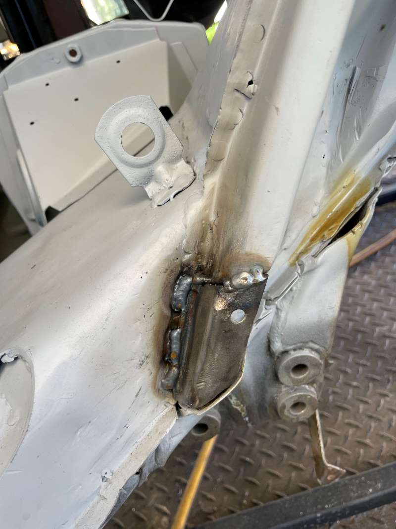

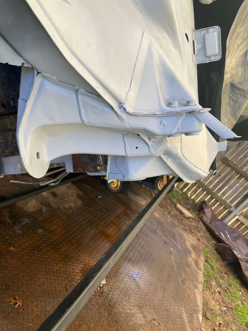

Now it's time to flip the car around and complete any additional welds so it all looks good. I also took this opportunity to add an extra piece of reinforcement that I had left over from my 914 GT kit. I didn't install this piece on my other 914 due to the fact that I used Restoration Design's Frame Stiffeners (https://www.restoration-design.com/store/product/PP346R).
Additional photos taken after welding up a few small holes and cut marks. Not too bad. In the coming weeks, I will be replacing the driver side inner suspension console.
