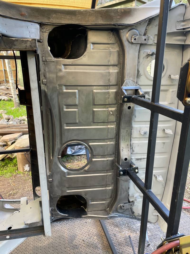

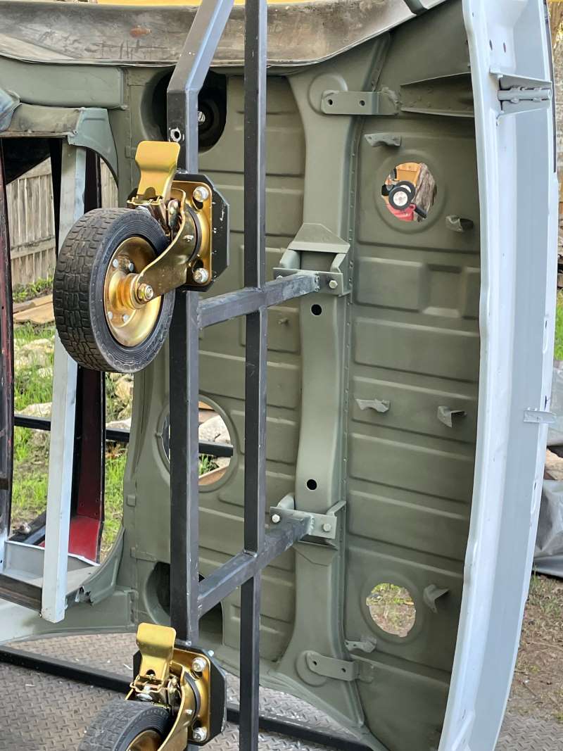

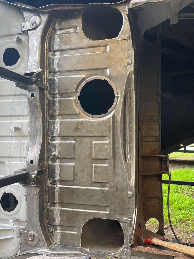

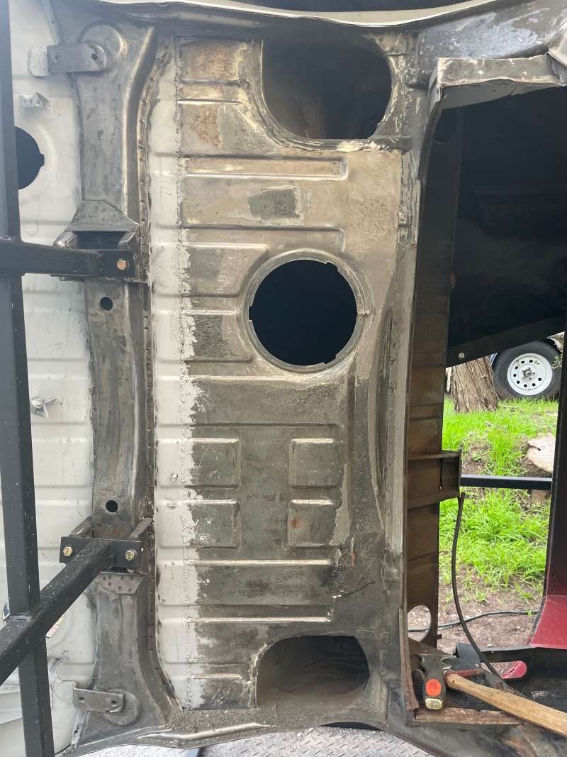

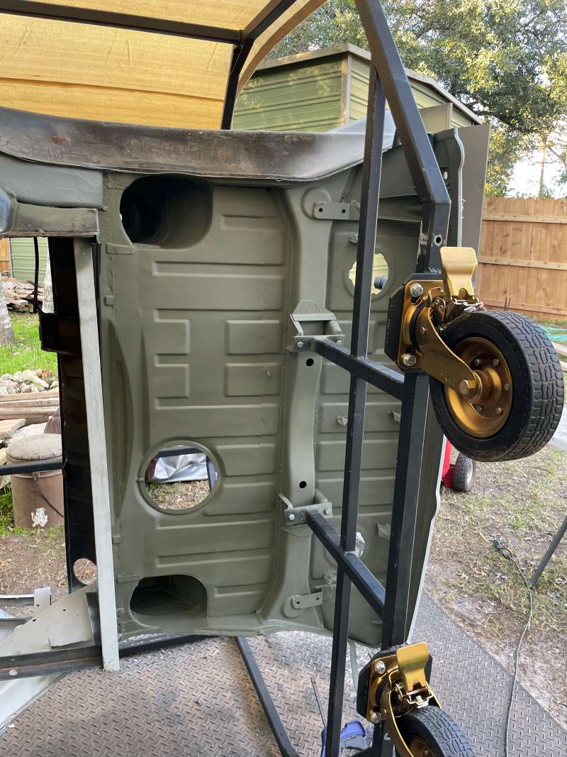

friethmiller   Inner Firewall / Transverse (12/2022): Before I co...   Dec 15 2023, 09:29 AM
