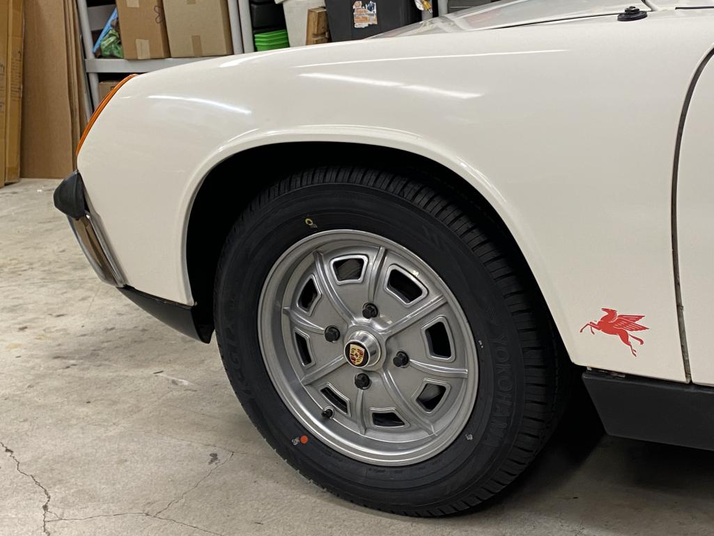

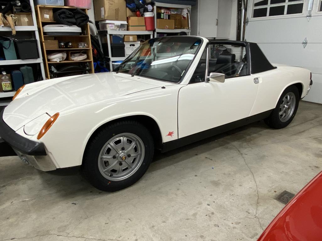

Had a great experience at America’s tire with mounting and balancing.
Wheels mounted, so far I’m super happy with the way they look with the 60 series. Cars little taller because I haven’t taken them out for a ride yet after putting it back on the ground . I think it will settle down an inch or so.
