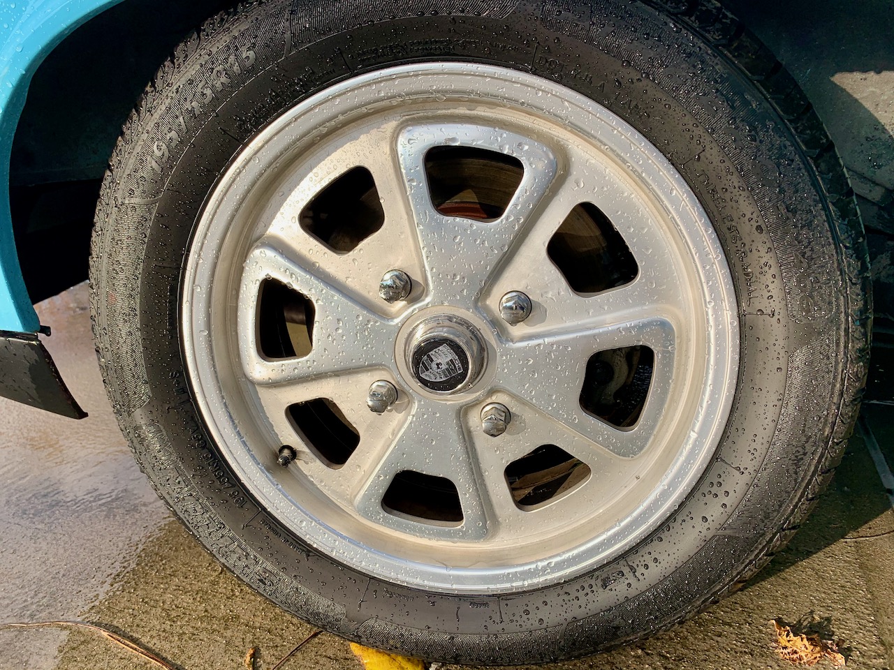

windforfun

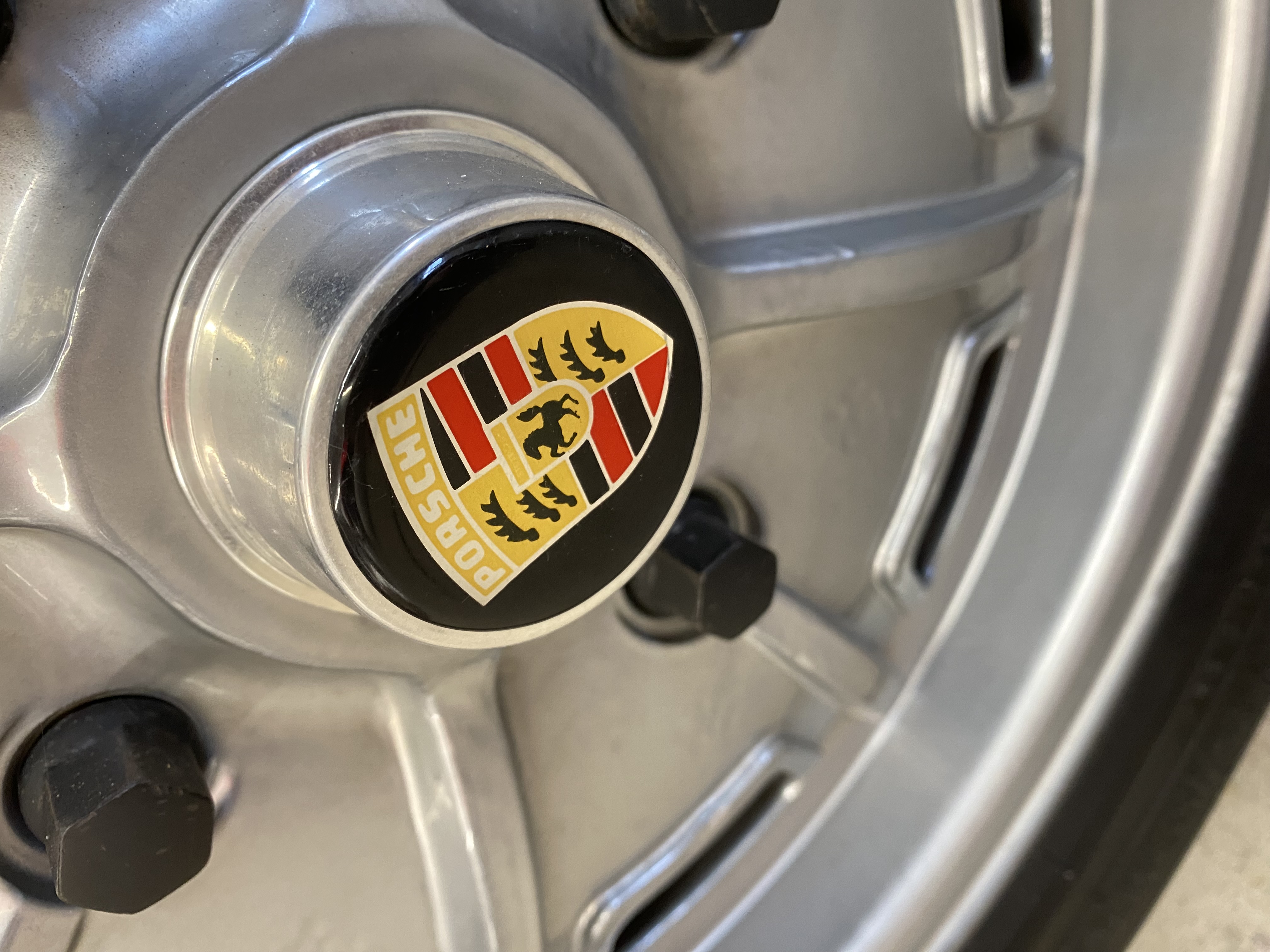

Michelin XZX 165SR15 IIRC from Coker Tire. Where can I get a set of those wheel caps?
FlacaProductions
I believe those are stickers on stock caps. I have similar/same from https://3dcarstickers.com/search/?searchstring=porsche

Checking Flava’s link, it looks like those are the stickers. Great resource.
On the car they look 3d rubberized of some sort. Have some height. Do not have the look of a traditional sticker- look really good

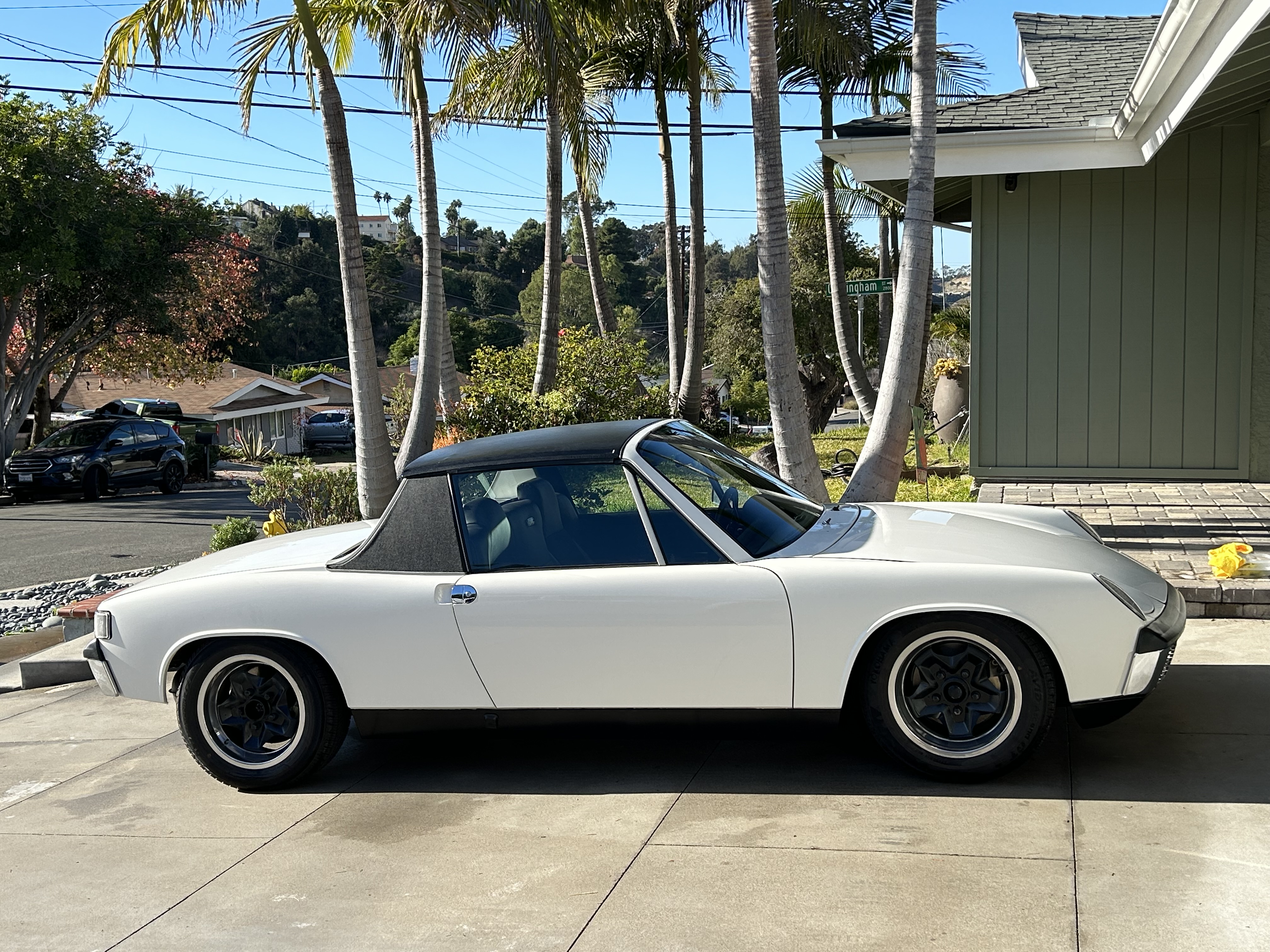

In my humble opinion, it depends on how you like to drive on play days. 205’s are too small in my opinion, though they were sooo much better than any tire I had before them. On my car the tires were the weakest link. They would break loose into a 4 wheel drift in a corner way before the suspension ever felt taxed. I’m now adding flares so I can run 225’s all around. So if you don’t need larger tires the 165’s look great in those pictures. But if you do, don’t settle for a smaller tire. Again, just my humble opinion. @roundtwo

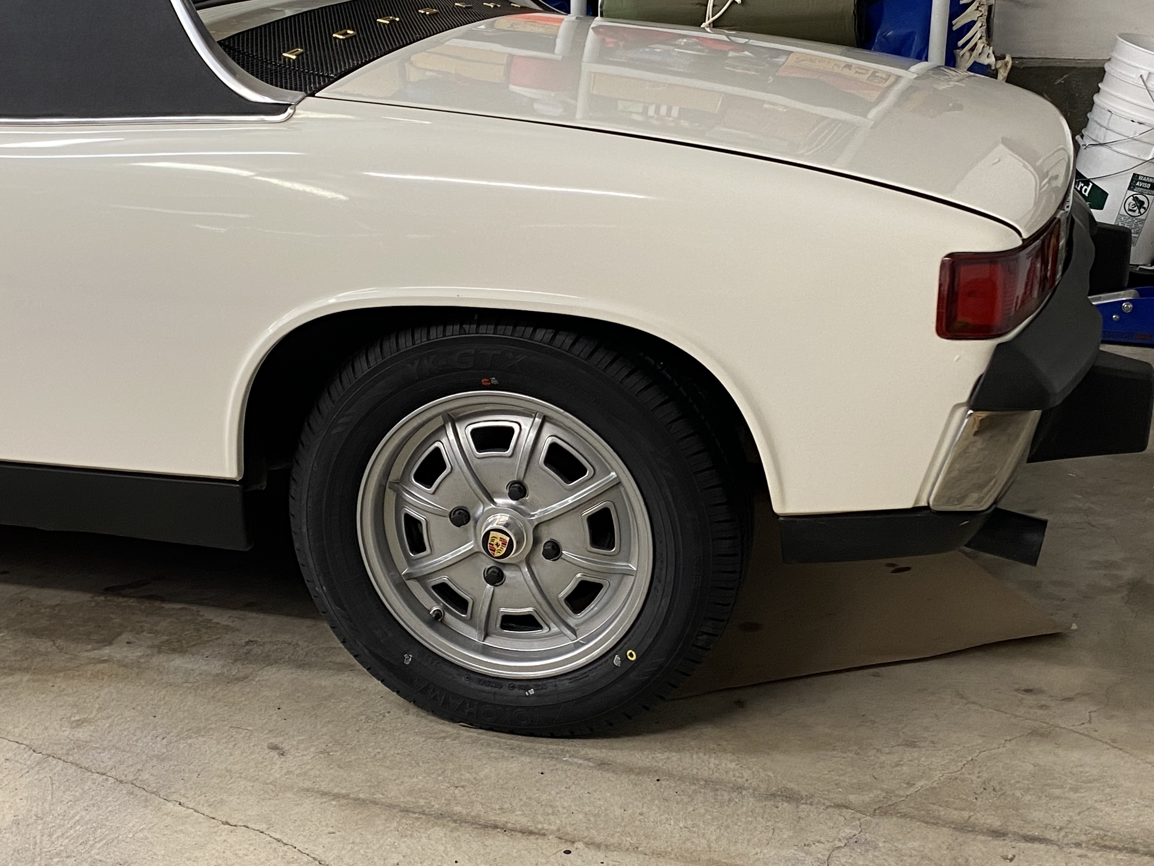

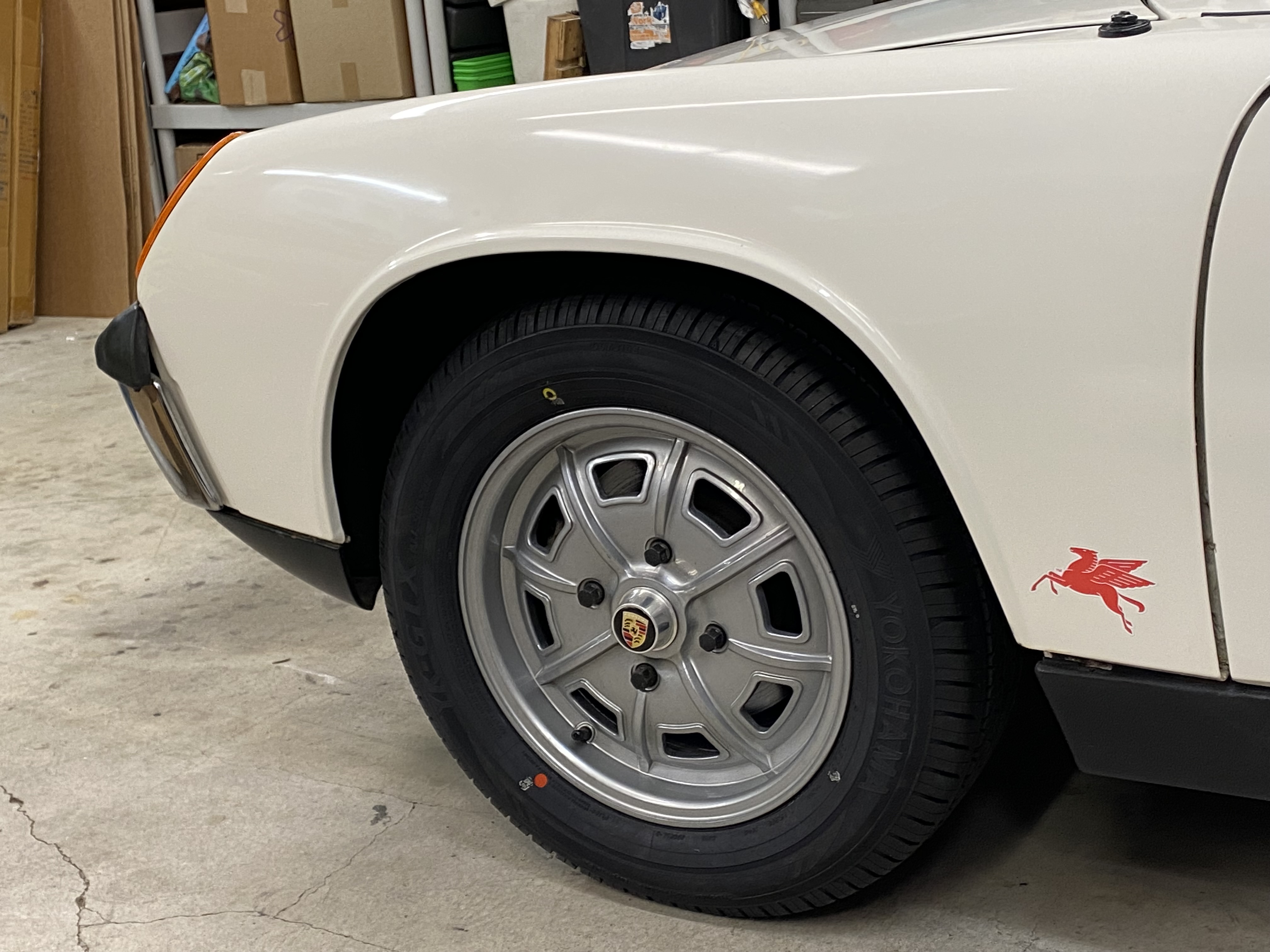

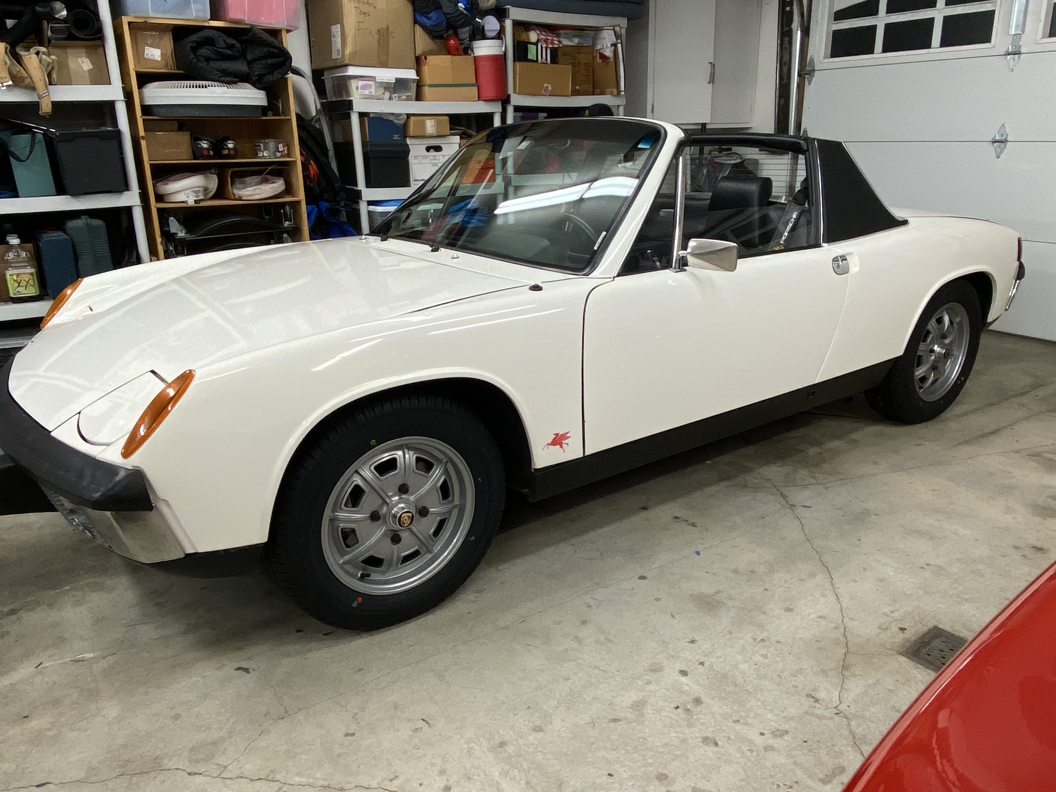

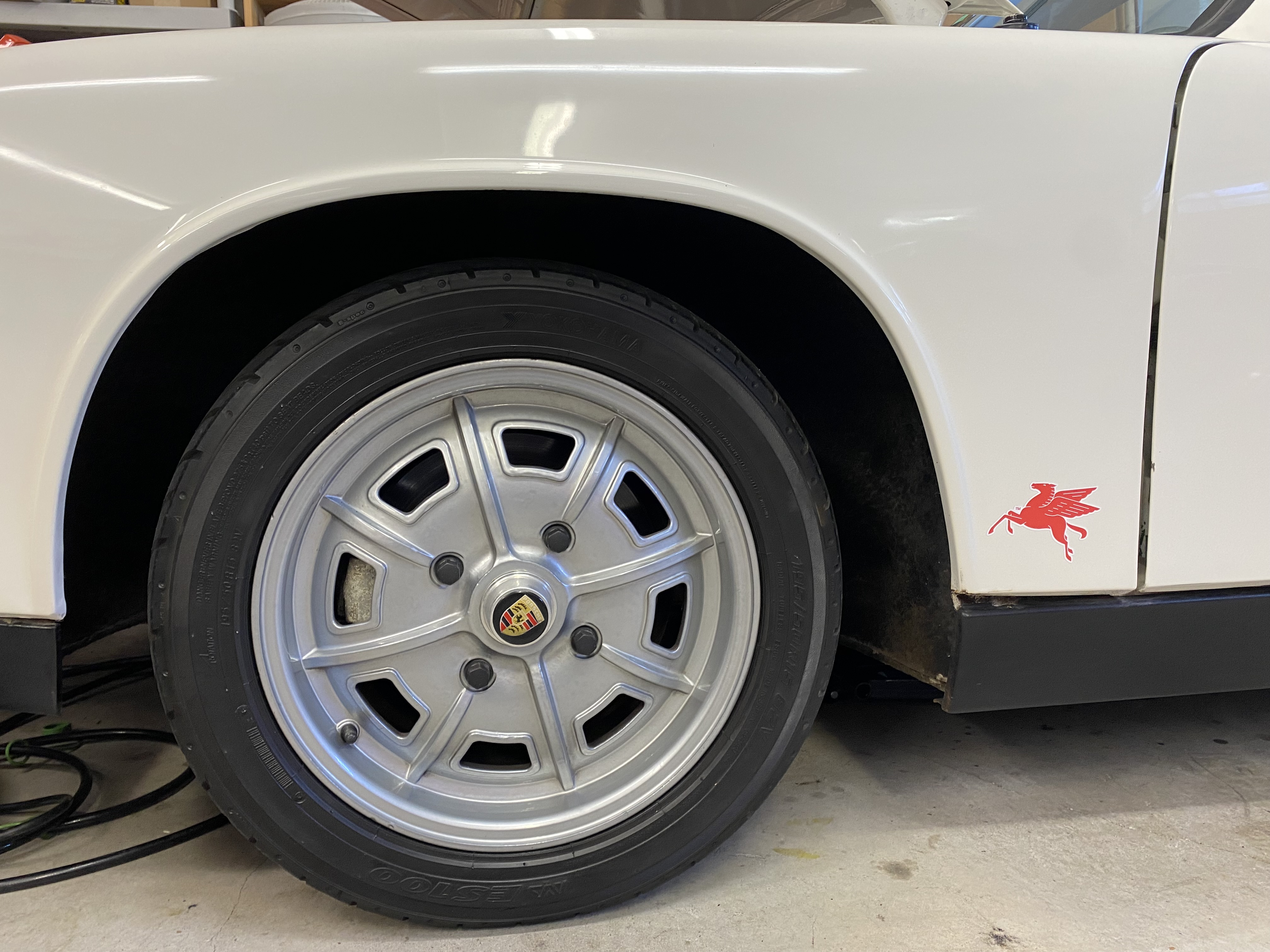

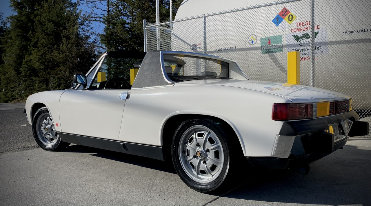

Had a great experience at America’s tire with mounting and balancing.
Wheels mounted, so far I’m super happy with the way they look with the 60 series. Cars little taller because I haven’t taken them out for a ride yet after putting it back on the ground . I think it will settle down an inch or so.
