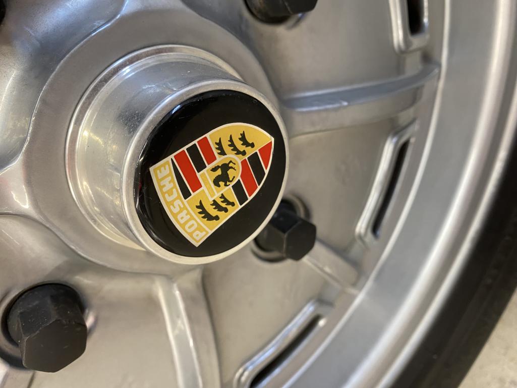

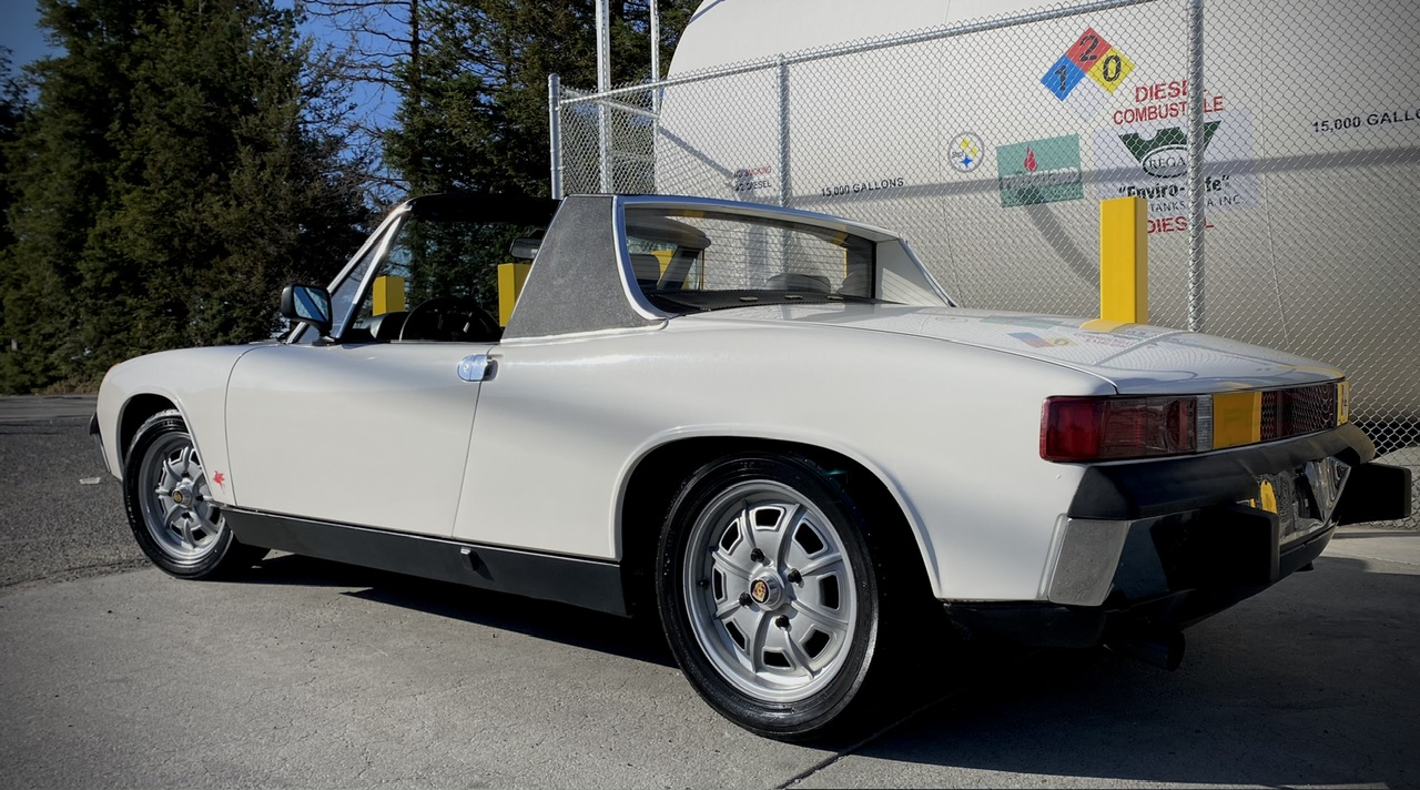

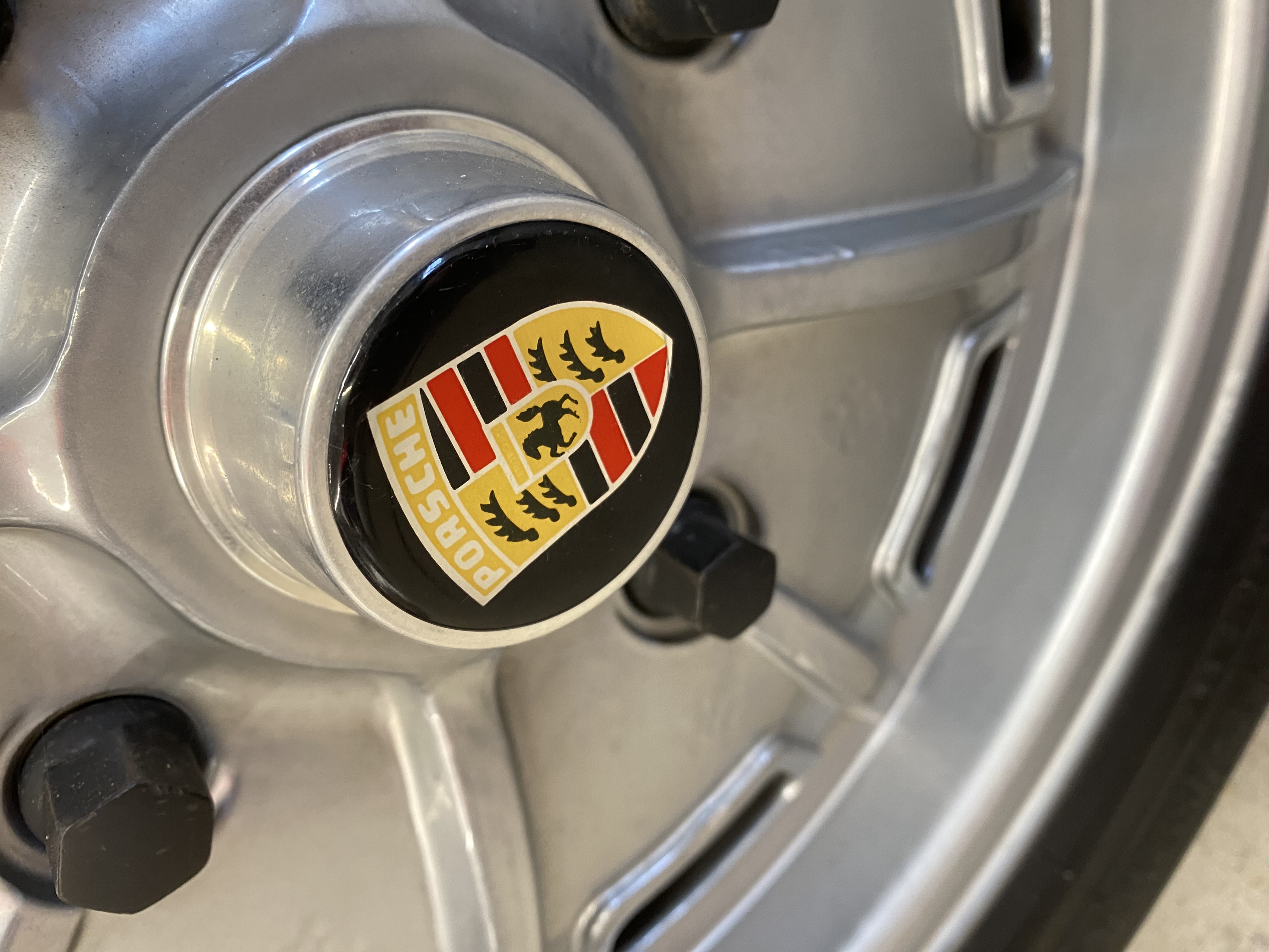

Michelin XZX 165SR15 IIRC from Coker Tire. Where can I get a set of those wheel caps?
(IMG:style_emoticons/default/wub.gif) (IMG:style_emoticons/default/wub.gif) (IMG:style_emoticons/default/wub.gif)

I believe those are stickers on stock caps. I have similar/same from https://3dcarstickers.com/search/?searchstring=porsche
I chose 44mm

@winform
@flavaproductions
Checking Flava’s link, it looks like those are the stickers. Great resource.
On the car they look 3d rubberized of some sort. Have some height. Do not have the look of a traditional sticker- look really good

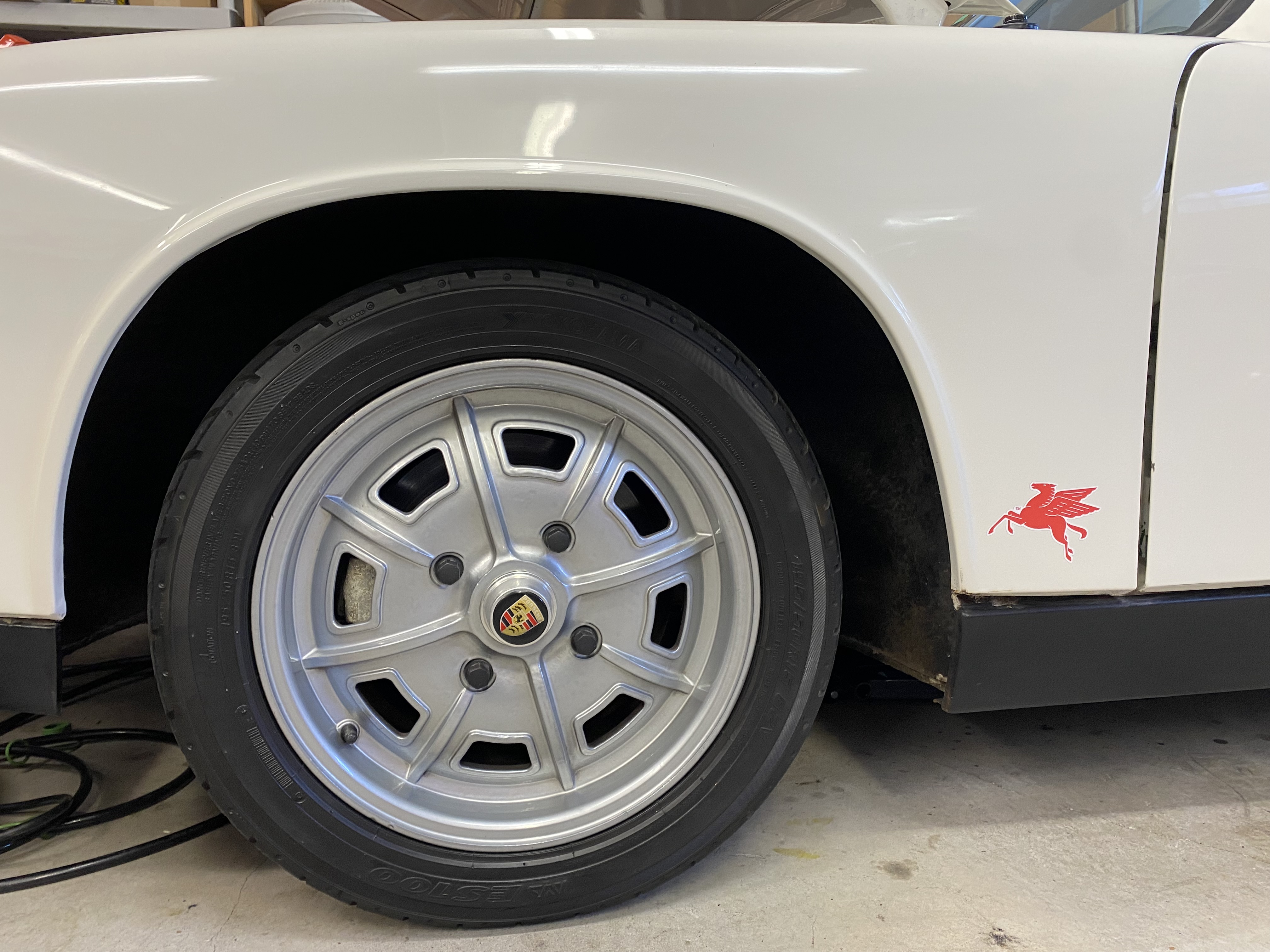

I'm with @infraredcalvin - i have 195/55's on mine - came that way and I like it. Had my speedo recalibrated by North Hollywood Speedo to read correct.
