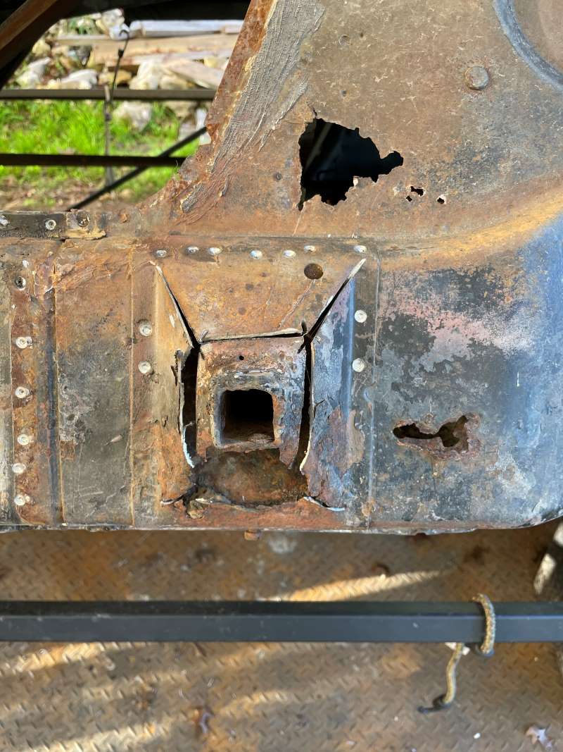

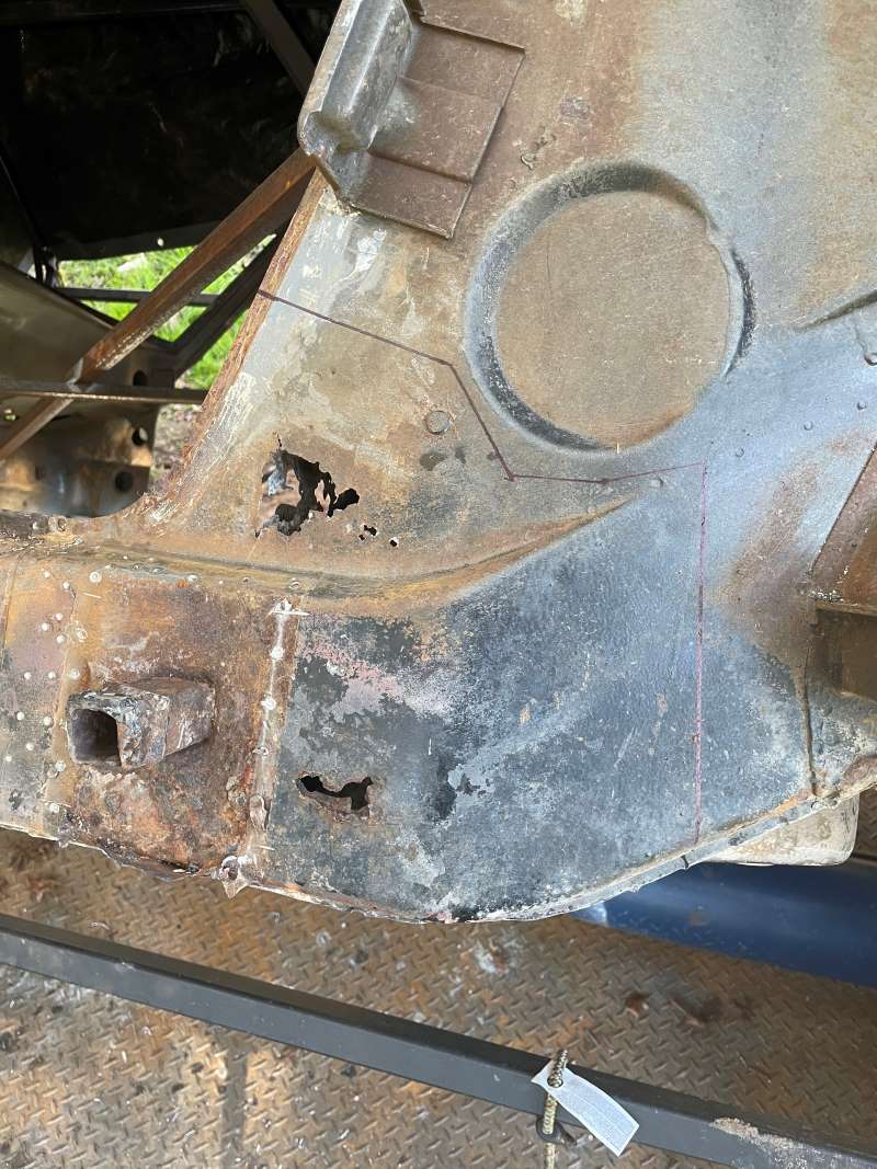

Drivers Side Longitudinal - Part 1 (12/30/2023): Here we go on the other side! Snapped some good photos on Saturday showing the disassembly and removal of the inner rocker panel and part of the rear inner fender. This is my 4th longitudinal repair and I'm starting to get a little more efficient. Since the rocker is in good shape and I will likely reuse the part, I will attempt to remove the rocker with the inner fender that includes the jack post and the area up to the outer suspension console.
I start by drilling out the spot welds. This is a very tedious process that works best with sharp drill bits and oil. I used a cap full of chain saw oil since it's what I had available. The following photos show the process of removing components, making strategic cuts to eventually free the metal and expose the longitudinal.
With the metal removed, you can now see the large mouse nest. Nice! With my PPE still on I removed it and started the process to remove the heater pipe, clips, and the back section of the front inner fender. Next, I drilled out the retainers for the two heater elbow pipes (a real PIA), which finally exposed the entire longitudinal. This one is by far the best one I've ever seen!
