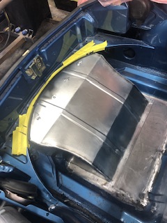

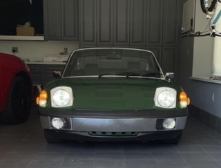

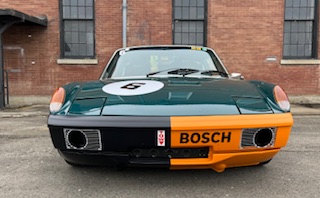

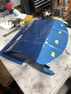

More oil cooler and beyond pics…I was kinda belligerent about not cutting up the front panel of the nose and using the factory holes as my air inlet. I also chose to go with a louvered vented floor panel (not what they usually do) and hard oil lines…maybe not the most efficient way to cool but I liked the look and cleanliness of this method. Thanks for putting up with me (PMB). First pic is of a car I really loved at Lüftgeküllt. If you look close you can see the stock nose holes in this car behind the bumper cutout. last pic is of our esteemed forum contributor (and my advisor) Michaels car, which inspired me to copy this look. Stock with a some teeth showing!
