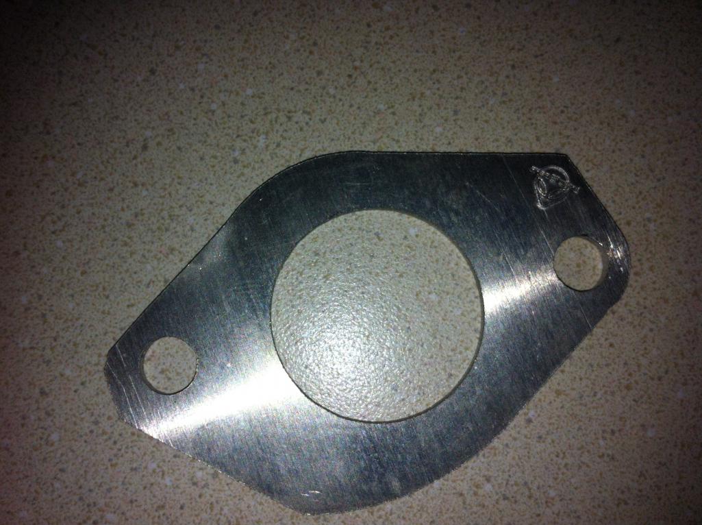

I suggest a vacuum gauge. You can balance the individual throttles at idle and suck air between the gasket and head with the wrong intakes when you crack the throttle.that will produce the same issue you are having. This covers the injector notch without restricting the port flow.
Interesting will check that.
