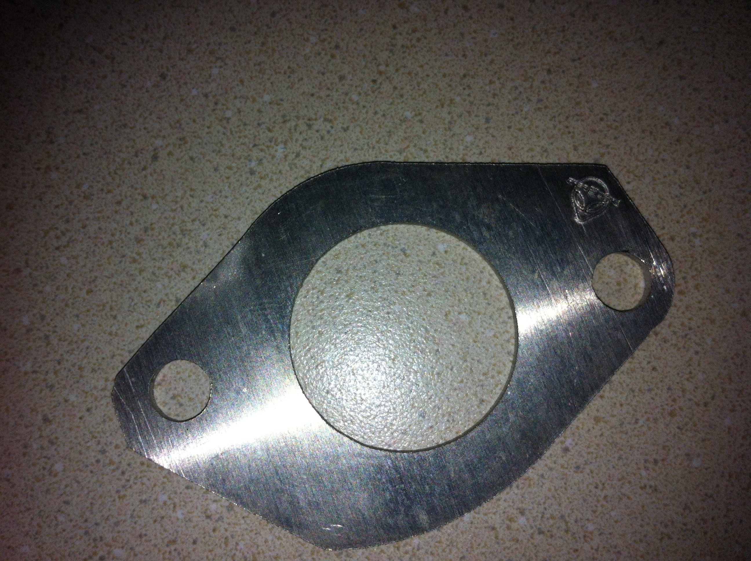

Question: does the 2.7 have the FI heads from a CIS? What intakes are you using for the carbs? Are they properly covering the notch in the head for the fuel injector? Could just have a vacuum leak at the intakes
I had some Alien adaptors made to allow the use of early intakes to work with FI heads. I will see if it came find a set and post a pic.
