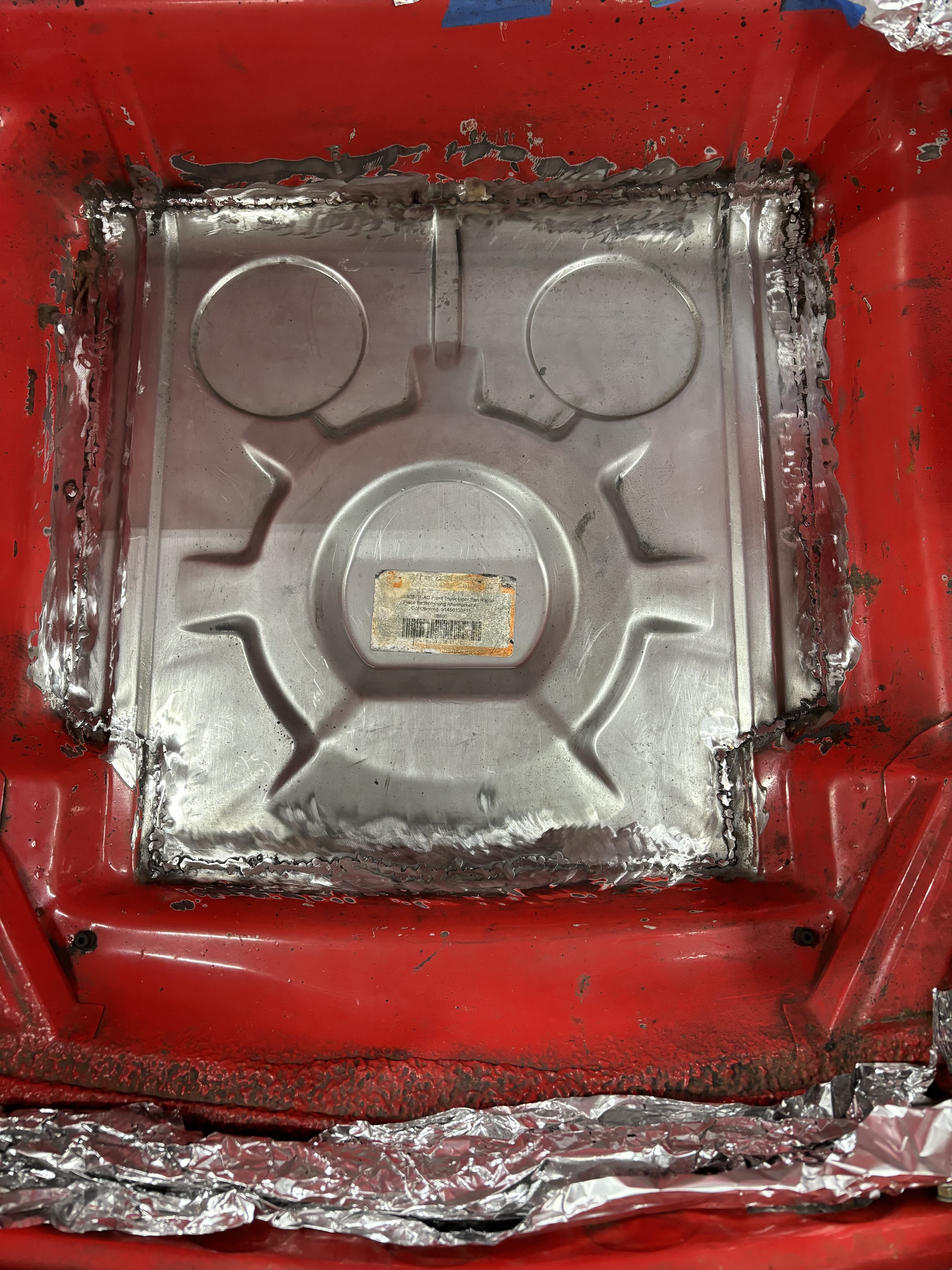

Deusexmachina77   I cut the panel to where I thought it would lay be...   Dec 18 2023, 04:56 PM
930cabman   I cut the panel to where I thought it would lay b...   Dec 19 2023, 07:22 AM
Superhawk996   :headbanger: pretty good fit for someone that was ...   Dec 18 2023, 10:43 PM
mb911   :headbanger: pretty good fit for someone that was...   Dec 19 2023, 06:29 AM
friethmiller   I remember the one problem I always had when I sta...   Dec 19 2023, 08:51 AM
Deusexmachina77   I appreciate the encouragement and the tip about t...   Dec 19 2023, 03:35 PM
r_towle   never in one area too long....heat warps things.   Dec 19 2023, 04:35 PM
gereed75   There u go - cut and butt at its finest. Nice work...   Dec 19 2023, 05:38 PM
Deusexmachina77   Hello Friends, @[url=http://www.914world.com/bbs2...   Jan 4 2024, 09:14 AM
friethmiller   Well, that depends what you want. If you want to ...   Jan 4 2024, 09:45 AM
Superhawk996   Agree - don’t thin metal by grinding too much ...   Jan 4 2024, 09:47 AM
friethmiller   Due to all the stamping formation complexity, it ...   Jan 4 2024, 10:21 AM
mb911   The proper way would be to use epoxy primer then s...   Jan 5 2024, 05:08 PM
