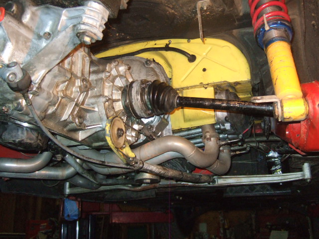

For my 2316 I put in 4 TC's because I could and to monitor for a cylinder going lean for whatever reason. This engine is fuel & spark controlled with SDS so I created the map by dyno tuning so wanted to be watchful for not going lean. Wideband O2 is there of course. Here's the install, you can pick out the TC's on the headers if you squint....

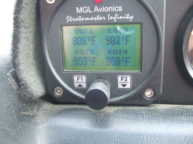

Here's the readout at idle.....
What I watched for was to not exceed 1250 at sustained WOT to avoid detonation risk but will commonly see 1350 at light throttle sustained around 3500rpm. Remember I'm on SDS and at light throttle I'm on closed loop so AFR's are around 14:1.
