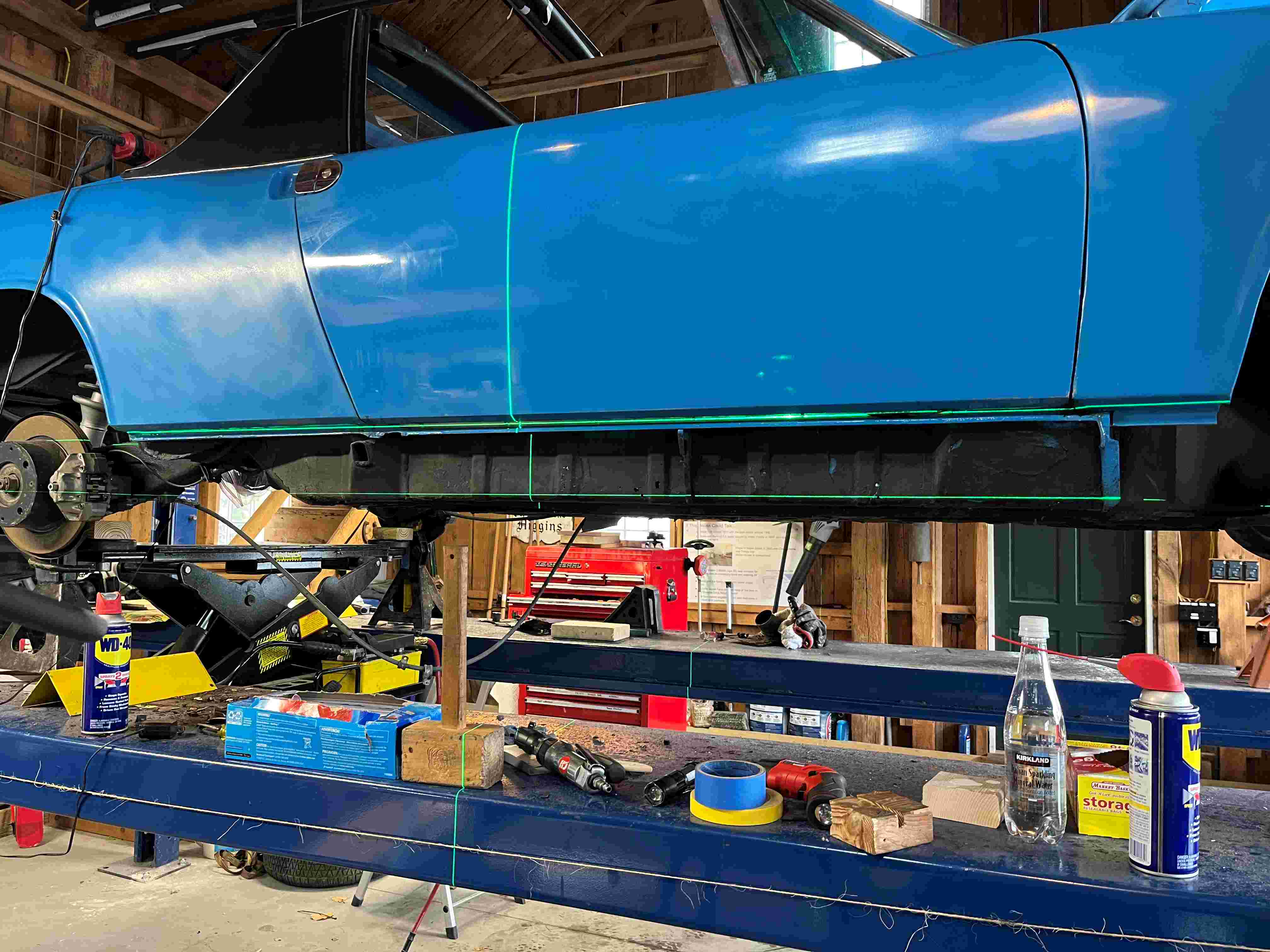

Got the car on jack stands and all leveled out using my buddy’s laser level in preparation for probing the passenger side long. There’s a number of areas along the long that have rust holes at or near the bottom.
Working on building and installing 2 door braces for the passenger side before doing anything to the longs.
I was encouraged that the body lines are pretty straight to start with.
