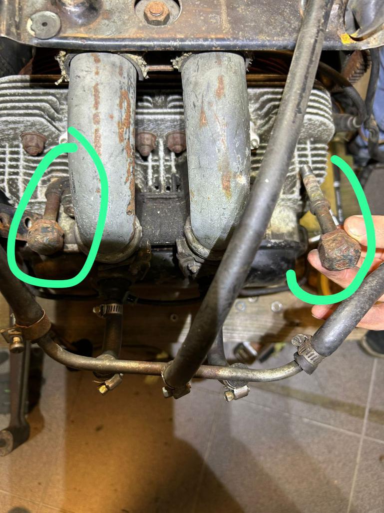

Thank you Jeff for your help... on another note, when starting to take of the metal parts on the engine I noticed some bolts going into the cylinderheads (see picture). I cannot find them in the Porsche parts catalog and I am unsure of their purpose. Anyone know? Are these merely to hang the engine whilst works are done? Or do they serve a purpose?

JeffBowlsby   Those are capped off air injectors, supplied by yo...   Jan 11 2024, 03:21 PM
